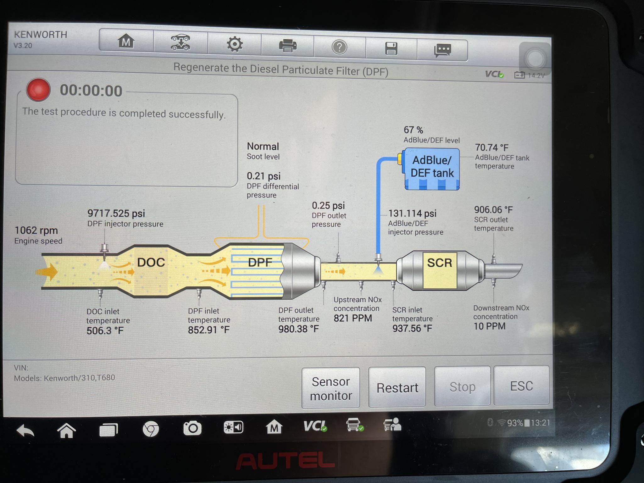

I have check engine light on kw t680 2016 mx13 paccar engine
no derate mode , drives fine
On my dash i have spn 5319, on Autel diagnostic i have P3800 regeneration completed but insufficient
After Forced regeneration on Autel computer , check engine light went off
After driving 300-400miles, self regen starts check engine light on again
I have diagnostic diagram readings after forced regen i done ( colored picture) , and have temperature readings after truck did self regen once driving on the road ( temperature table 4 pages) seem temperatures are to low once truck do his own regen
All help appreciated!!

I’d agree the temperatures look too low during regen. I’d begin by looking for any exhaust leaks then move on to the dpf/doc being plugged and needing serviced.

First, what's the odometer reading? Second, are you getting any white/grey smoke while driving during an active regen? Smell of unburnt fuel?
What's your oil consumption like?
If you've done a complete EGR tuneup as Rawze mentioned and detailed in many other posts on this site (and in some videos found above) and there are no exhaust leaks and the DPF injector is functioning properly and not clogged up with soot, then I'd start to focus on some combination of excessive oil (or coolant) in the exhaust stream and/or a clogged/failing DOC. There's also a stuck EGR valve that could contribute to this problem.
Parked/Forced regen works because of the controlled setting. Engine speed is constant, all variables and outside factors remain mostly static. Active regens however need to adapt to constantly changing conditions and any one item out of spec could screw up the entire system.
