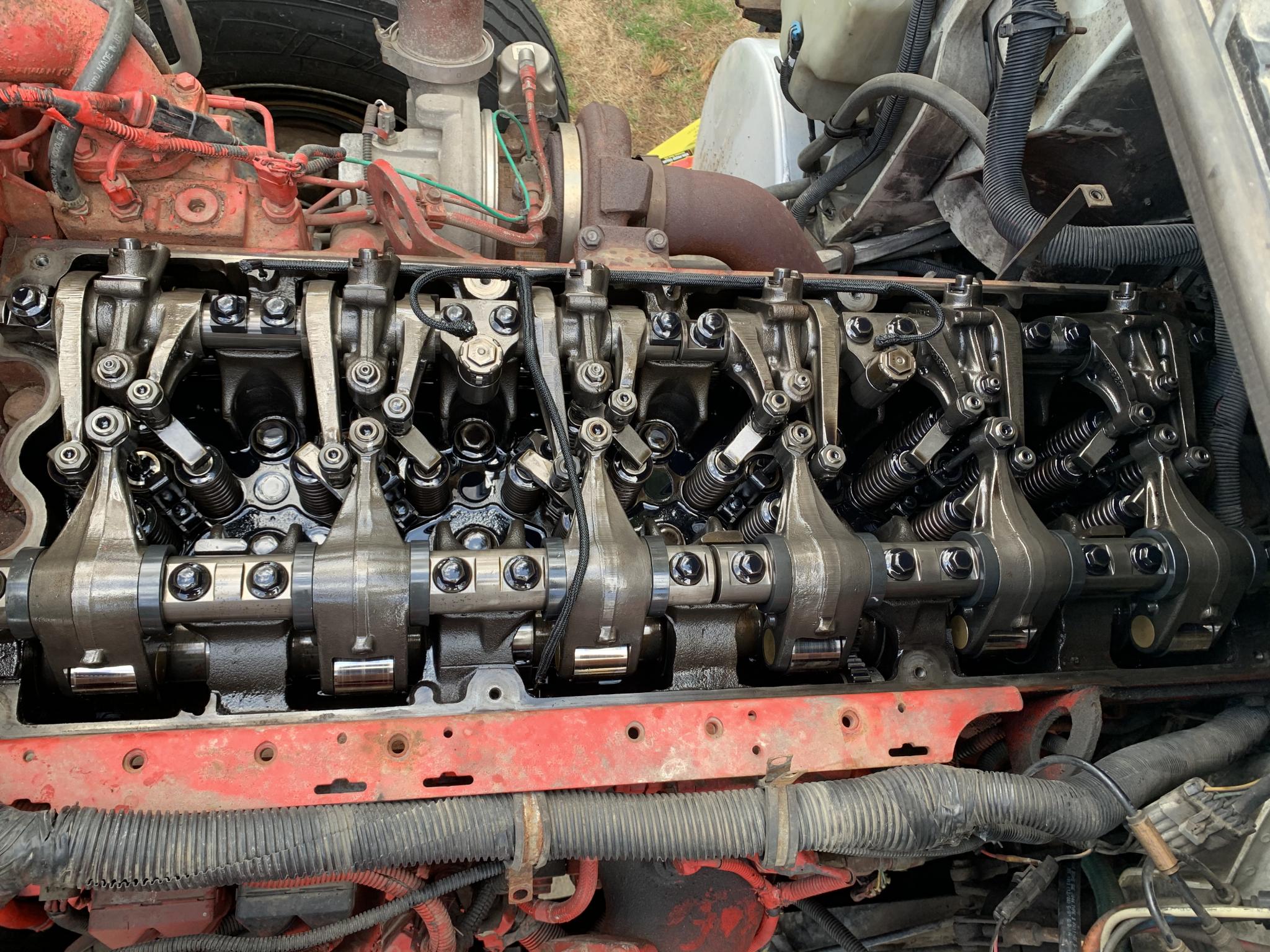

(05-22-2021 )Chamberpains Wrote:  Unilevers brought up that the very small oil galleries in the rocker shafts often clog with soot. While you have the top apart you may want to spray some brake clean and some shop air down in these galleries to ensure you getting proper oil flow to everything up there.
This picture was taken six weeks ago when I purchased the truck.
05-24-2021, (Subject: Jake brake long delay )
RE: Jake brake long delay
Wow, none of the sensors on that engine look like they've ever been touched!. -- Sad indeed.
