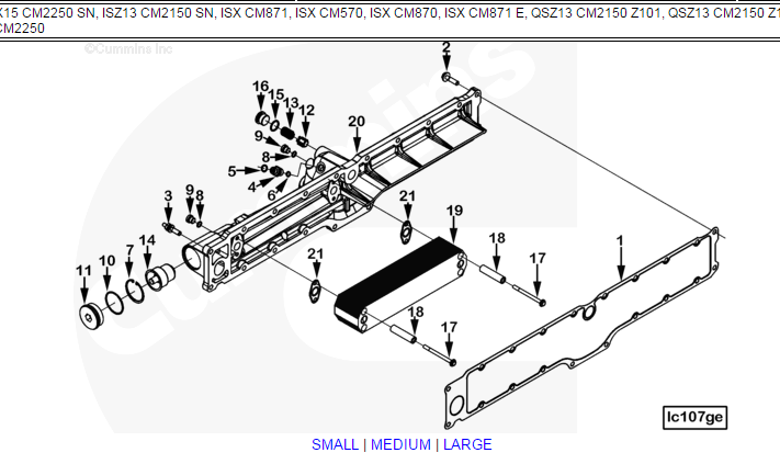

Oil Cooler
./uploads/201603/post_1372_1457442971_95daf36d63fc07fcfefa4221e4bf8068.png

Big HP motors have 2 elements in the oil cooler. Has anyone figured where to tap the pressure into? The feed for a pre-pump is easy-use the other drain plug. But where do you put the pressure? Also will it just flow backwards through the main oil pump?
03-22-2016, (Subject: Diesel Engine Pre-Oiler Pump )
Post: #21
RE: Diesel Engine Pre-Oiler Pump
(03-21-2016 )jorden486 Wrote:  Big HP motors have 2 elements in the oil cooler. Has anyone figured where to tap the pressure into? The feed for a pre-pump is easy-use the other drain plug. But where do you put the pressure? Also will it just flow backwards through the main oil pump?
Not all have 2 elements also one of the places for return line is just feed it to your oil fill tube,
