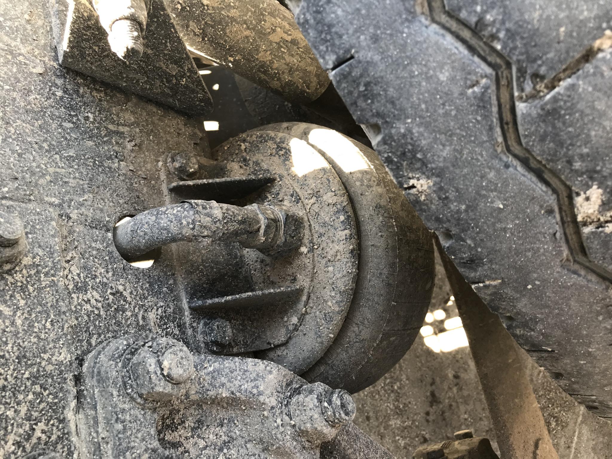

I have an airbag that developed a pin hole and it’s audible. I’ve already contacted a local dealership and found the part. My question is in regards to the bracket. Do I need to purchase another bracket or can the one I have be used?
This is on a 2009 KW T660.

Sorry, but the question wasn’t answered. If the other part comes with a bracket, it’s obvious to change/replace it. However, if the new does not come with a bracket, can the bracket there in place be used again? Or is it recommended to change the bracket with changing the airbag?

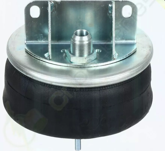

With the AG400 suspension the bracket is an integral part of the airbag.

Well if it didn't come with one I'd have no issues reusing the old one as it is just a locator plate to keep the top plate of the bag centered on the frame rail. It carries no weight, just keep the bag in place and keeps it from rolling off the frame.
