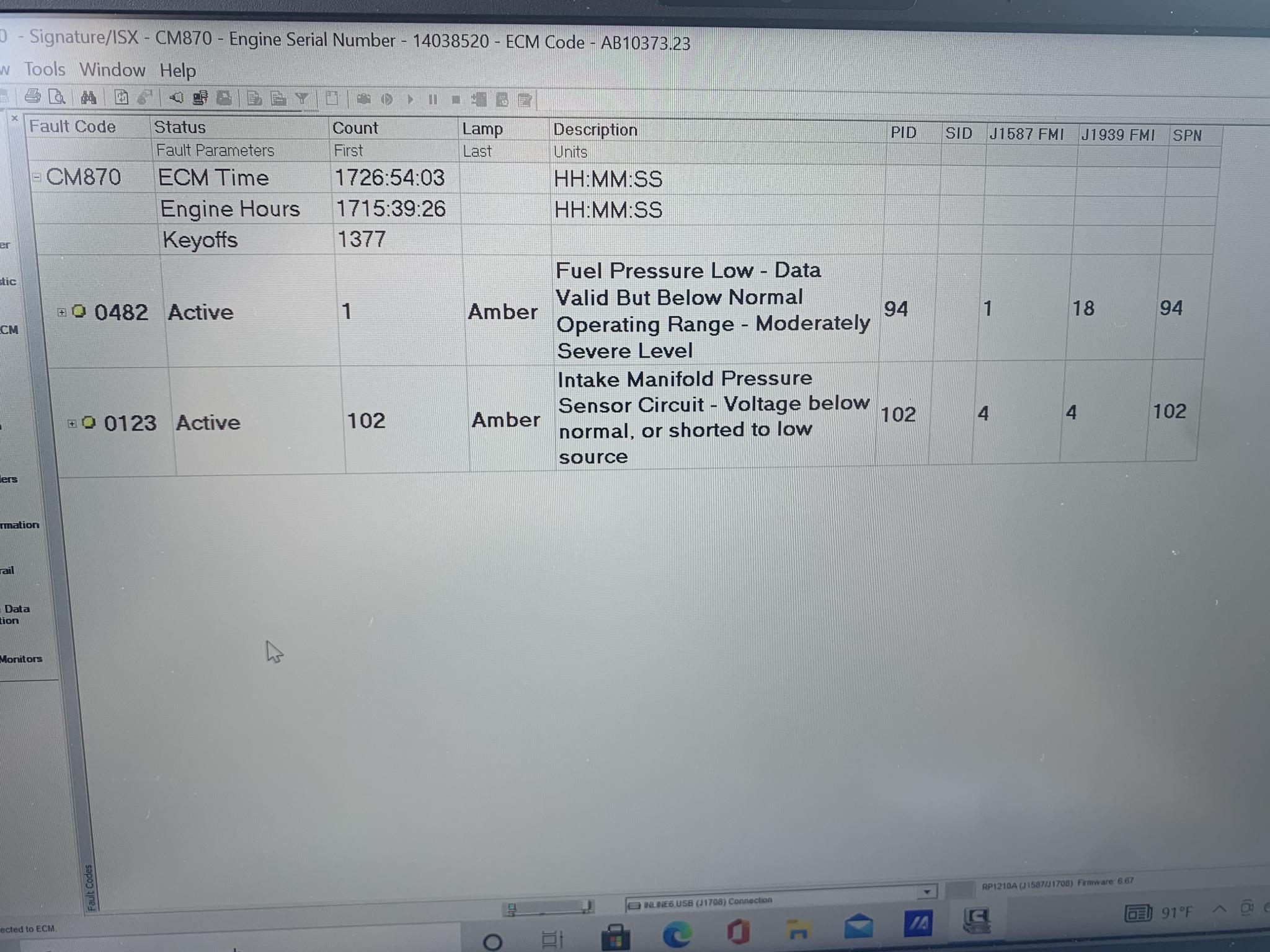

Here’s the fault that came up.The fuel one I was able to erase but once it went through wanting to shut down after starting up.

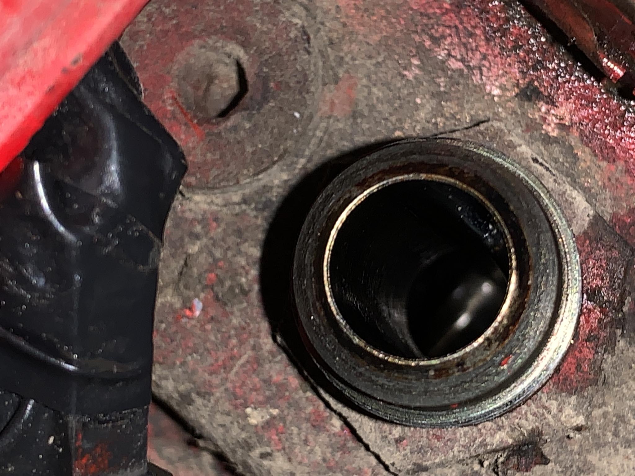

I missed the part where you asked about the screen.I’m going to go look at it now.Once I unhook that line will it dump a bunch of fuel?
06-15-2021, (Subject: Cm870 starts then shuts off,starts back up with a puff off white smoke and stays runn )
RE: Cm870 starts then shuts off,starts back up with a puff off white smoke and stays runn
There wasn’t a screen filter on the lift pump inlet.Also looked at rail pressure before cranking and it was 17psi and 270 while idling for 15 minutes and the lowest it dropped was 258.
