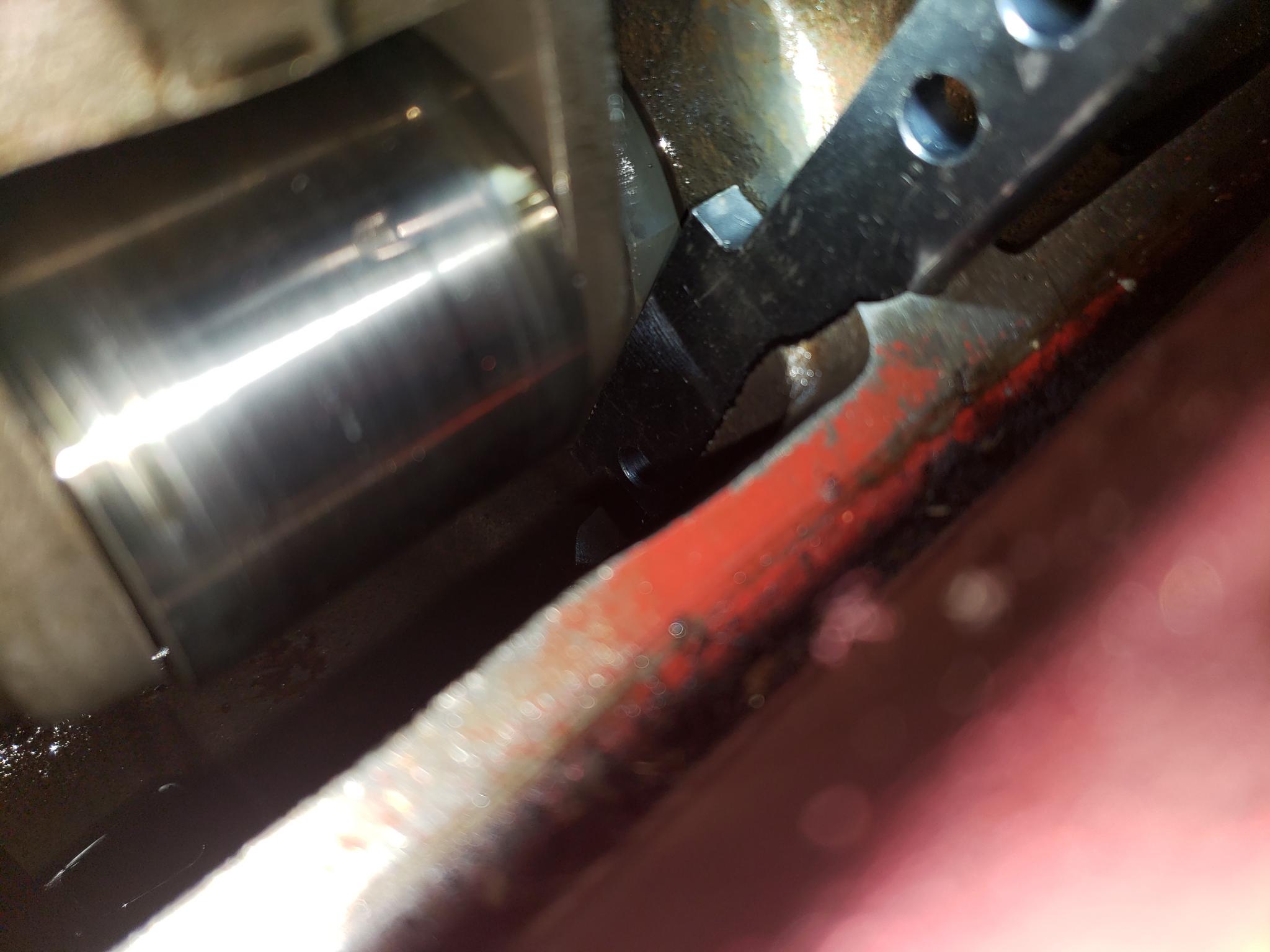

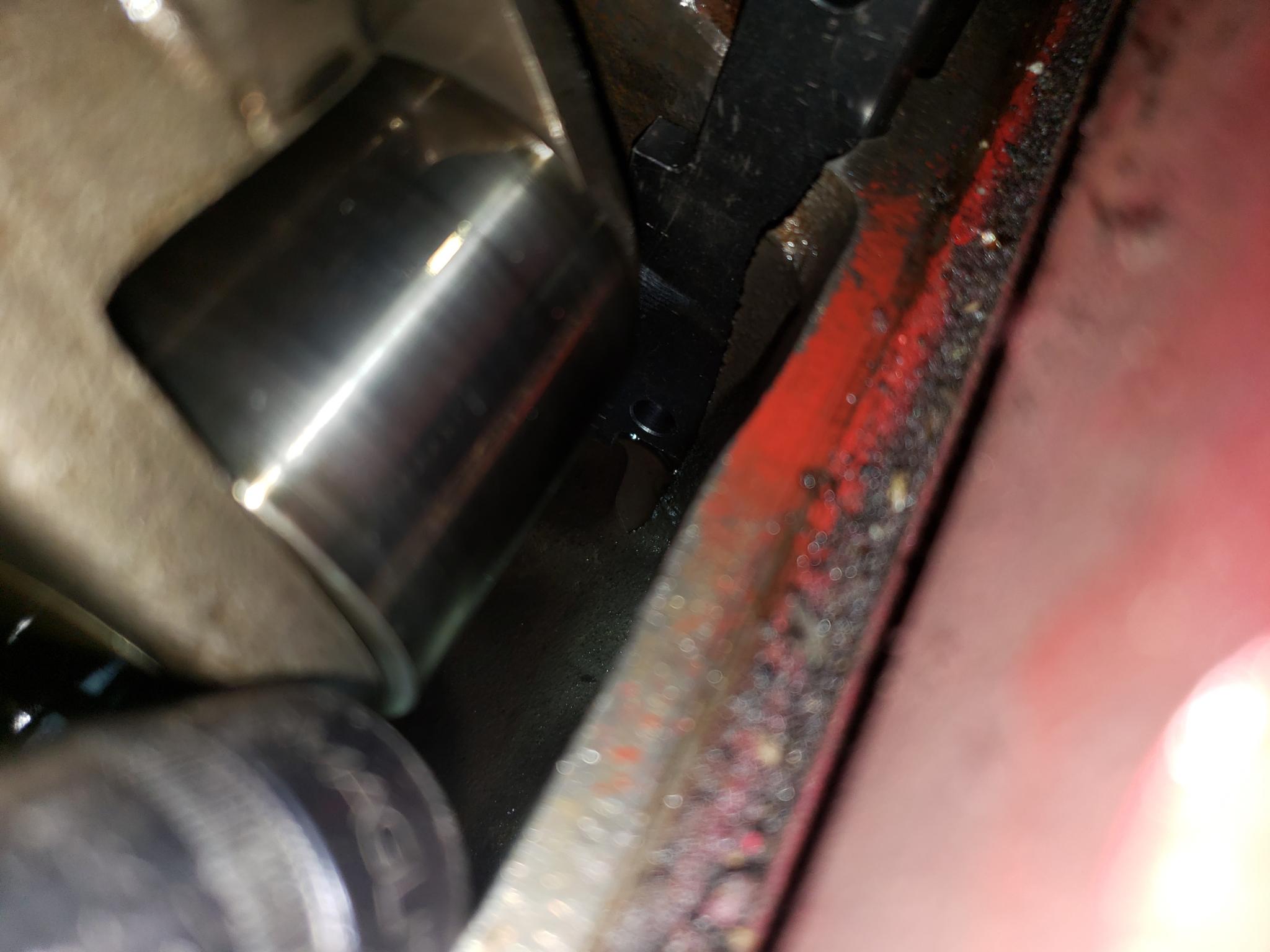

Well I rotated the crank 180° and the wedges fit in... are they supposed to go all the way down to the head?
06-30-2021, (Subject: New crank damper )
RE: New crank damper
Here are a few pictures
Pictures
