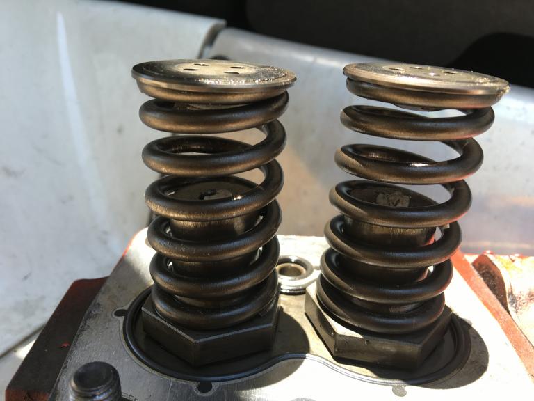

./uploads/201608/post_1749_1472080975_e7f62d75bfd75d7513778f25bdc87dca.jpeg
Mine was 2 cyl with ceramic plungers

sbtrucking Wrote:Mine was 2 cyl with ceramic plungers
Thanks SB, without dismantling to physically inspect the plungers is there any way to know or find out so I can help him prevent the catastrophic failure?
Not sure if there is a way to know, you can just install the plungers instead of replacing the whole pump, and I think there was also a recall from cummins dont know if they still offer it,
He shoukd get it updated asap, we tested my pump few weeks before failing it was very quiet at high pressures so we decided not to mess with it
