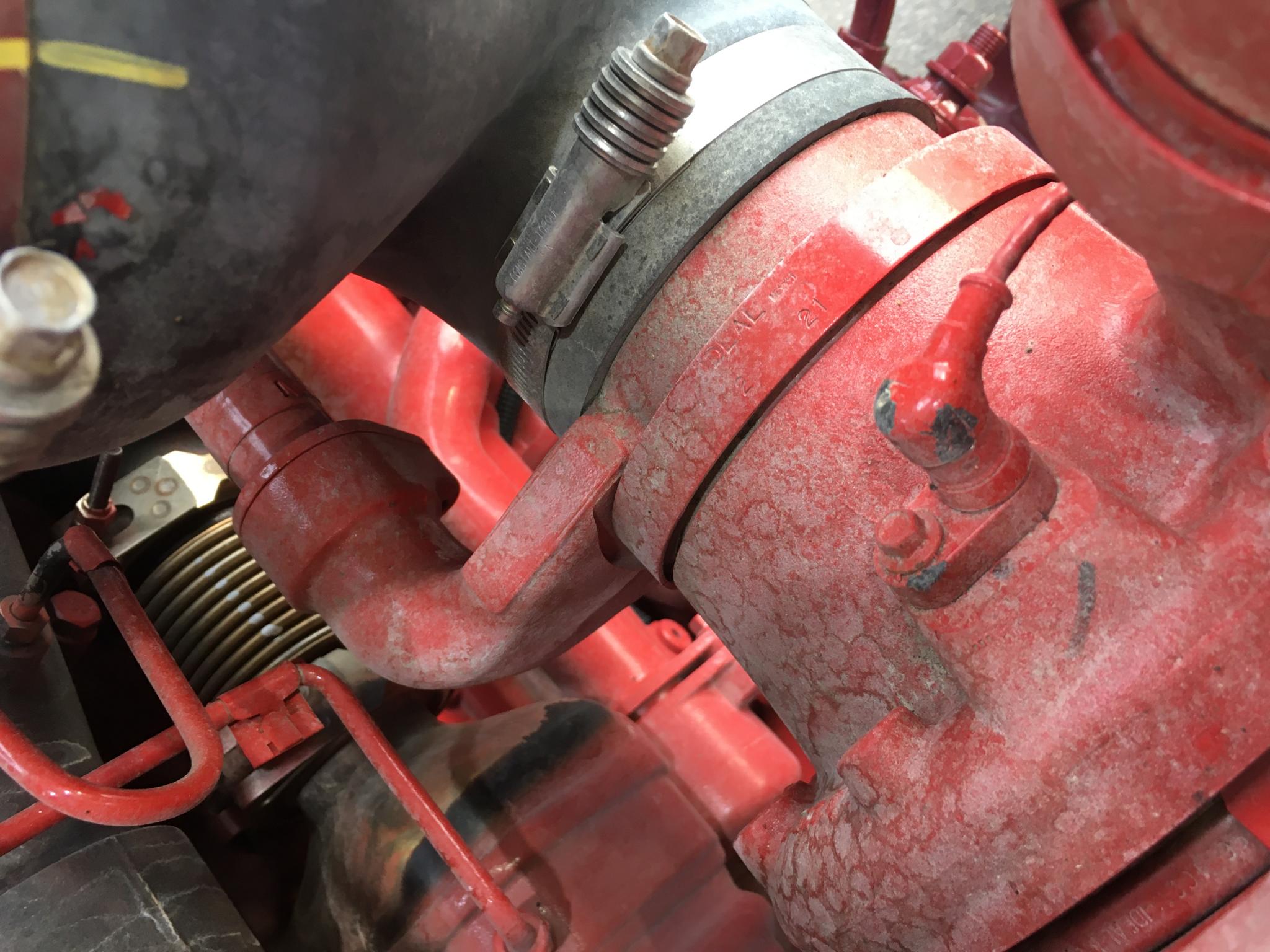

This setup is on my Peterbilt. If you can get the parts it draws from just ahead of the turbine.
08-14-2021, (Subject: X15 air compressor Intake relocation. )
RE: X15 air compressor Intake relocation.
(08-14-2021 )schISM Wrote:  This setup is on my Peterbilt. If you can get the parts it draws from just ahead of the turbine.
like 'marek4792' mentioned .. I think that is a terrible place to put that.
