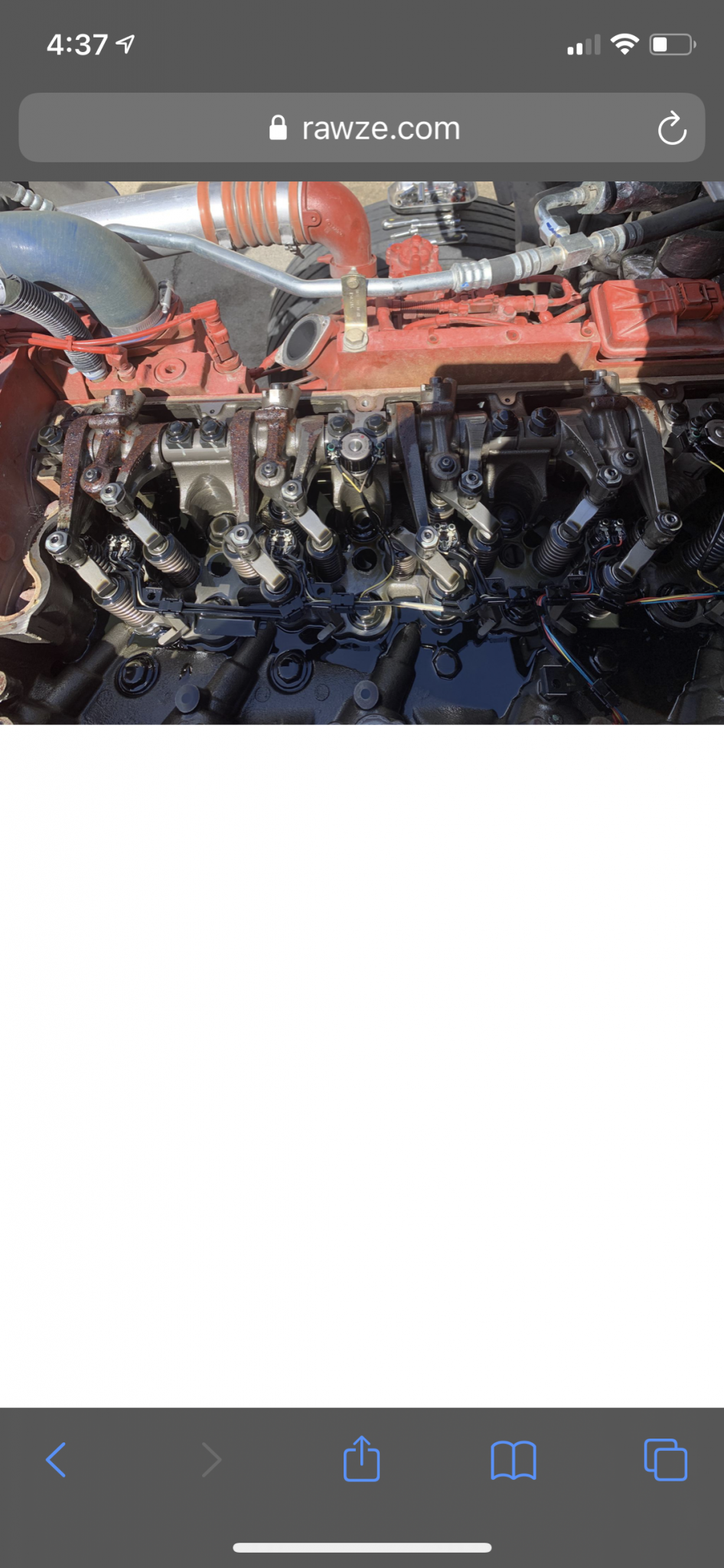

RE: Cm2350 Turbo Help please (08-12-2021 )Nilao Wrote: I have 1.44 million miles on mine and I have never had a rust issue on my rocker arms. 12 years and still running the factory cams/rockers. I suppose this is the rust the tech was talking about | |||
08-18-2021, (Subject: Cm2350 Turbo Help please ) Post: #31 | |||
RE: Cm2350 Turbo Help please I think I remember that picture from a while back. That truck sat somewhere for quite a while and wasn't started. That's called "lot rot". If I remember right that was an RV type truck, wasn't used often. User's Signature: im_seeing_parameters_in_my_sleep 1 | |||
08-18-2021, (Subject: Cm2350 Turbo Help please ) Post: #32 | |||
RE: Cm2350 Turbo Help please A gallon of decent brand of gear lube at each oil change would help to prevent that. Also starting it and letting it get up to operating temp every 2 weeks or so to prevent the moisture buildup. User's Signature: ->: What I post is just my own thoughts and Opinions! --- I AM Full Of S__T!. | |||
