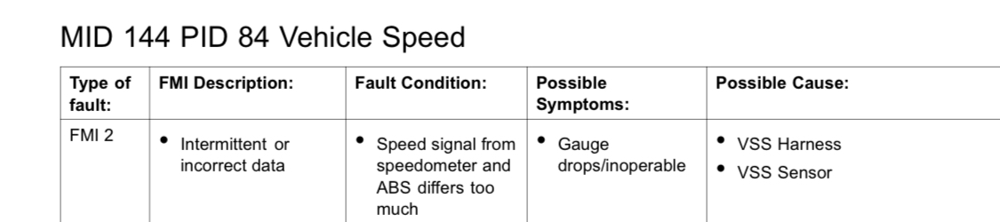

I was driving the truck with a empty trailer and had a harsh stutter/jerk and was driving about 60mph and my speedometer went down to zero and it felt like I lost power temporarily for a couple seconds and then the truck picked up speed fine along with the speedometer going up to my actual speed
I do have a code reader and I got a abnormal rate code for my turbo actuator along with a couple abs codes that I figure went off due the stuttering of the truck

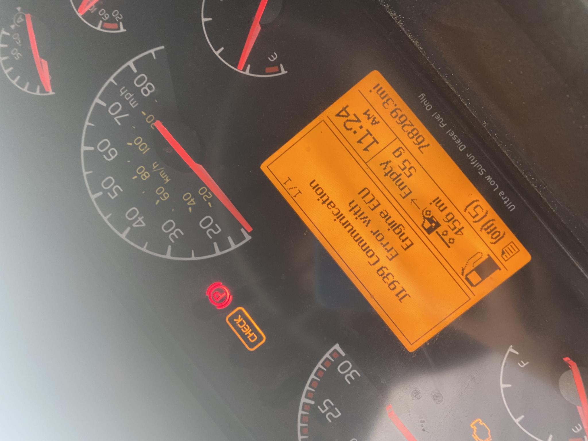

I did have the maintenance ecu message and j1939 communicate with ecu message pop up a couple times while I was driving back

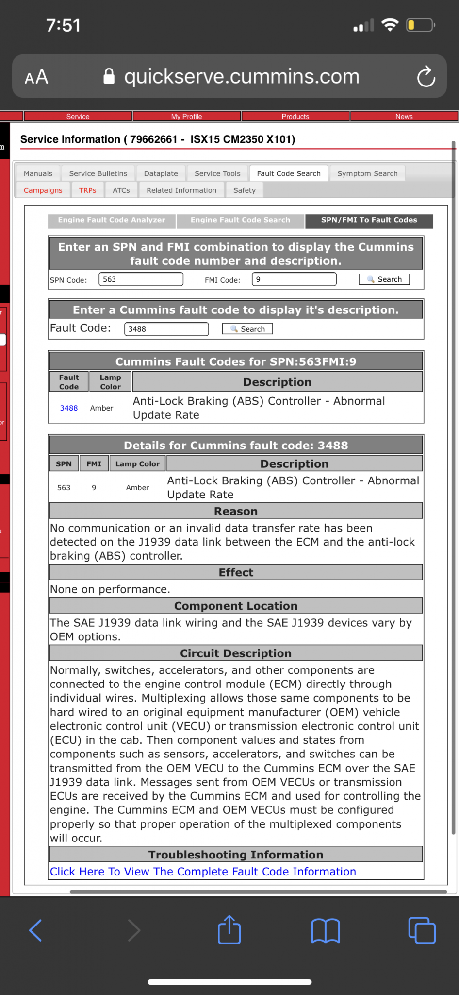

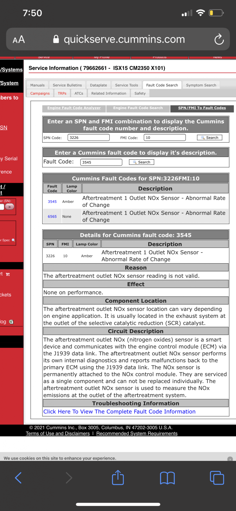

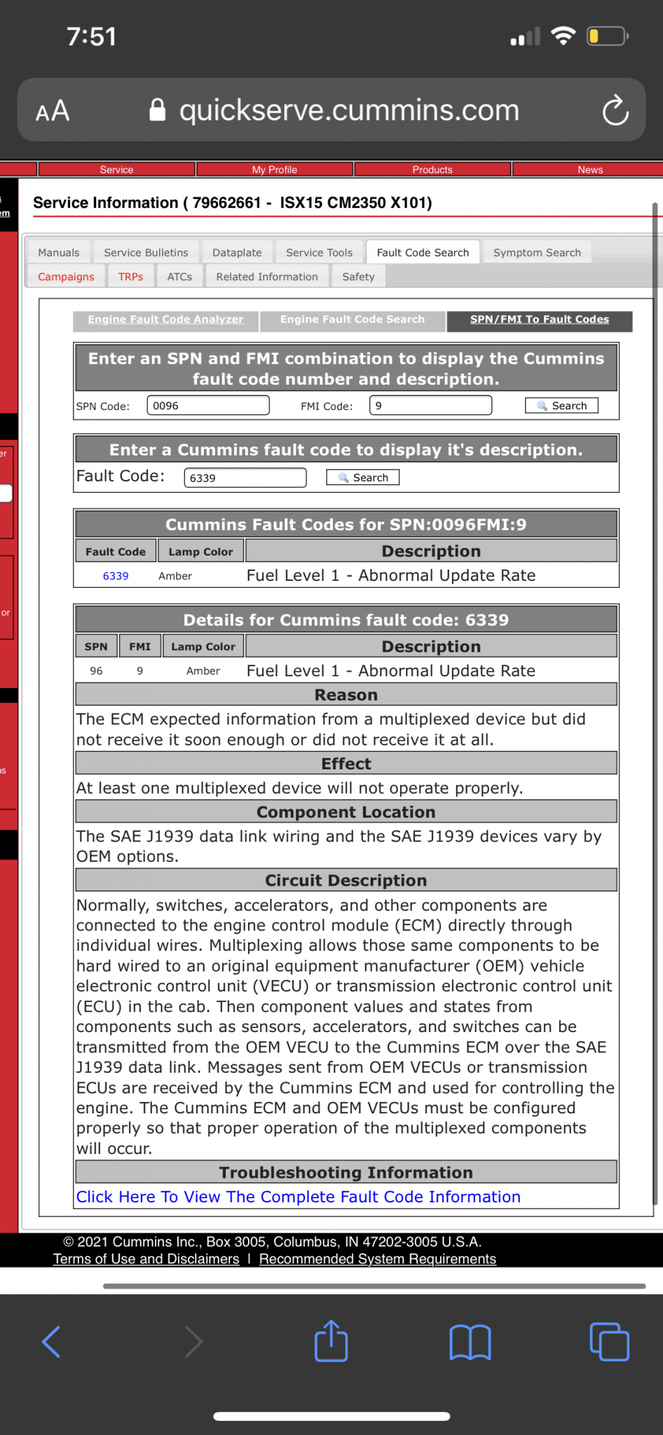

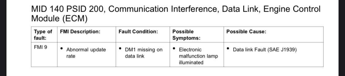

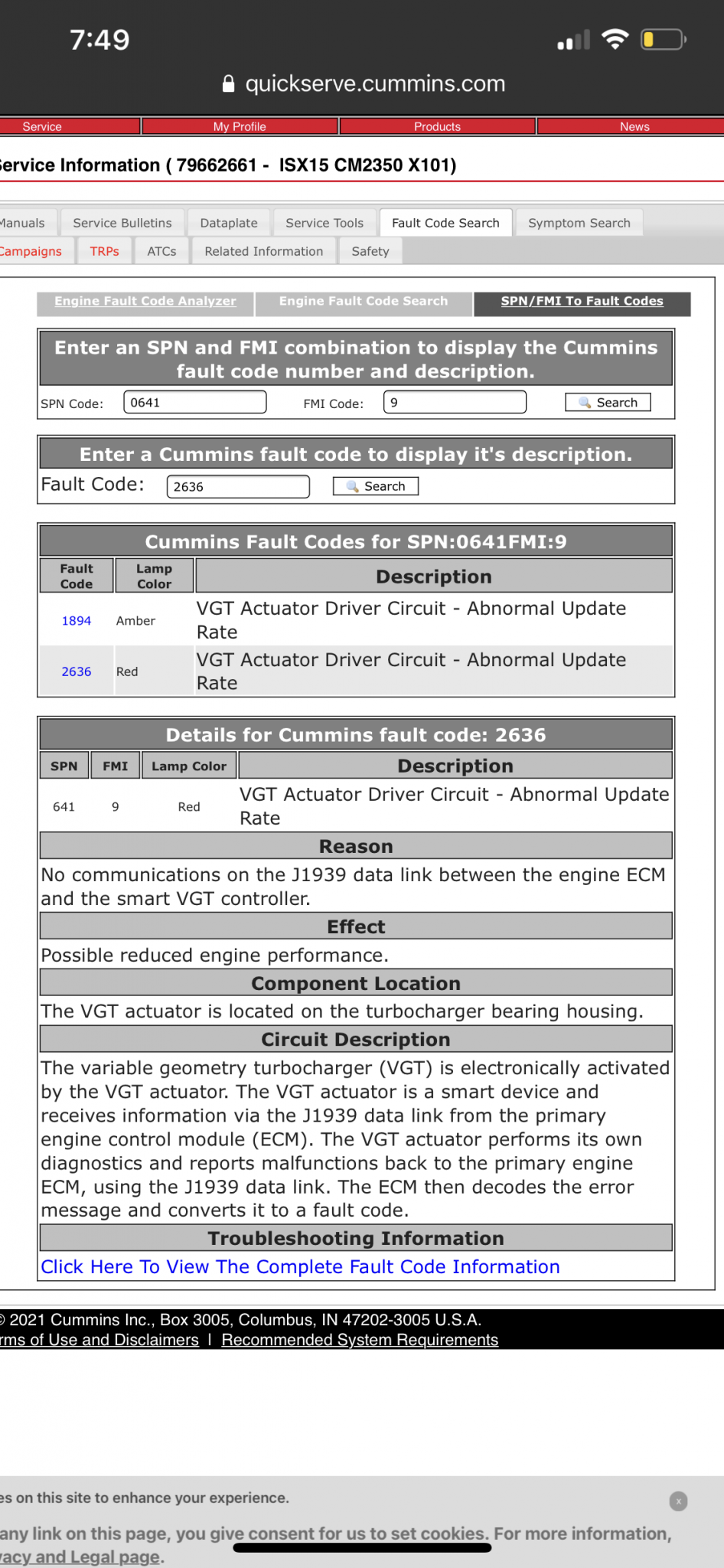

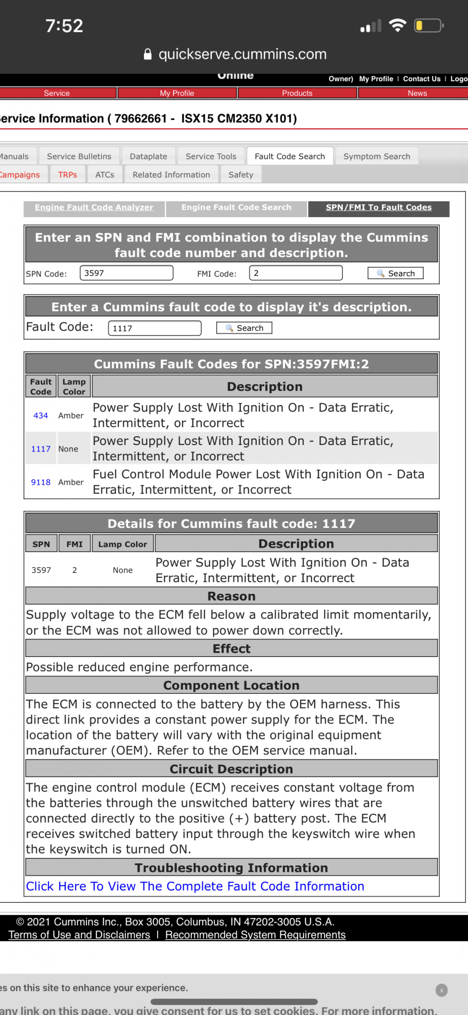

I decided to hook up to the j1939 and got the following codes
I transferred the codes into quickserve to get more information

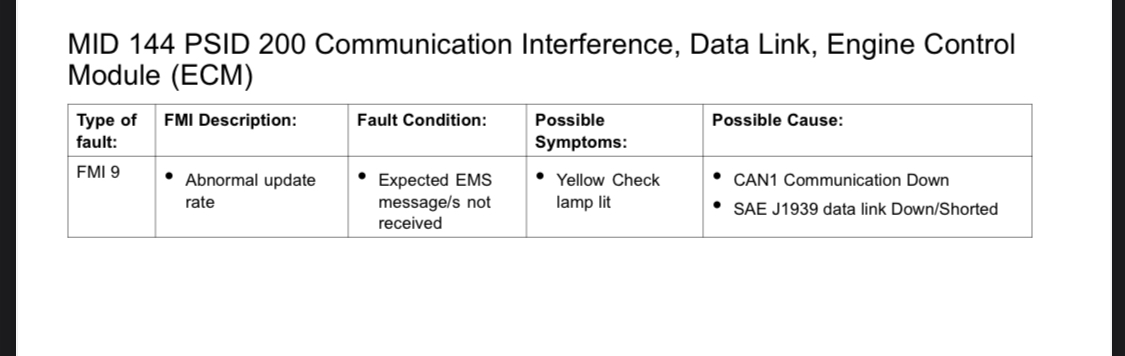

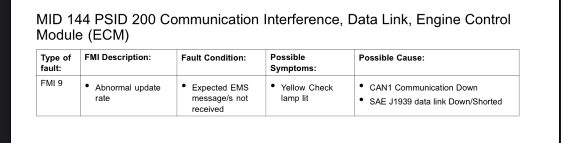

Most of the codes are claiming abnormal update rate

Rest of the codes/messages
Image(s)
./uploads/202109/post_5703_1632232644_bde5c7517d2b421d82d8f34762e78e7c.jpeg./uploads/202109/post_5703_1632232656_c5c6089462b41f2f903d486006c32f03.jpeg./uploads/202109/post_5703_1632232680_9cf93d2f57a92bb899001e8d413f3663.jpeg./uploads/202109/post_5703_1632232698_8b6a247f444501cd92d6e6001b077b18.jpeg

You need to measure the resistance on can bus #2 to ensure it still reads 60-ohms with the truck shut off. - A lot of times, when people remove that stuffs, they unplug harnesses and it also removed the terminating resistor on can bus #2 inadvertently.. and later on, there are turbo and other issues with the engine.
