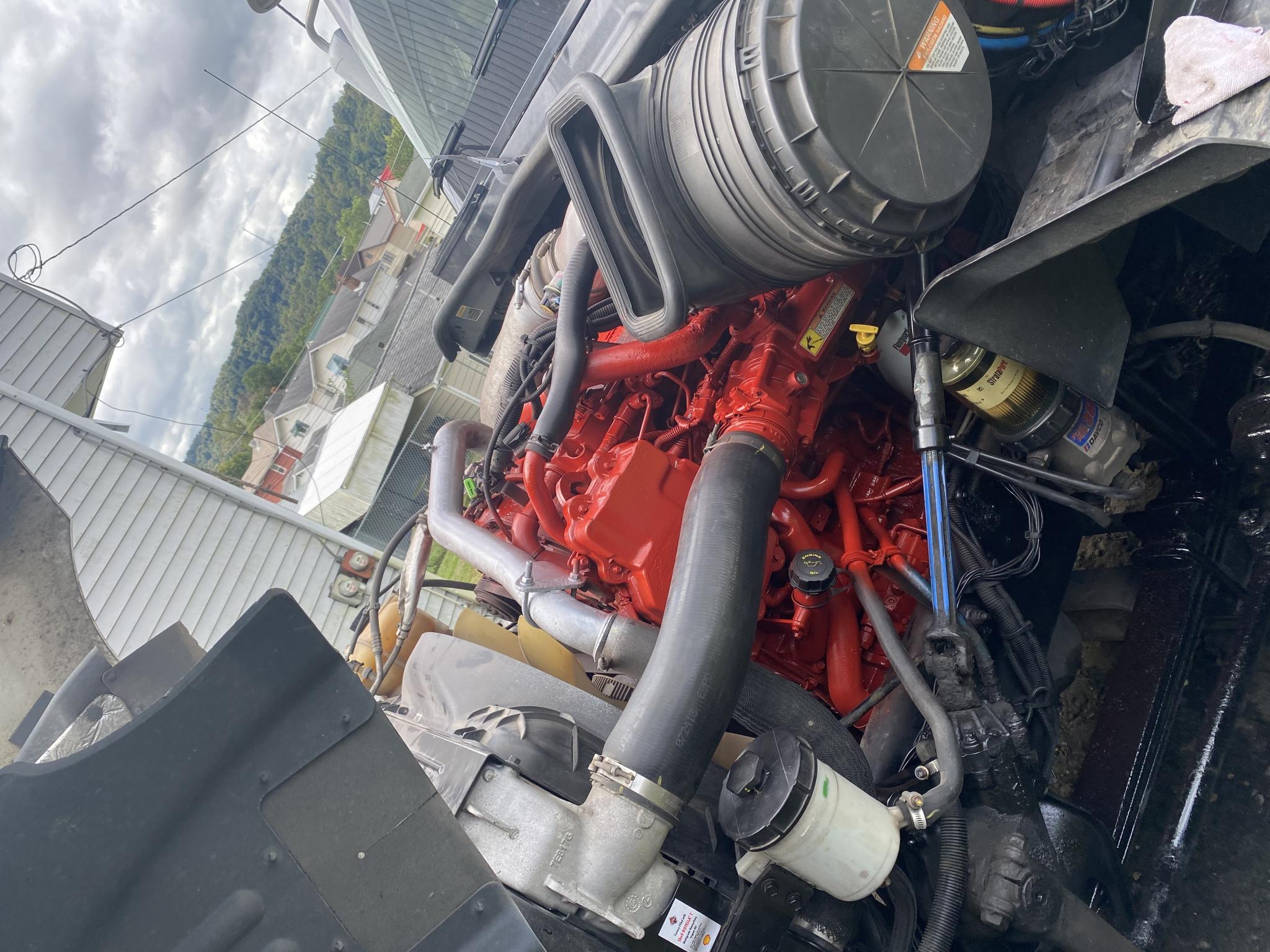

I found that Krylon Colormaxx: Gloss Banner Red is an exact match for my ISX15 if it’s not exactly a match I sure can’t tell. You can find it at Lowe’s, or Paint stores and Craft store if there’s anyone like me who had a tough time finding a match

Okay thank you I’ll check it out, I’m not sure if this paint is good for heat but it’s done well so far, I’m trying to get prepared for the winter so this is my last month to get stuff done until I get a garage but anyways hope things are well down there and God bless!

Well I’m actually thankful for the tips from you guys I live in the rusty northeast and I’m always sanding priming and painting my truck and trailer. Until recently I left the engine alone but as I do more work I screw up more paint and it’s making it tough to spot leaks and causing more rust my metal base coolant lines are in terrible shape I can’t even find the replacements for some lines I’ve used regular copper pipe and made stuff work but I’m learning keeping it painted and cleaned under the hood is very beneficial
