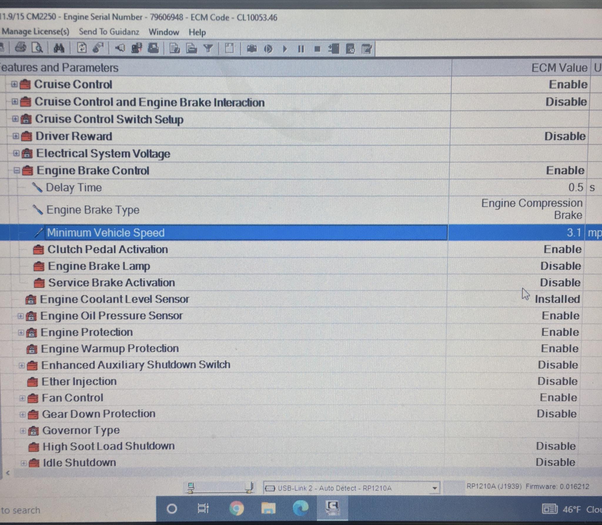

(10-22-2021 )schISM Wrote:  I had the exact same issue with a 22’ Peterbilt I purchased earlier this year. It was as if the VGT stage of the engine brake was active at all times except during actual engine braking. It would do this until the oil temperature reached 210f. Shifting around town was just ridiculous and you’d have to precisely meter the throttle if you hoped to get a smooth shift. I started at the dealer level with no luck and escalated the matter to a factory Cummins shop by way of Cummins Care. No luck at all. In the end I sold it and picked up a 2250. I’m enjoying the drive again.
This is exactly it… explained perfectly, I Spoke with a service writer at a Rush truck centers out In Oklahoma and he did say they’ve dealt with this issue before and it was able to be changed in the ECM, I’m hoping I can make some progress today. It literally makes driving a nightmare. Also mine does not seem to be effected by oil temp

(10-22-2021 )WICT800 Wrote:  This is exactly it… explained perfectly, I Spoke with a service writer at a Rush truck centers out In Oklahoma and he did say they’ve dealt with this issue before and it was able to be changed in the ECM, I’m hoping I can make some progress today. It literally makes driving a nightmare. Also mine does not seem to be effected by oil temp
Well I wish ya the best of luck but my experience with factory trained techs was pretty dismal. I expected them to break out C@lterm and email engineering the file to be fixed or at least have an update addressing the issue. I had to help the guy navigate “features and parameters” in Insite so he could make sure the engine brake wasn’t “latched” and there was a delay before activating it.

(10-22-2021 )schISM Wrote:  Well I wish ya the best of luck but my experience with factory trained techs was pretty dismal. I expected them to break out C@lterm and email engineering the file to be fixed or at least have an update addressing the issue. I had to help the guy navigate “features and parameters” in Insite so he could make sure the engine brake wasn’t “latched” and there was a delay before activating it.
Thank you, I am sitting in the parking lot as we speaking, they should be out shortly with the computer, what are some key features I should look for on Insight ?

(10-22-2021 )WICT800 Wrote:  Thank you, I am sitting in the parking lot as we speaking, they should be out shortly with the computer, what are some key features I should look for on Insight ?
The pic shows where ya need to be. The only thing they checked was that it didn’t activate when you used the service brake and then changed clutch pedal activation which I’m quite sure they were guessing at as that move had to be double checked with a higher up and a promise that if that didn’t work just bring it back.

Must be a setting in the ecm image parameters and not the actual program then ?? Those don't change if you just flash in an updated program right? That would explain why multiple reflashing hasn't changed anything.
