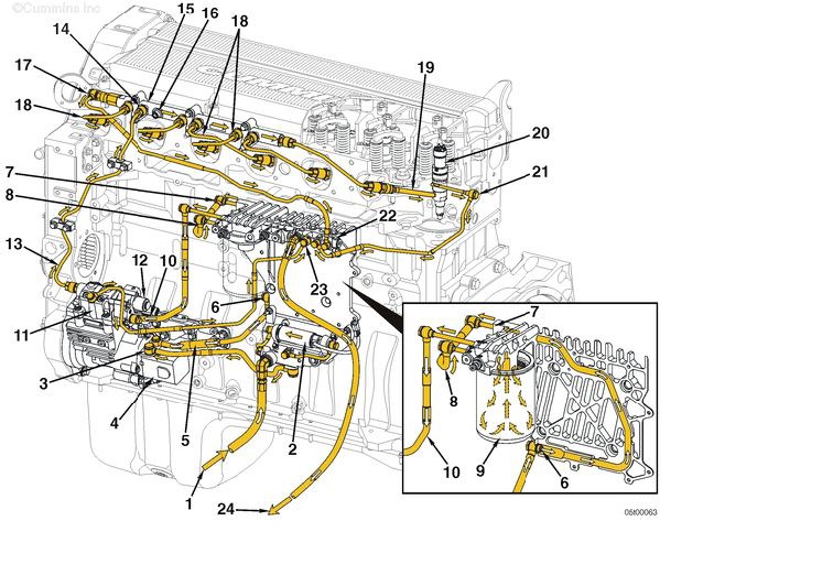

Yesterday, I was coming down the side of Monarch Mt and blew the (Fuel pump gear pump outlet) line. I replaced with a 35psi hose from Napa to get me down the road and when I started it, it was blowing white smoke smelling like unburnt fuel. I made it 20 mi and blew it again.
I replaced it with another hose, cause I was smart enough to get enough to make 2, and made it back to Napa and had them make me a 3500psi hydraulic hose to get me back home.
The hose is holding up, but here is the issue...
At idle, I'm commanding roughly 9400psi and it measures 36000.
Running down the road, having the cruise set, it will either not come above 14000, or sit at 36000.
To add to this, when on the pedal, the measured pressure will match the command pressure, 90% of the time, as long as the engine has a load on it.
And when you give it the beans and command 36k, it'll give it 36k, unless it's on its 14k kick as said above.
I did change filters to see if that was the issue, and it didn't make a difference.
Obviously getting high rail pressure code out of the whole ordeal as to be expected.
And the first diagram on this page, or the attachment below, I blew (#5), but on my engine it is plugged in to the (#8) spot on the side of the filter housing

Run the leakdown test on it with insite and fix the leaks and start from there.

YOU ALSO NEED TO sign up on quickserv.com.. its totally free, and you will have the PROPER diagrams and everything else instead of some out-of-date stuff that you posted the links to.

90% of the time when I have higher fuel pressure like that its the fuel pressure regulator in the back of fuel pump. Most of the time you will here like a serging sound where relief valve is doing its job and relieving fuel pressure from high pressure rail. THus causing alot of return fuel maybe why you blew the rubber line. Id start there first. ALso note the plug for it is not at the regulator but about 6 inches away on the block...
