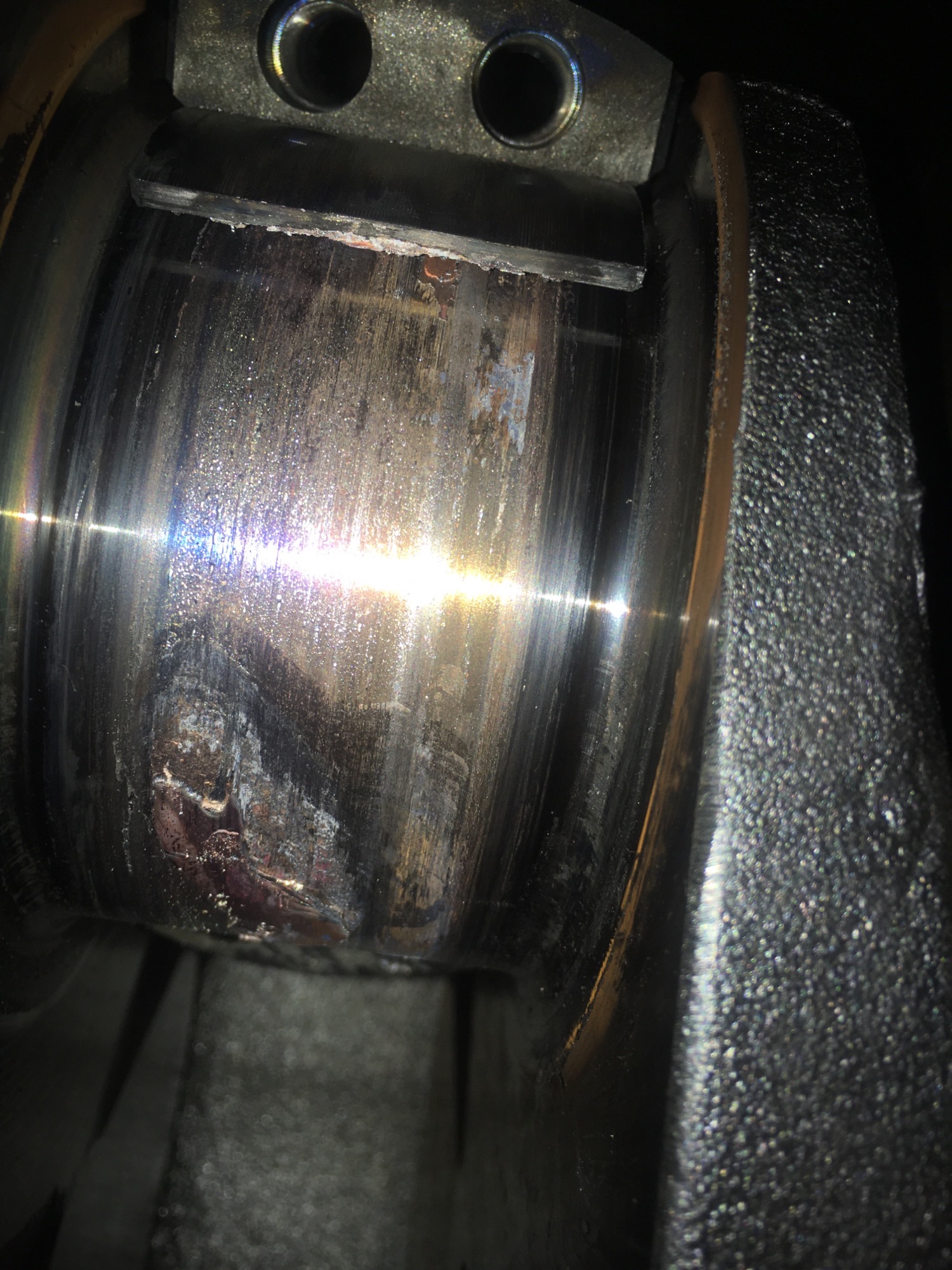

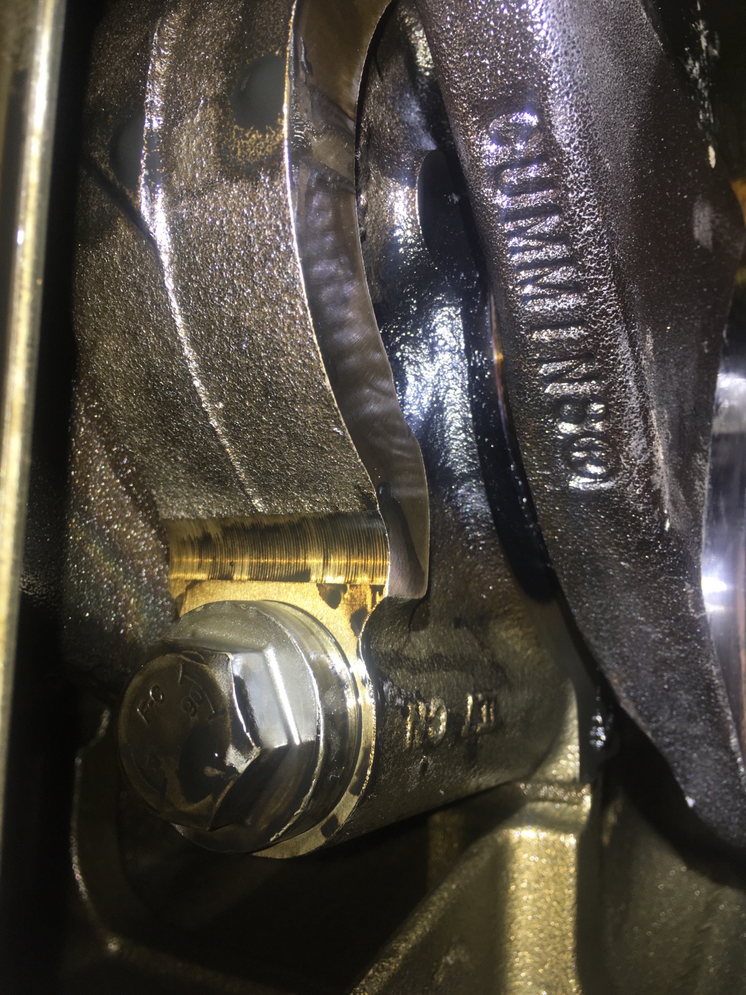

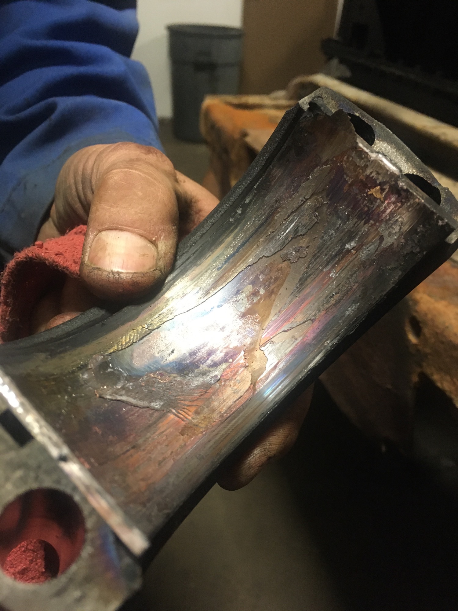

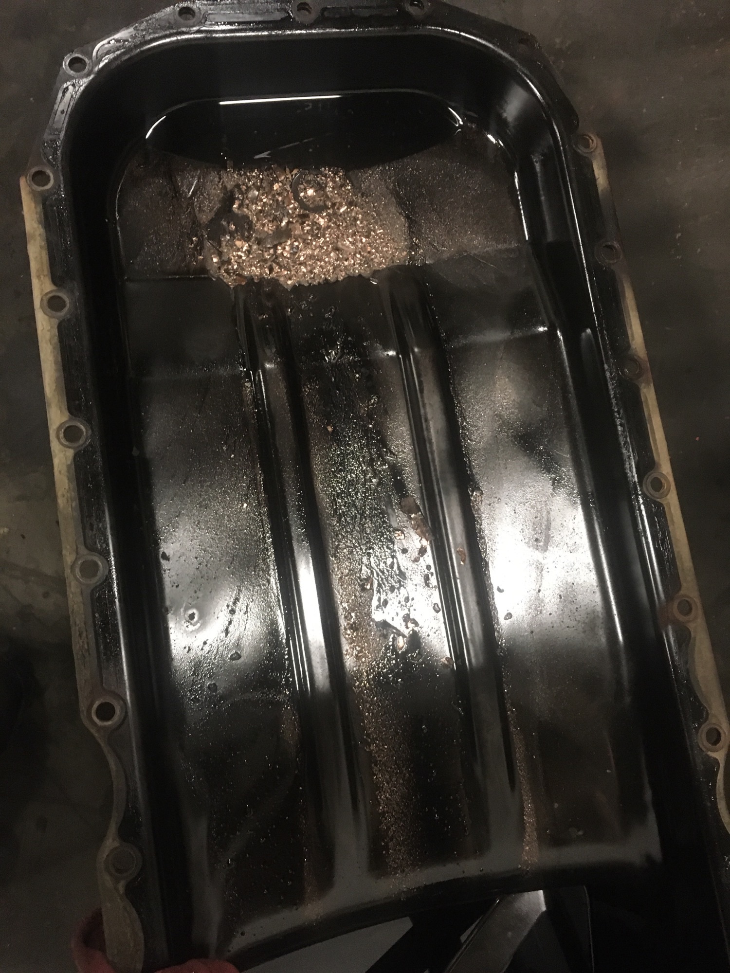

| Re-build fried engine? I have a CM2350 that died. No warning lights or beeper, and I wasn't thinking to check the gauges, but they had to be within range. Engine seized! Got it towed into shop, they dropped oil pan to see carnage. ![]() ![]() ![]() ![]() This shop told me that I need a new engine (used and they will re-build it). I know it needs a new crankshaft so it has to be pulled out, but my question is: Can't a shop just re-build this engine, replacing all worn parts? Or, is it just cheaper to replace? Unfortunately this truck has an auto-shi#t trans, so replacing with a CM871 is most likely out of the question? Waterloo was right, I should have done everything in my power to re-build my CM871 when it died. This truck has been a financial nightmare. A really low mileage truck that shouldn't be having the problems it has. | |||

RE: Re-build fried engine? (11-17-2021 )barf Wrote: I have a CM2350 that died. No warning lights or beeper, and I wasn't thinking to check the gauges, but they had to be within range. Engine seized! Got it towed into shop, they dropped oil pan to see carnage. Either find a used engine and have Haggai rebuild it, or go recon. You'll have a real mess trying to salvage that IMO. This is coming from a guy that went against the grain a little here when I started, I've tried quite a few gambles to save $, and every single one just cemented in to listen to Rawze lol. That said, I looked close at my old 871 block that spun a main and rod and decided to scrap it. I'm in the beginning stages of building a new engine. Brand new block from Cummins and brand new crank from Cummins is the foundation. No machine shop work and reconditioned parts this time around. | |||

| RE: Re-build fried engine? What happened? You ran it out of oil? Fuel pump failure? Don't blame the engine, looks like neglect to me. You said you "didn't look at the gauges but they had to be within range"????? You're gonna get a good spankin for this one. | |||

| RE: Re-build fried engine? It can be salvaged BUT weigh your options, Price a overhaul kit plus a new crankshaft and labor vs recon vs used +rebuild Id even check with Hagg see if he might already have 1 built or ready to build Weigh all your options first, especially if you plan on keeping the equipment for a long period | |||

| RE: Re-build fried engine? Thanks for replies. The shop found a used low mileage engine that they're going to drop in without in-framing. They've inspected it and will install new seals as required. New clutch if required, etc. Oil gets checked every morning before starting. Maybe the fuel pump blew up? but when I pulled over it was still running. Yes, I can partly blame myself. I've had to add oil to this engine regularly, possibly a gallon a week, and should have had it checked out. Yes, I deserve to have Rawze yell at me! | |||

| RE: Re-build fried engine? When that much metal goes thru one then she's likely done-for... inspect the gear train, fuel pump, etc.. to determine how extensive the damage really is... or it is isolated to the crank, which I seriously doubt. This looks just like what happens when the fuel pump fails due to not having its guts replaced every 400k hours or 8300 hours. User's Signature: ->: What I post is just my own thoughts and Opinions! --- I AM Full Of S__T!. | |||
