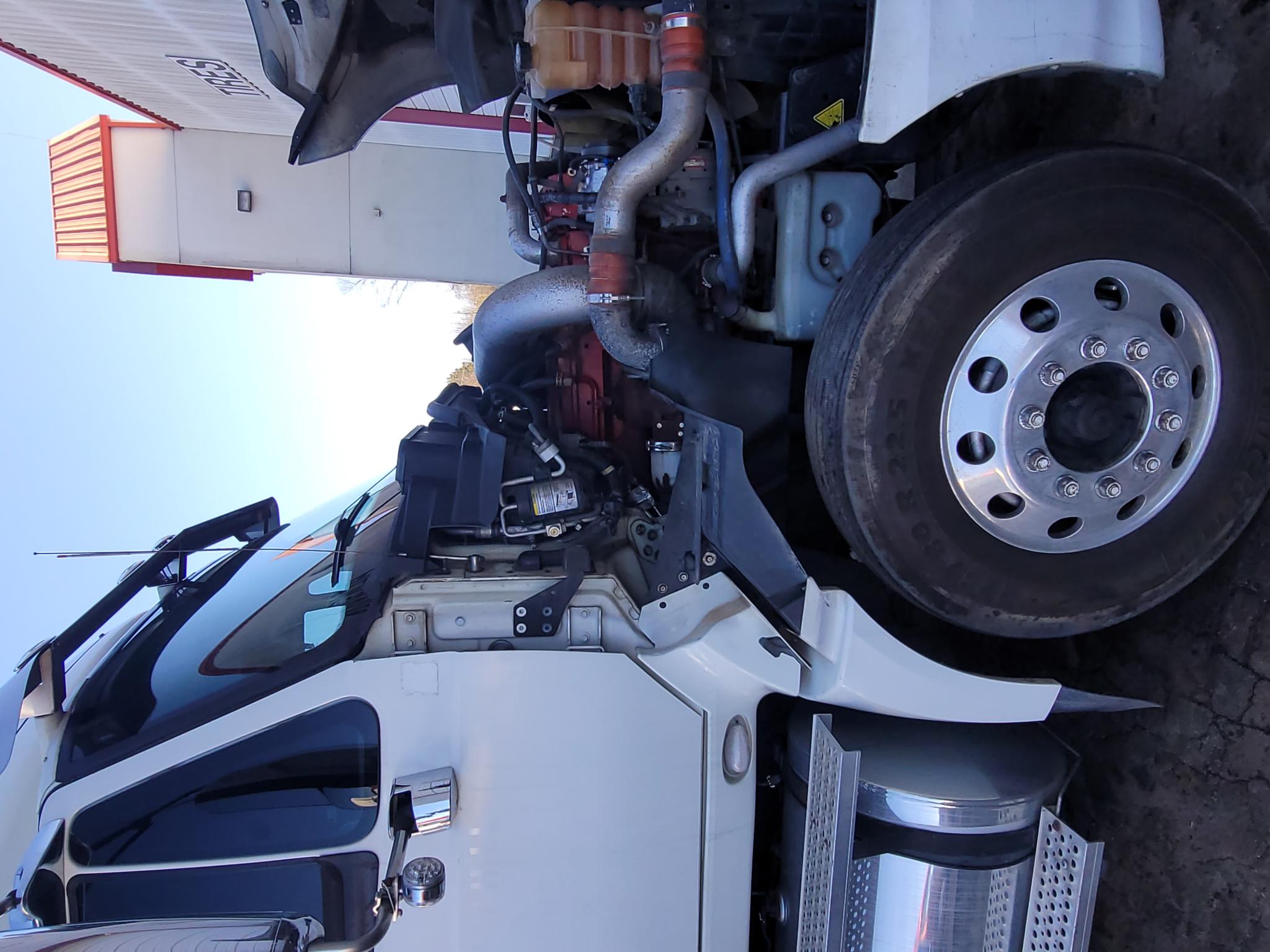

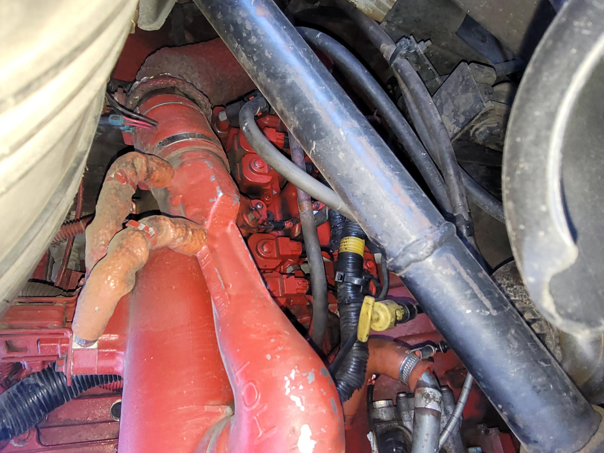

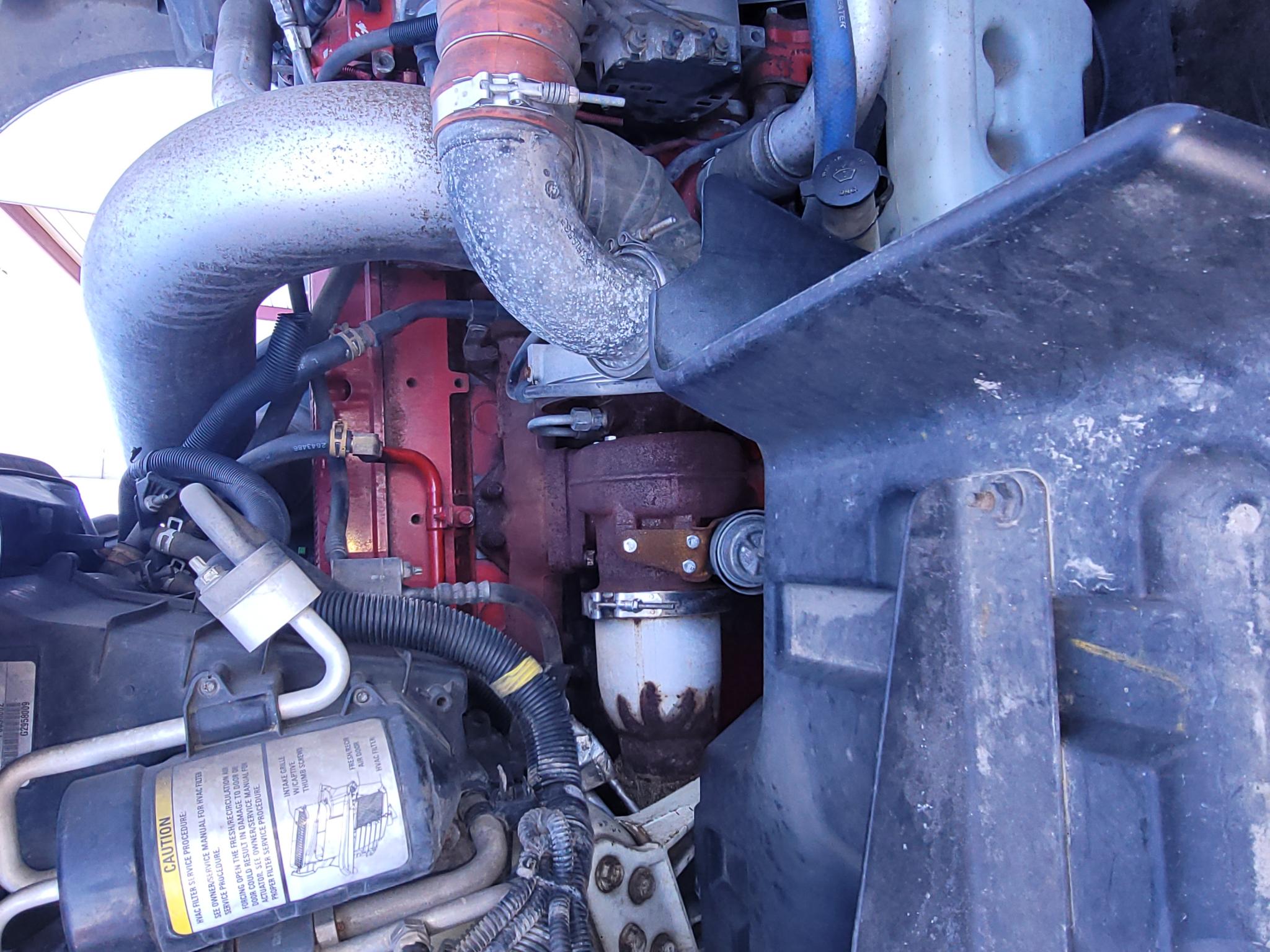

Came across this today While getting some parts for my Prostar, I came across this. I would like to get Rawze's and Haggai's opinions on this. This is an 09 Prostar with a 871. | |||

RE: Came across this today That looks like an air actuated turbo. The 871 turbo uses an electronic actuator. Maybe that truck is an 07 or older. User's Signature: im_seeing_parameters_in_my_sleep 1 | |||

RE: Came across this today It's an 871 with a VGT delete. Maybe not the original engine??? | |||

RE: Came across this today (02-05-2022 )Signature620 Wrote: It's an 871 with a VGT delete. Maybe not the original engine??? Oh is that a waste gate I'm looking at ? User's Signature: im_seeing_parameters_in_my_sleep 1 | |||

RE: Came across this today (02-05-2022 )74bassman Wrote: While getting some parts for my Prostar, I came across this. I would like to get Rawze's and Haggai's opinions on this. This is an 09 Prostar with a 871. That is a 'de-madated' CM871 with the VGT removed and some complete garbage turbo in its place.. and you can guarantee that the "delete" is nothing but garbage too!. That VGT turbo.. (that some complete moron has removed from that truck in those photos) is what sets the proper fuel-air-mix for the ISX engine.. and nothing but engine abuse, lower than normal fuel mileage, and a shortened engine life results when someone does crap like that. The EGR cooler is also missing and the water pump is plated off too. This means that cylinder #5 and #6 are going to run hot.. further shortening engine life for that abused engine. Not only that but the face-bearings of the water pump are loaded to h$ell due to the 70+, PSI of dead pressure in the circuit of the plated off piping. That is VERY HARD on that water pump and leads to eventual water pump failures. A fine example of a completely abused to h$ell engine right there. Looks like the typical "bad delete", where some truck owner gets dupped by some ignorant repair shop somewhere, into all those types of engine killing mods. User's Signature: ->: What I post is just my own thoughts and Opinions! --- I AM Full Of S__T!. | |||

RE: Came across this today The turbo is off an Detroit 12.7 | |||

RE: Came across this today (02-06-2022 )Rawze Wrote:(02-05-2022 )74bassman Wrote: While getting some parts for my Prostar, I came across this. I would like to get Rawze's and Haggai's opinions on this. This is an 09 Prostar with a 871. This probably why it was sitting in a salvage yard? | |||

RE: Came across this today (02-06-2022 )74bassman Wrote: ... very highly likely, yes. User's Signature: ->: What I post is just my own thoughts and Opinions! --- I AM Full Of S__T!. | |||
