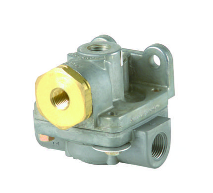

THE QR1 Valve is bad. It is located under fifth wheel. When you release your brakes there is a quick release valve in the rear that trips the air and not letting it come back to the front. You should have one that has 4 lines to it.
08-29-2016, (Subject: Bendix brake valve question )
RE: Bendix brake valve question
(08-29-2016 )Mr Hagg Wrote:  THE QR1 Valve is bad. It is located under fifth wheel. When you release your brakes there is a quick release valve in the rear that trips the air and not letting it come back to the front. You should have one that has 4 lines to it.
It should look like this./uploads/201608/post_848_1472523187_a2d9fef4eef9c876aa88d473cf4bf1e6.jpg

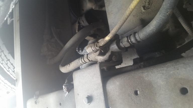

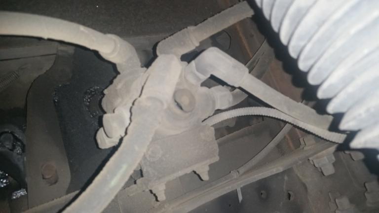

Thank you for the information Mr Hagg, I see a valve directly under fifth wheel I will post a pic of it shortly and then there's a valve with 3 connections located near cat walk. Just want to be sure which is QR1, I will post a pic of both.
./uploads/201608/post_1798_1472595665_0236093ff195aa4cb2b76edbb98c28d2.jpg

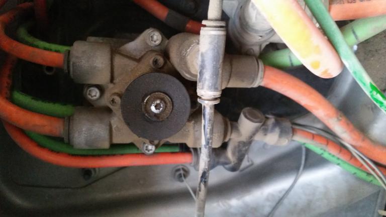

Here is valve directly under fifth wheel.
./uploads/201608/post_1798_1472596082_9e90b32fdaa7d497a4e47f144bfc565a.jpg
