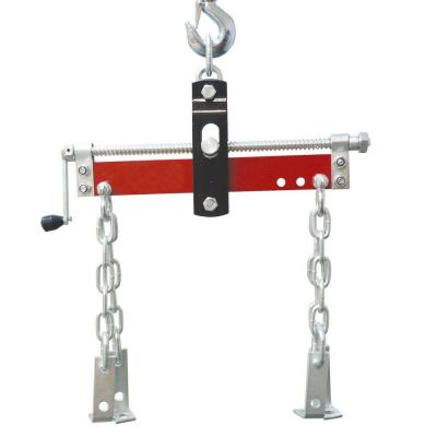

A head lifting bracket tool or homemade facsimile...

Most my work has been on gas engines mostly. I have done some work on Audi 5 cylinder diesels. I have a engine tilt bar for pulling motors I think would work perfect for that

(09-02-2016 )ahm700 Wrote:  Most my work has been on gas engines mostly. I have done some work on Audi 5 cylinder diesels. I have a engine tilt bar for pulling motors I think would work perfect for that
I was referring to the bracket that bolts TO the head to facilitate lifting and placing squarely on the block, not the forklift or hydraulic lifting device...
That's what I was talking about. I will try and attach a pic.
Ok, my bad...ignore my rhetoric
