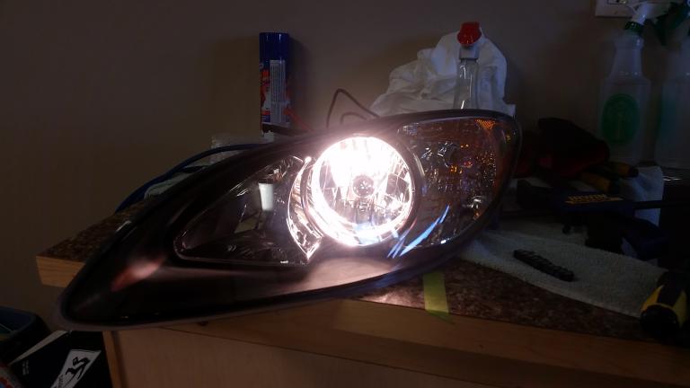

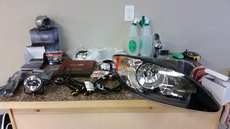

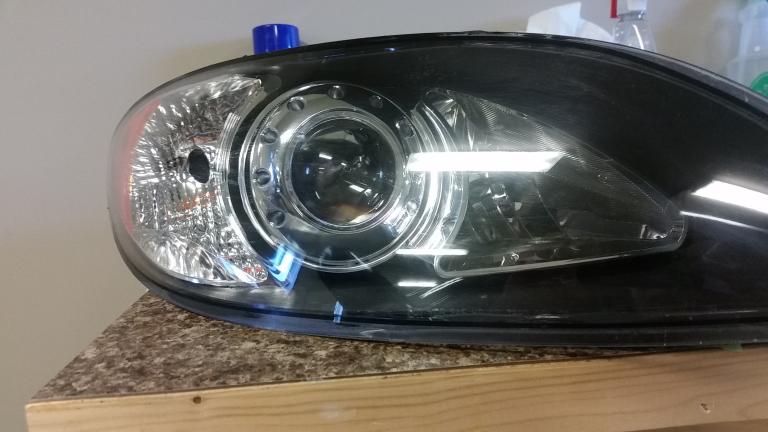

Finally got some days off and decided it's time to do my headlight hid retrofit. Winters just around the corner so I wanted better lighting but am not a fan of the plug and play hid kits and the trucklite led lights for the prostar are no good as they don't heat up enough to melt snow and ice buildup. Plus hid blows led clear out of the water.
I went with the following
Morimoto FX-R 3.0 bi xenon projector
Morimoto 55 50w ballasts
Osram night breaker 4300k hid d2s bulbs
./uploads/201609/post_1367_1473275136_52fa696f27498b84e31dc5af1cdaf325.jpg

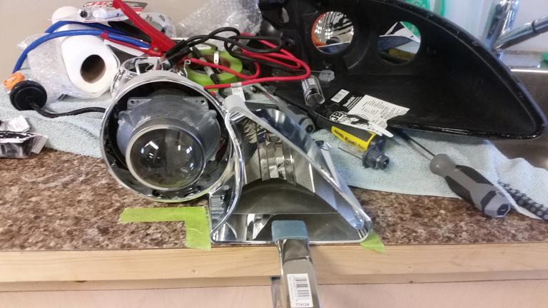

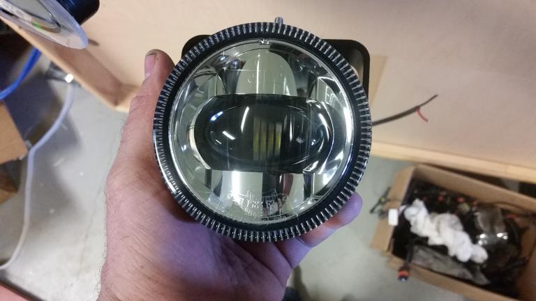

The new projector is a low and high beam, making the current reflector high beam useless but I went ahead and put in some Morimoto led 9005 bulbs for the heck of it. I also purchased some new fog light that I will use as driving lights. They are a very wide narrow pattern that will just light up the front area and ditche's without blinding oncoming traffic. I like to see real good but I will not do it at the expense of blinding others.
./uploads/201609/post_1367_1473275221_2ea04777dd186e90058c7d65c1b95123.jpg
./uploads/201609/post_1367_1473275279_fdee3792c57cb473ab6e63dd0876df4e.jpg

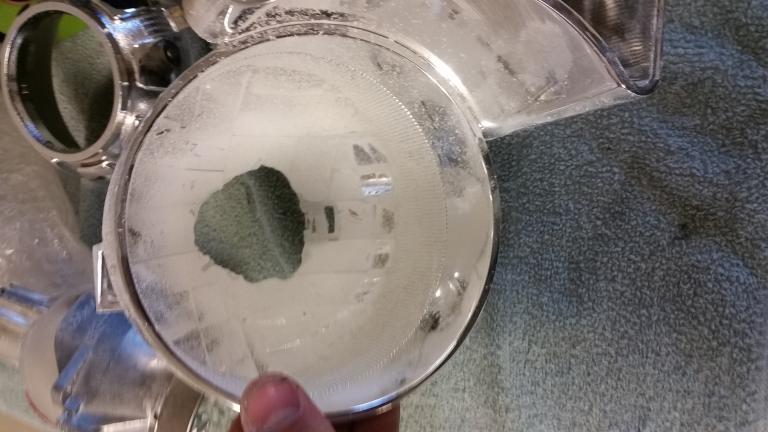

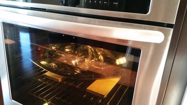

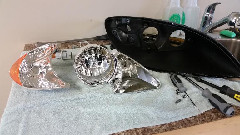

So here we go. Got my prying tools ready and the headlight goes into the oven. 300 degree's for 5 minutes.
./uploads/201609/post_1367_1473275426_747edfec6e44e5ec889fd6240ba804ea.jpg
./uploads/201609/post_1367_1473275496_d85918c32c83e6c9effe3a2d803086b5.jpg

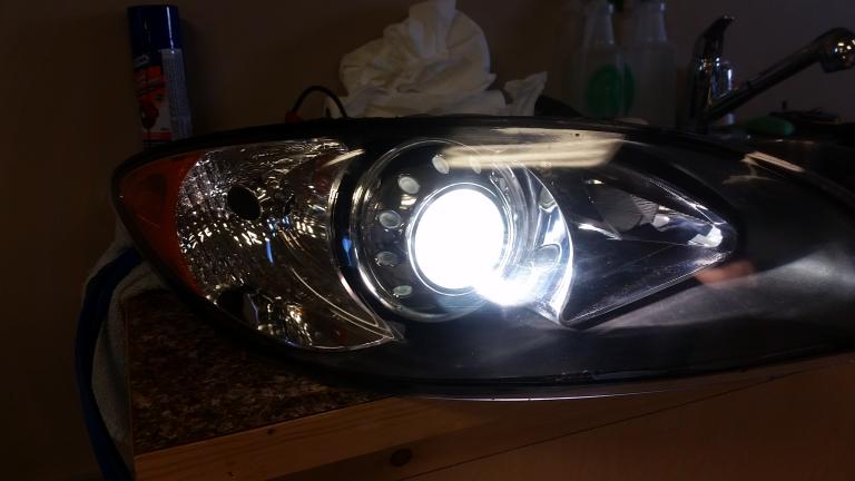

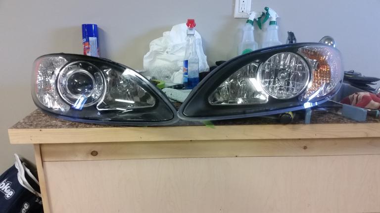

Here's a side by side
./uploads/201609/post_1367_1473275839_197eddaf3ee406118455ecf669eb665b.jpg
And lit up
./uploads/201609/post_1367_1473275897_e2df54c9690950b2e617e2636a4435fd.jpg
./uploads/201609/post_1367_1473275930_7b16fa3cda8fd570e47a305ab054db04.jpg

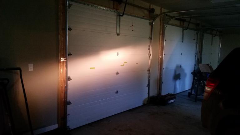

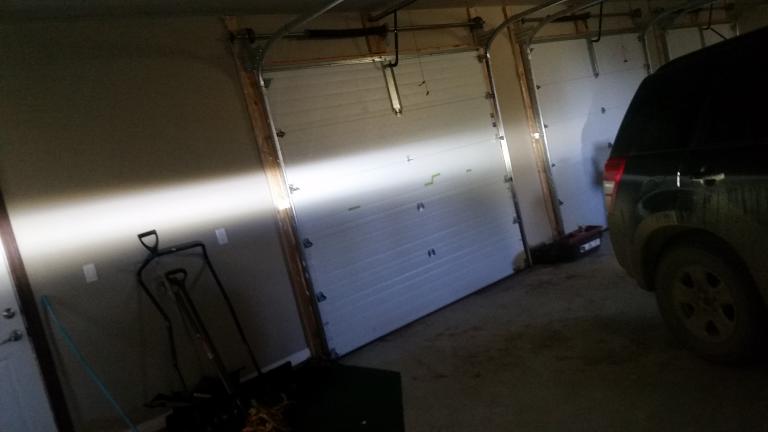

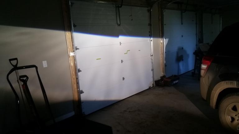

And finally here are some output shots. You can clearly see why I've upgraded.
./uploads/201609/post_1367_1473275995_cef4383e8f873cb9508602b3a4ae334f.jpg
./uploads/201609/post_1367_1473276037_d6ec40e5003ee3b8f8b2a41bb5c45a06.jpg
