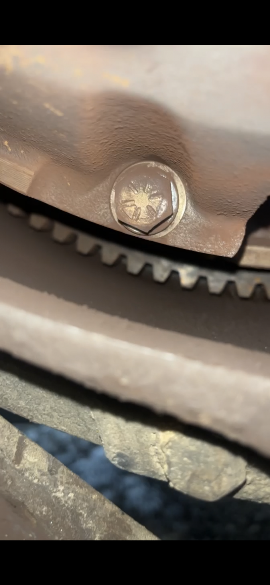

(11-16-2022 )Rawze Wrote:  maybe low on hydraulic clutch fluid?.
I was looking back on the video I took. Do you happen to know what this bolt is for ? Looks like it it recently moved with the shiny spots around it
