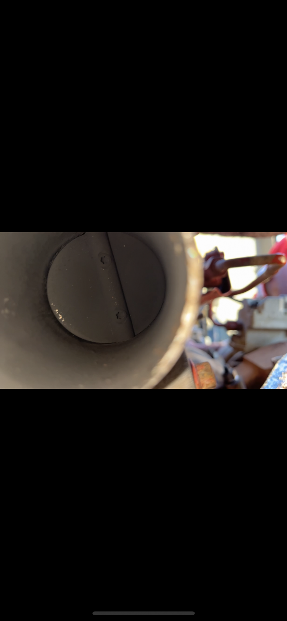

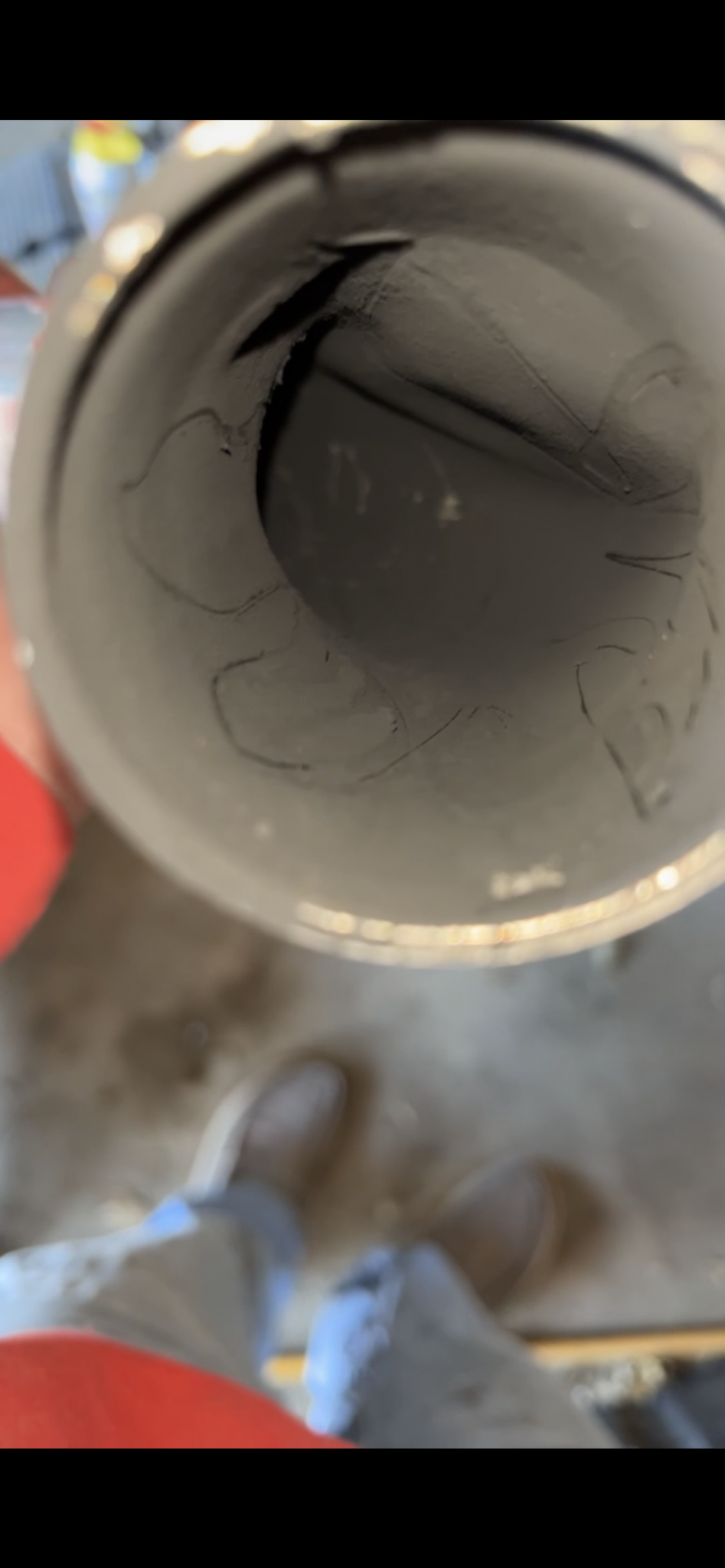

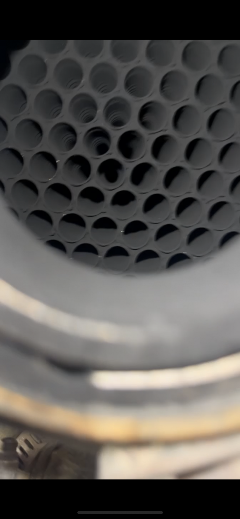

| How’s this Egr Cooler and Valve Look? First time doing this. Does this look normal ? Best method to clean it ? | |||

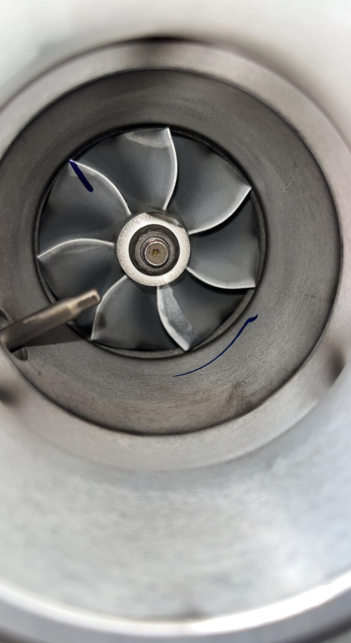

RE: How’s this Egr Cooler and Valve Look? (11-22-2022 )BrandonOlsen Wrote: First time doing this. Does this look normal ? Best method to clean it ? Also how’s the turbo look? | |||

| RE: How’s this Egr Cooler and Valve Look? On the EGR cooler, never heard of cleaning them, they either work or they don't, start leaking coolant. The EGR Valve, I would use carb cleaner from the auto parts store and a tooth brush. I believe Rawze has a video on that subject. The Turbo looks ok to me, is it having issues? User's Signature: 2008 ProStar, OEM 600hp CM-871, 18spd, 3:42, in framed in Rawze's driveway. Every day is a fresh new episode of, "The Twilight Zone"... Rod Serling lives rent free in my head. I can smell the Chesterfields. | |||

RE: How’s this Egr Cooler and Valve Look? (11-22-2022 )Waterloo Wrote: On the EGR cooler, never heard of cleaning them, they either work or they don't, start leaking coolant. The EGR Valve, I would use carb cleaner from the auto parts store and a tooth brush. I believe Rawze has a video on that subject. The Turbo looks ok to me, is it having issues? On the cooler I was more or less wondering if it looked "normal" as i've never seen one apart before. I ended up getting carb cleaner and cleaned it up nicely and started taking the rest of the egr pipe off to continue clean it all the way through. For the turbo i'm having problem with excessive exhaust back pressure between 800-1000rpm and boost shoots up. I'm leaning on maybe the actuator. I thought it was trying to regen but more I thought about it I dont think it was. When it regens truck makes a little boost and thats what made me think that. That's why im doing a complete egr tune-up. But I have not smelled the "regen" when it happens. On the turbo I didn't know if the while stuff on top of the blades was normal or not. If you look at the center of the turbo the round peice it looks like its partially broken off and didnt know if thats suppose to be like that or if it broke and I need to be worried | |||

RE: How’s this Egr Cooler and Valve Look? (11-23-2022 )BrandonOlsen Wrote: ... On the turbo I didn't know if the while stuff on top of the blades was normal or not. If you look at the center of the turbo the round peice it looks like its partially broken off and didnt know if thats suppose to be like that or if it broke and I need to be worried looked perfectly normal to me. The part your claiming is "broken off" is not.. it is part of how they shave the impeller to balance it after it is assembled. as far as it being dirty.. someone was cheaping out on air filters.. not changing then m enough. or ran it with one of those garbage aftermarket "washable" air filters. -== ANY dust of dirt going into that engine and turbo will very quickly shorten the life of the engine and cause permanent excessive blo-by in the cylinders.. A proper air cleaner and regular replacements is extremely important. User's Signature: ->: What I post is just my own thoughts and Opinions! --- I AM Full Of S__T!. | |||

| RE: How’s this Egr Cooler and Valve Look? You should use charcoal lighter fluid or carb&choke cleaner. Brake cleaner seems to turn things into soot magnets and they get Carboned up twice as fast. You can clean an egr cooler, they do get plugged up eventually. If you have it off it's a good time to do it. Unless you have very few miles/hours of run time on it. https://www.motortrend.com/how-to/1606-w...solutions/ | |||
