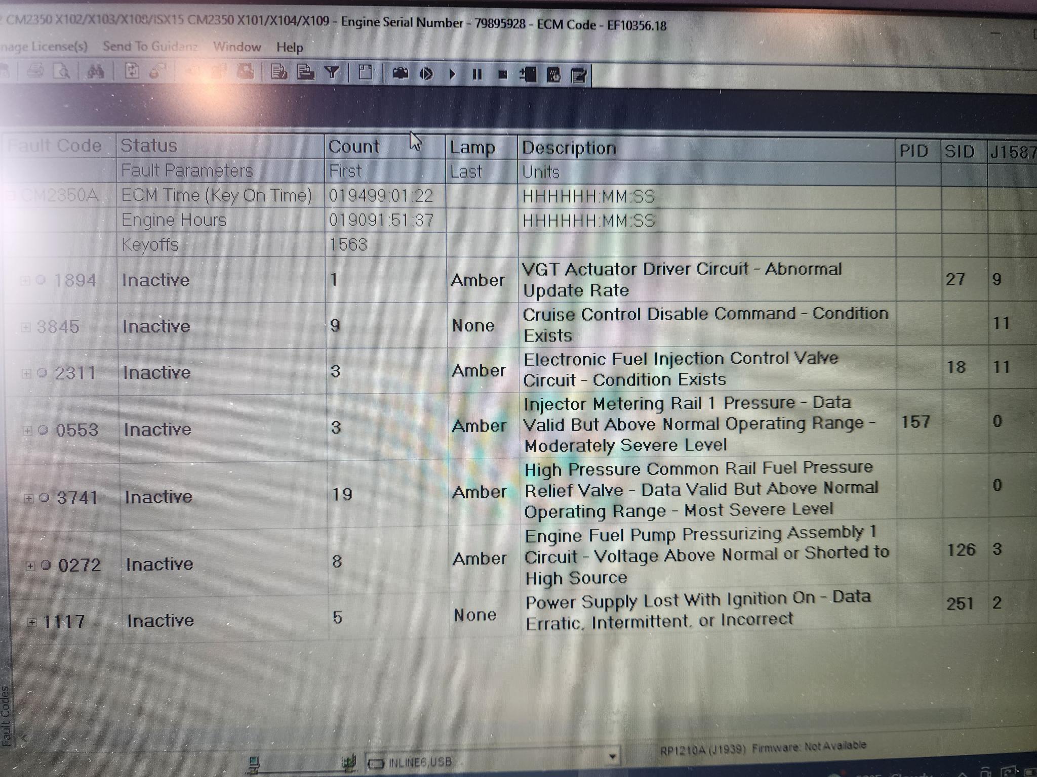

Maybe unrelated or lots of old faults not cleared, but you appear to have multiple electrical faults there. Would be a good idea to check all the battery connections/cables, grounds and wiring harnesses for potential problems / breaks / rubbing / shorts / corrosion.

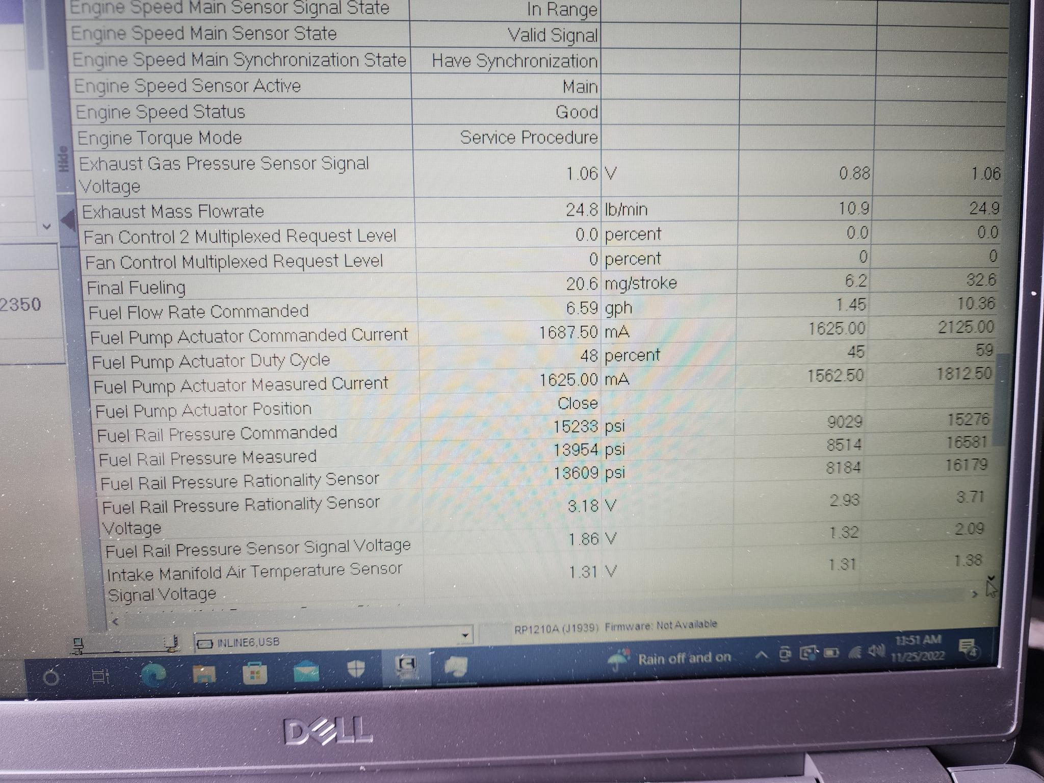

Commended fuel rail presure and actual difers by decent amount

I really don't know parimeters of fuel presure but I'm not fluctuating more than 1300 psi from commended to actual. From the pictures I posted. It's my first cummings and it's a huge learning curve for me always had pre emmison engines before d60 3406e cat
