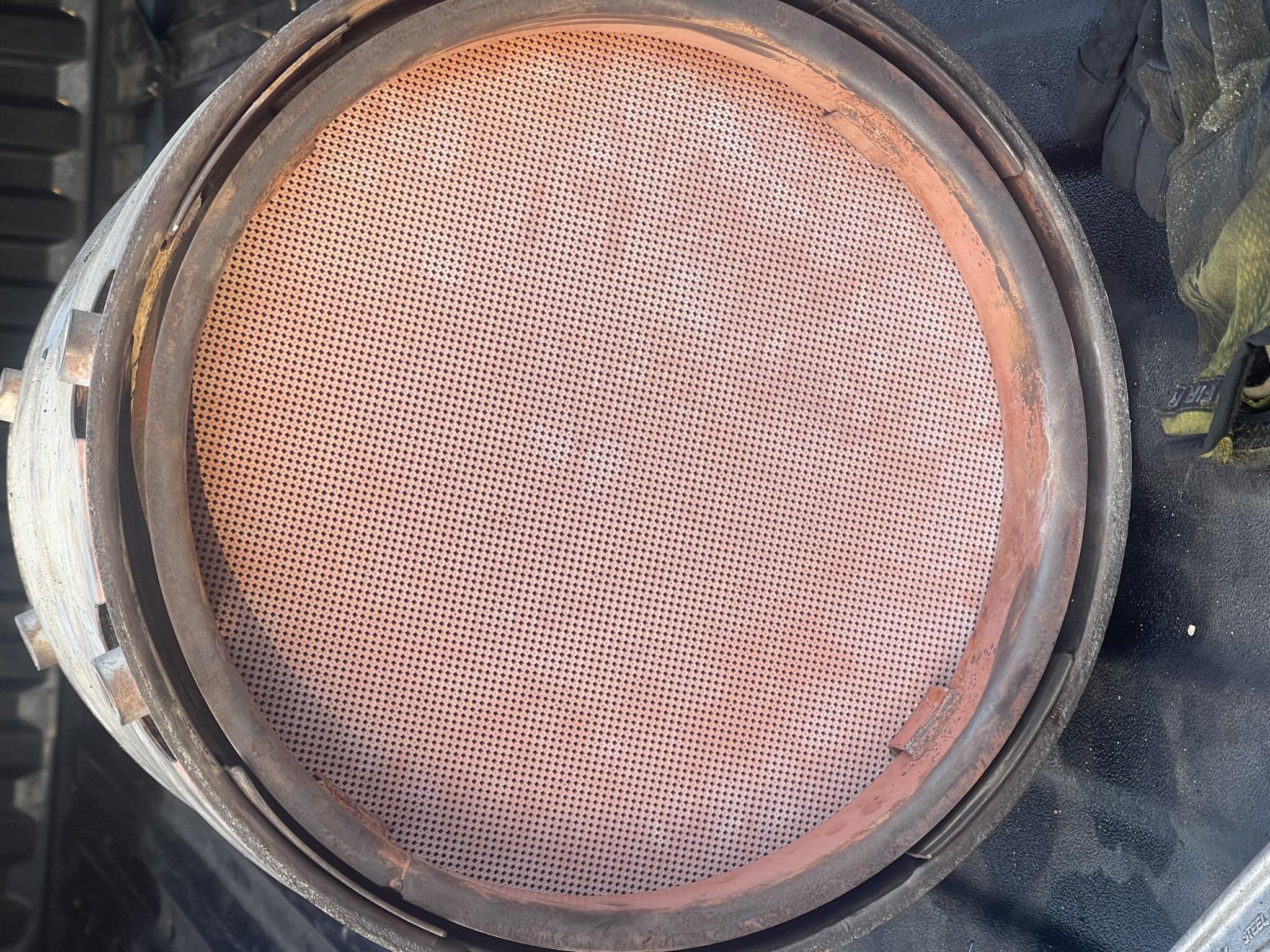

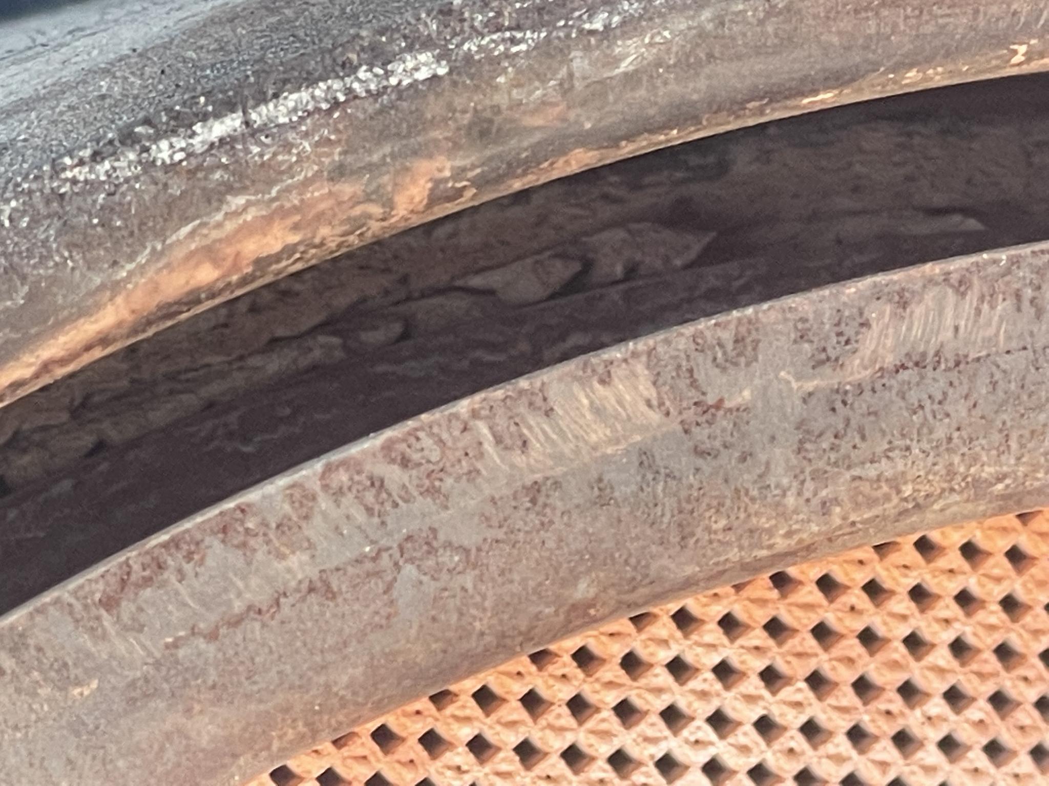

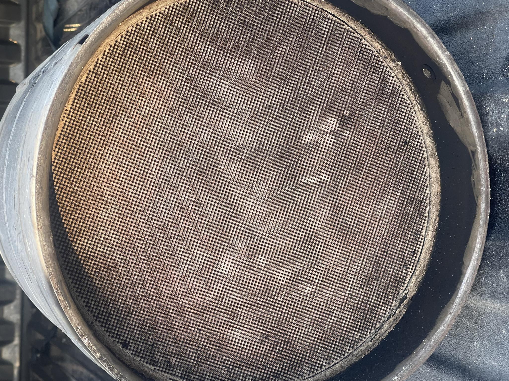

Hello everyone I was getting code 3376 incomplete regen. I regened for 2 hours on Thursday night and drive home 2 hours. I then regened and watch the temp only go to 900 degrees in insite. I have done my forced regened watxh temps go to 1050 or better. I took it of to a shop that cleans and sells both. I took doc to shop they said it was cad because it filter was pushed out from back pressure. I had it cleaned a few months ago and took it out today. Some white pieces came out I guess its the seal around it. Best to replace it?

I have a Cummins isx15. I took it to a cleaning shop and they stuck these lil straw things into the doc . They wouldn’t go through it in certain spots. They said it collapsed in certain places and said it needed to be replaced. I had a bad egr cooler I replaced this summer and not sure how long it was bad. The dpf was pink and I cleaned it when I did the egr. I probably should have changed them at that time. They saying it’s faceplugged and kept getting the shutdown dpf filter full code. Thursday and Friday after forced regens.

first of all, any liquids significantly weaken the DPF and DOc units. It washes out the precious metals in them quite rapidly and easily.. then they do not function properly any more. This means that if your egr coler was leaking, it ruined those units.. or made them very weak at the least. -= Also, those element cannot be cleaned with liquids either for the same reasons.
next.. the DPF unit,.. every other hole IS SUPPOSED TO BE BLOCKED OFF .. it is part of its design for properly trapping soot and ash. Not sure about the DOC though, if it is supposed to have blocked hols=es or not in its design.
sounds to me like both units are bad if you had an egr cooler leak. It also.. from how the look in the pics, .. looks like someone might have used a liquid product to clean them.. this ruins them too... so i would say that both are likely definitely bad at this point.
