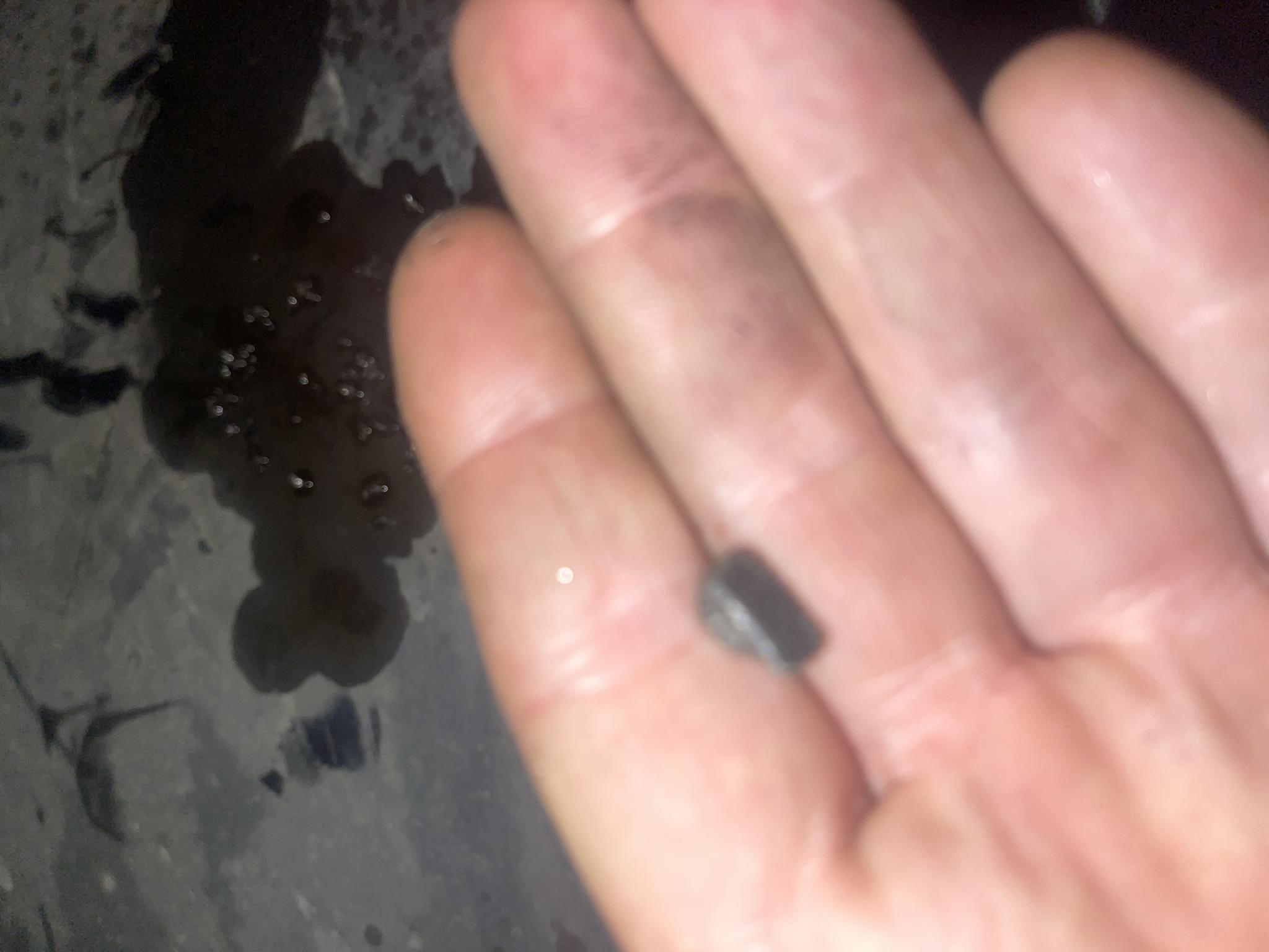

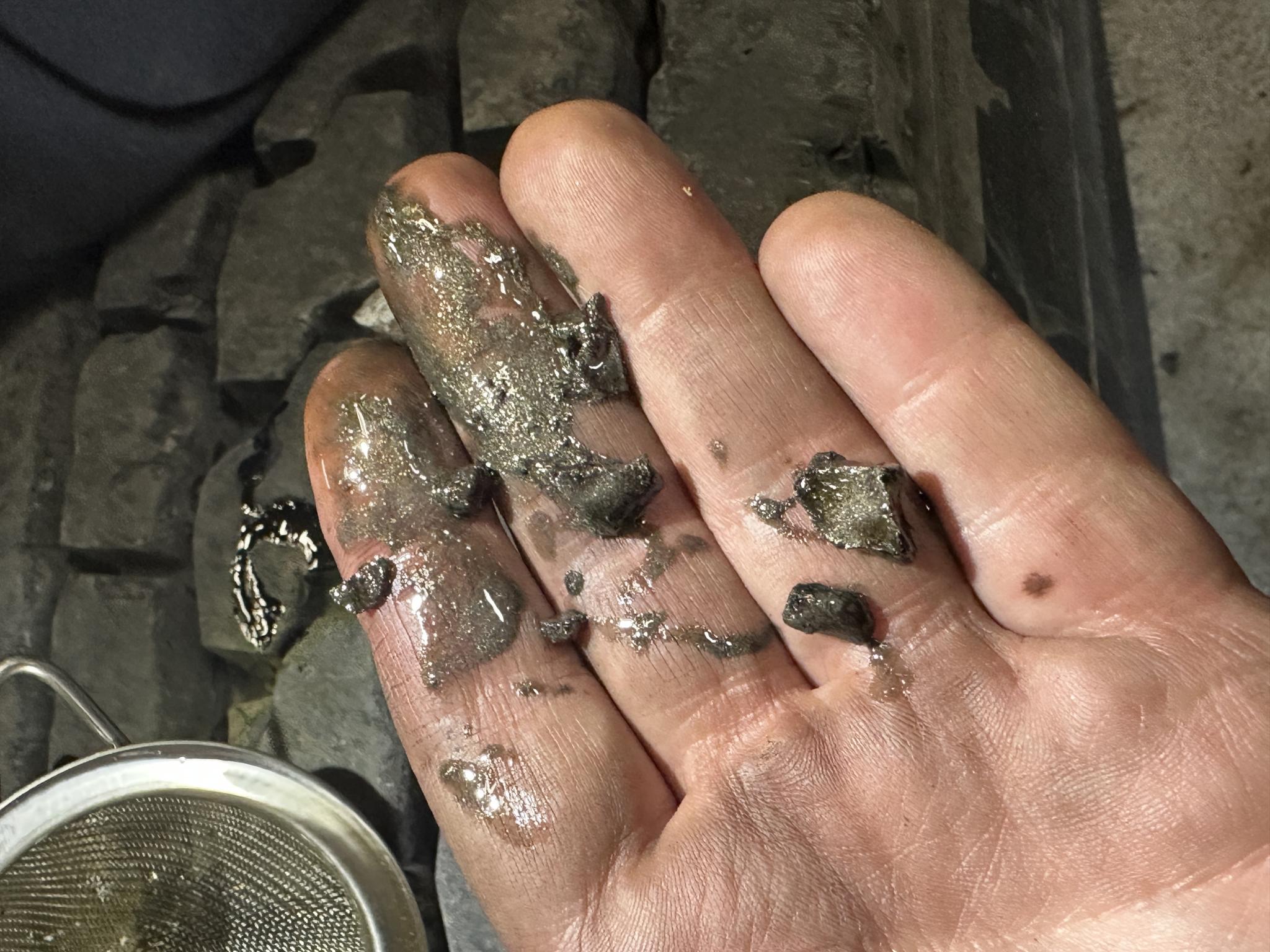

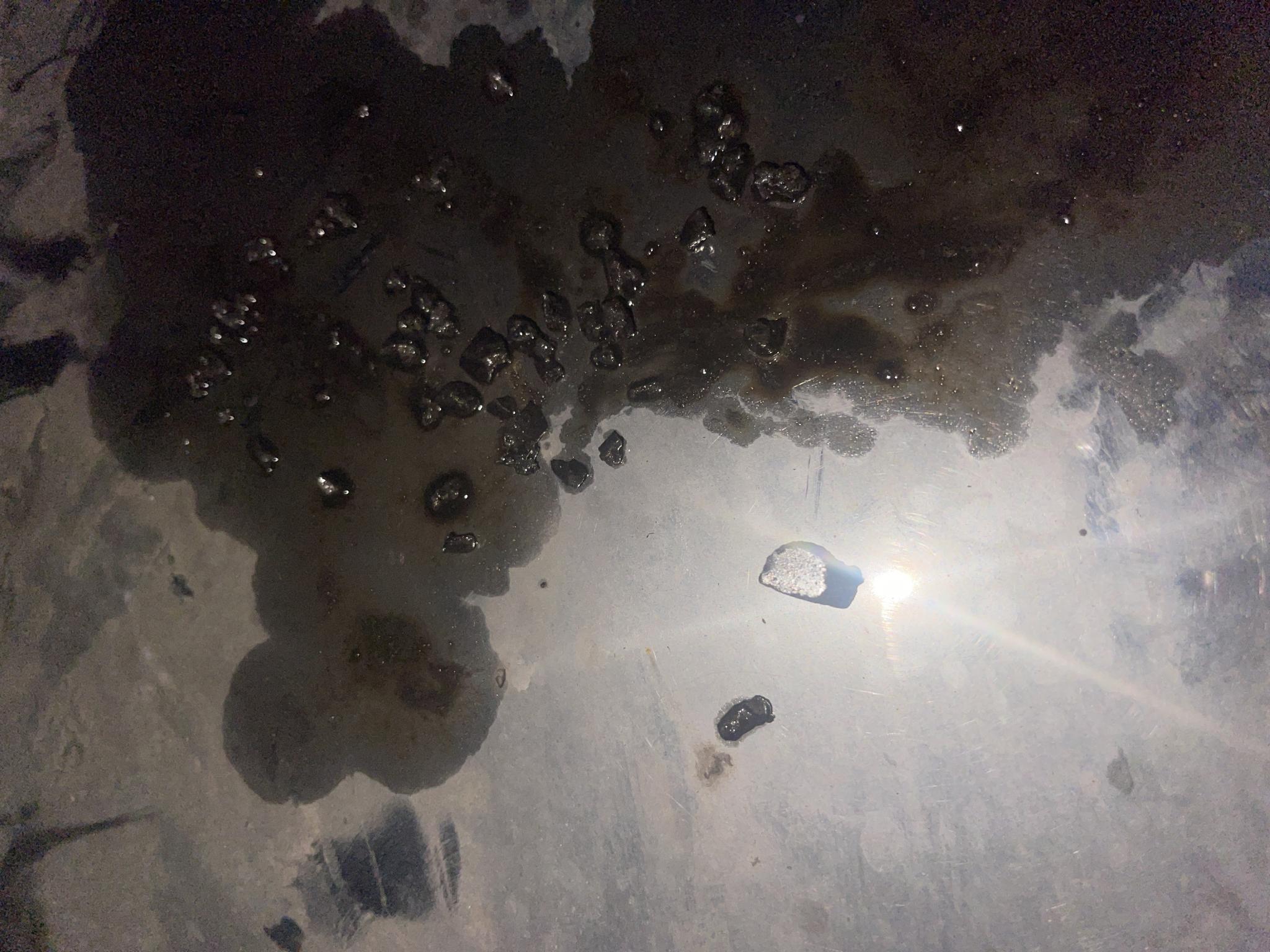

(03-14-2023 )arazdolgin Wrote:  So fixed my front differential. D46-170 with 4.10 rears cost me 7k from Drivetrain in Chicago, pretty expensive, plus labor.
The repair guys from Drivetrain said: “ We found out the input and power divider components where worn out, and the ring and pinion started to pit.
Something also ran through the pinion drive gear.” Is that means I used diff lock and broke it? I did it once with heavy stuff with side curb.
This particular front differential was installed in 2020. I am heavy haul guy.
So my question is do i need to upgrade info in ECM if my original rears was 3.78, but I changed to 4.10 rears?
How to ensure the engine torque and speed governor is not rated/set higher than the diffs continuous use duty-cycle ratings (and not its peak ratings)??
Any opinion will be great as I don’t want to stuck in again, thank you
like was said.. something went thur them.
WHEN is the last time you inspected your hub bearings? .. and re-torqued them?. - Maybe a bad inner (or outer) hub bearing making metal shavings into the rears?.

At Drivetrain and at the labor shop they suggest that the metal chunks were too big to go through. I showed them the metal parts and they are like cubicle rectangular not like bearings. But you’re right, we could check them while we are on them. Will inspect the bearings though
