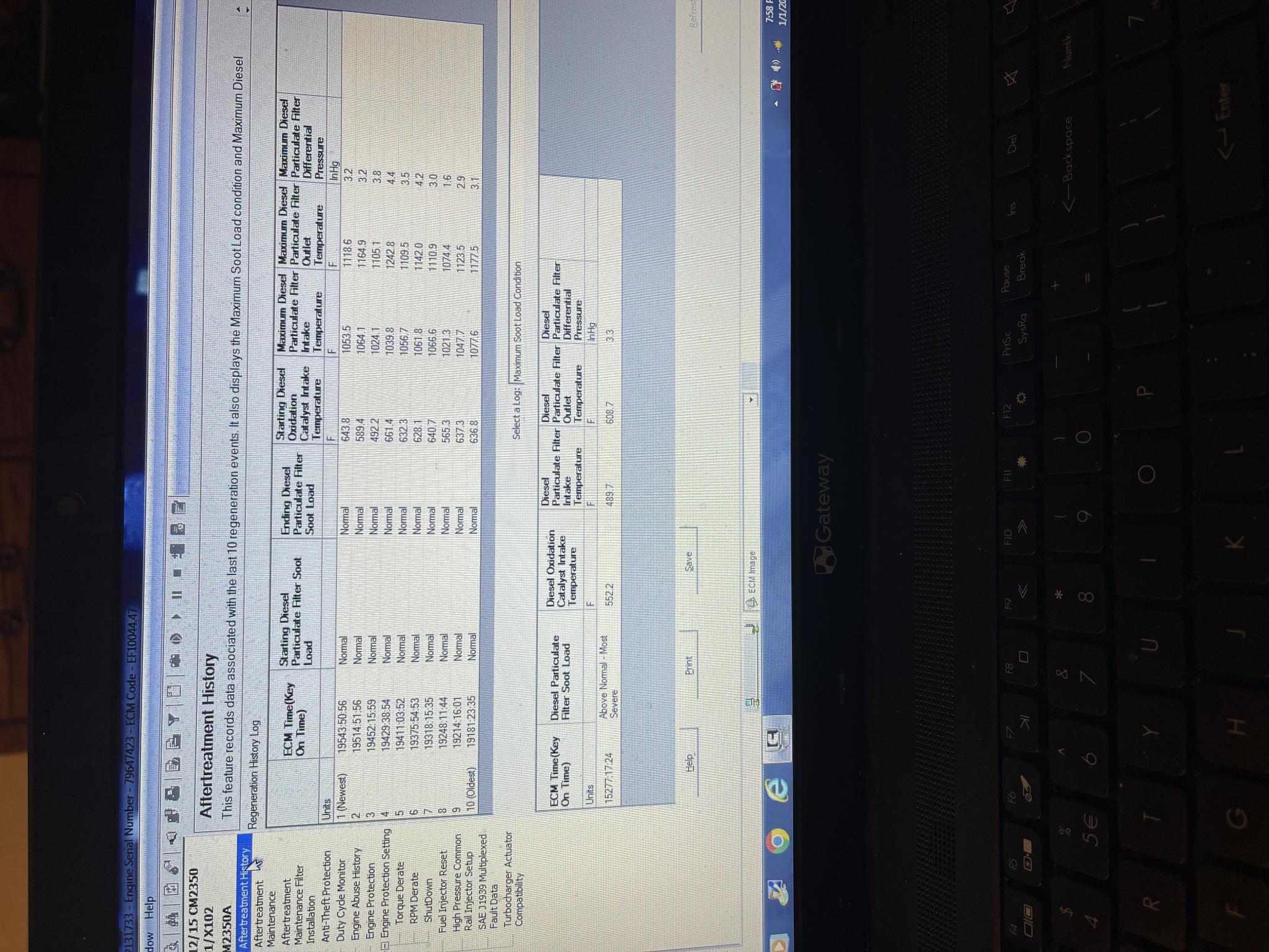

01-01-2023, (Subject: Egr valve )
RE: Egr valve
Well for a little over a year after i replaced the dpf with a new one it would only regen every 60hrs or so and even then the soot load was only around 20% but when all thos started it has been regening more and more but nothing seems fo be clogged just getting more soot or unburned fuel heading down the tail pipe it seems.

Sorry i dont know why it turned my image
