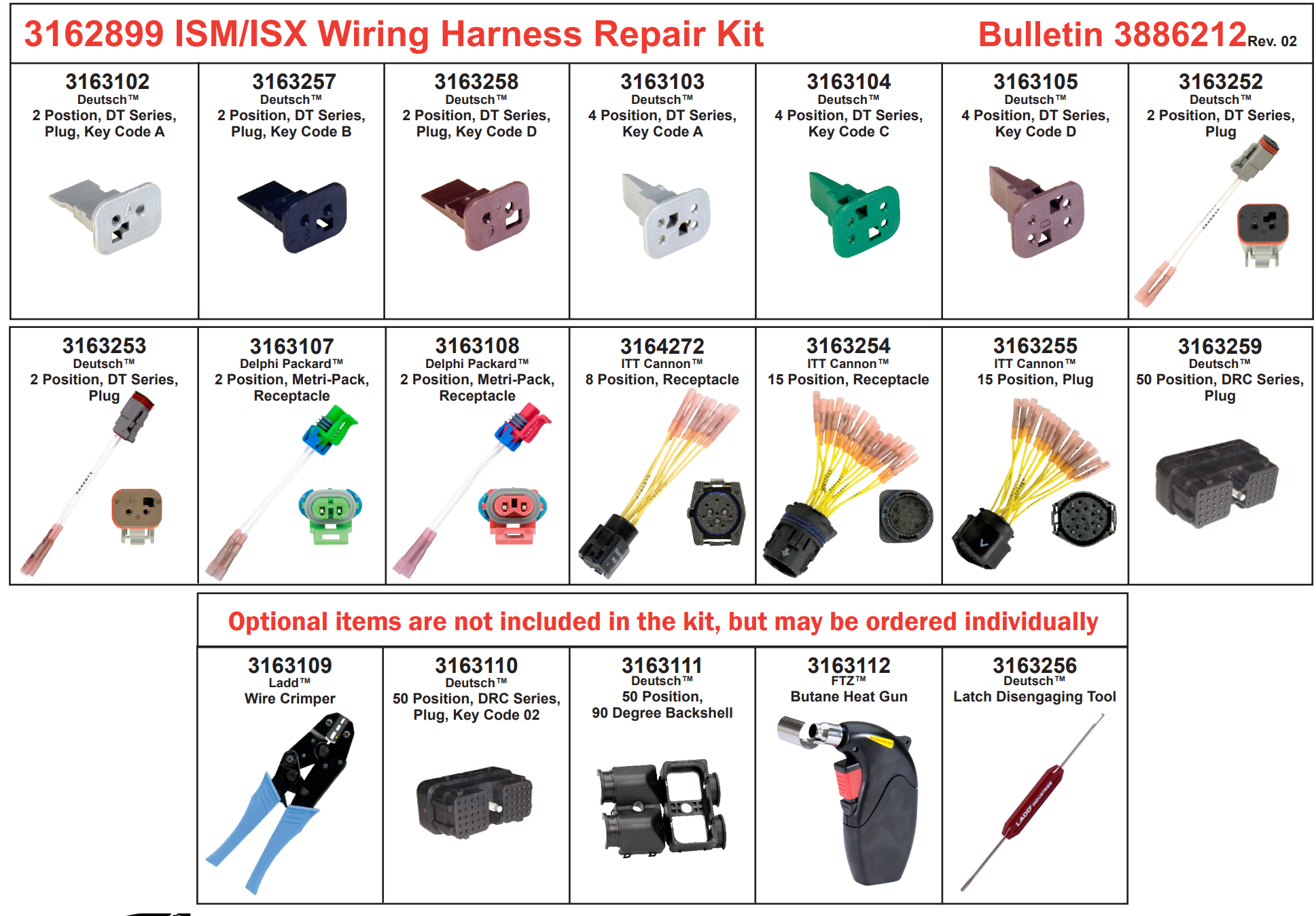

I’m starting to have issues daily with my engine breaking up, setting codes, etc that I was able to trace back to the actuator connectors. I think I remember somebody mentioning there were replacements available, however I can’t find them now. Anybody happen to have a part number for these connector pigtails?

Fueling and timing actuators?
If so, get yourself some of these:
https://amzn.to/3Zii3V2
Then swap the front orange locks with the old ones off the old plugs as they are keyed differently.
Make sure you solder the new ones if you have the means necessary.
If you want the Cummins pigtails 3163252 and 3163253 should be the connectors you're looking for and if the locks are destroyed, then match the locks with these here:
./uploads/202301/post_6320_1673047089_d2f33050968d64e185ed7051a14bca3c.png
