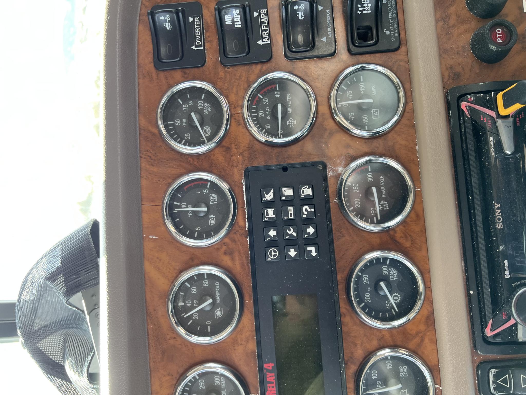

|  2006 Cm 870 cold weather derate    Hello, everyone.    First post so here it goes. Thank you for all the knowledge that has been posted on this site. I have a few trucks with n 14's and just bought a 06 379 with a cm 870 I believe. Tag is off the valve cover, Inline 5 should be here any day, to get the file copy off the ecm. So I live and work the truck in Western colorado at about 6000 -9000 ft elevation. First time out in the cold about a week ago and the truck derated I believe. 900 to 1000 degrees EGT on hard climb loaded and maybe 24 psi on boost gauge. Started searching and ran across a post talking about the cold weather derate under 35 degrees on this vintage 870. I believe someone mentioned Unilever's possibly had a fix or a way too tell this is happening at it is due to the CIT temps. should have the inline 5 this week and hopefully I can get this loaded on a win 7 computer and get this bug out of the software. I really appreciate everyones help in this matter. Thank you Ron  |  |||

|  RE: 2006 Cm 870 cold weather derate    Understood Rawze.   Tree 98, Its finally warmed up enough out here in Colorado to start the truck up. After letting it warm up I disconnected the EGR plug, and the "CEL" light went on. So I am assuming then that the EGR system is in tact which I am fine with, at this point. I still haven't figured anything out with Insite as I am not very good with computers. And I don't have enough seat time in the truck to know if it is infact the cold weather bug, that was found in a few other CM 870s as described by Unilever's past post that I had found (03-24-2018 )Unilevers Wrote: its a little know fact that cummins later calibrations had a glitch in the 870's in extreme cold ambient. It took me awhile to sort it but if i did why the hell didnt cummins? this is still a issue in all current calibrations for 870's.ref: http://rawze.com/forums/showthread.php?t...5#pid24825 I am going to have to wait until it warms up into the 50's and haul a load I guess to figure this out.  |  |||

|  RE: 2006 Cm 870 cold weather derate    Well it finally warmed up into the 50’s and I was able to haul a few loads of gravel at about 6000’ elevation I took two loads grossing 50,000lbs boost never went above 28-30 psi on peterbilt gauge. After hauling two loads I brought it home and cleaned the two sensor on the intake, and the other sensor on opposite side on the top in front of the lifting lug. I didn’t clean the tubes leading to it, it did not change how it ran. I going after finding the delta p sensor next, and see if that helps.    I did notice today that it’s sound like the turbo pitch changes at idle at times similar to the exhaust brake being on at idle on a 6.7 dodge vgt. Thanks Ron  |  |||
