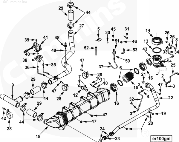

looks like this. #12 goes to the block up front and #22 goes from the egr cooler to the thermostat housing.
Thanks marek, a pic is worth a thousand words!

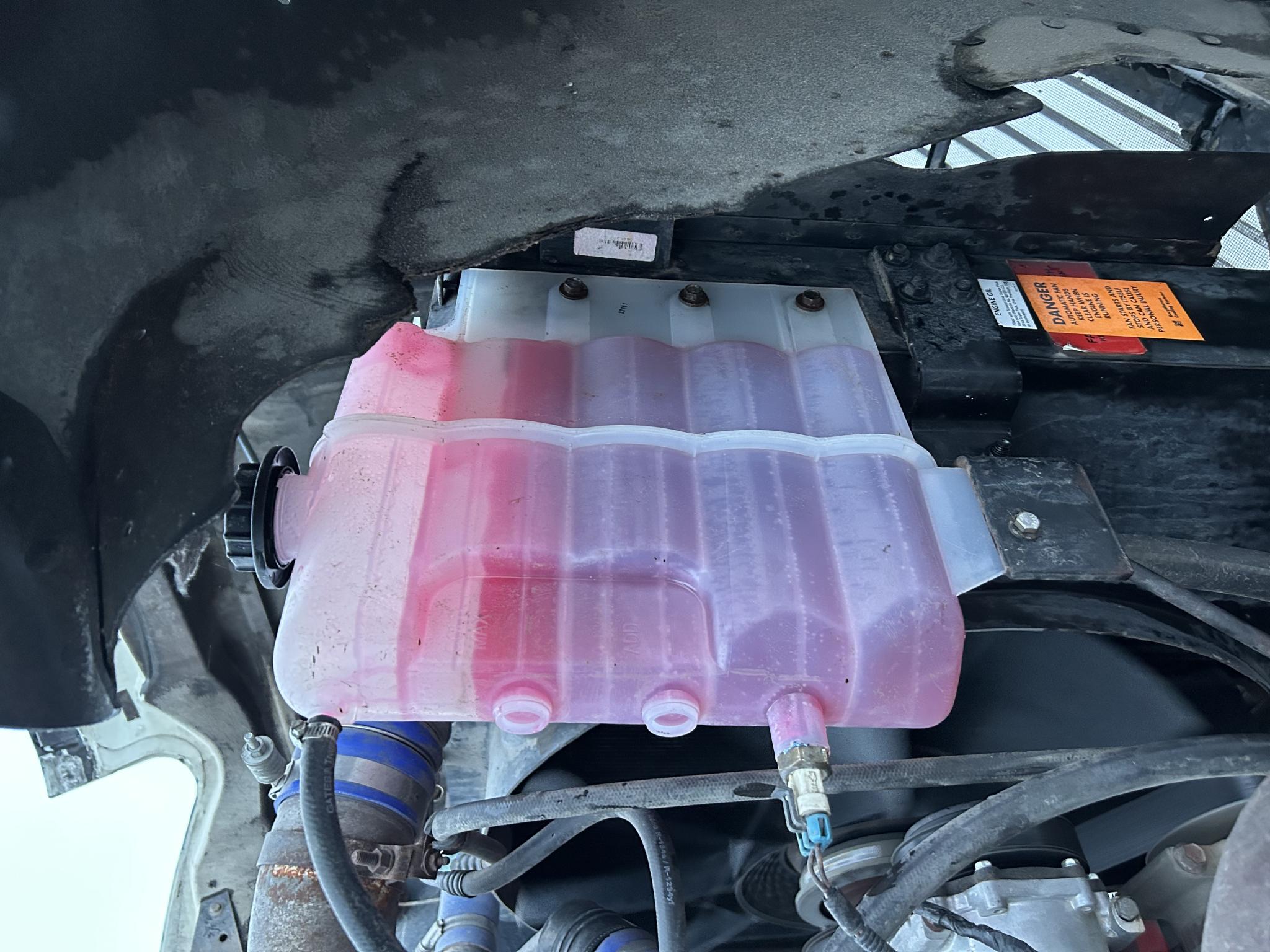

Replaced the coolant reservoir today because it was starting to leak. Once I finished installing it I got the truck up to 182 degrees and it wasn’t puking coolant.Here’s a video of it https://imgur.com/a/YB8voDd
