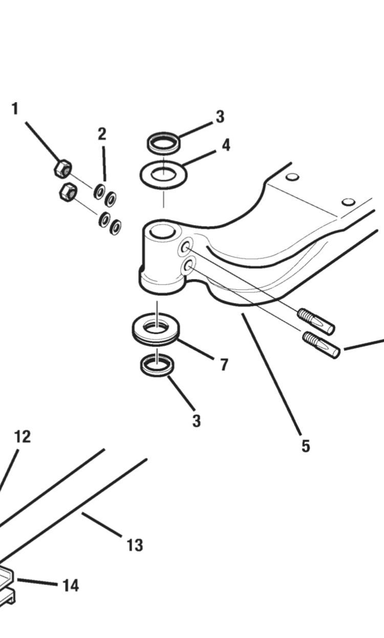

Have you checked the king pin to make sure it’s ok? It looks like the drag link is rubbing the side of the shock as well. I’d jack it up and make sure there’s no side to side as well as up and down movement. Definitely make sure the lower thrust washer isn’t missing (#7 in diagram)
