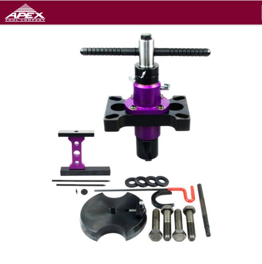

one example... like WHY THE H3ELL did you have to remove the whole engine to have it counter-bored?... that isn't right at all, as there is a tool that can be used right inside the engine bay of the vehicle to do all of that. Most places around here charge about $100 per hole to come to your shop and counter-bore one with this tool if someone does not want to buy one.
ISX/cummins mid-stop counter-bore tool...

I do want a cutting tool of course, Australia has sold out and only 1 company in the states will ship them here, about 8grand our money.
That’s not the problem, it’s more knowing who to trust so far away.
I’ll use the link you gave and try them. Thanks.
