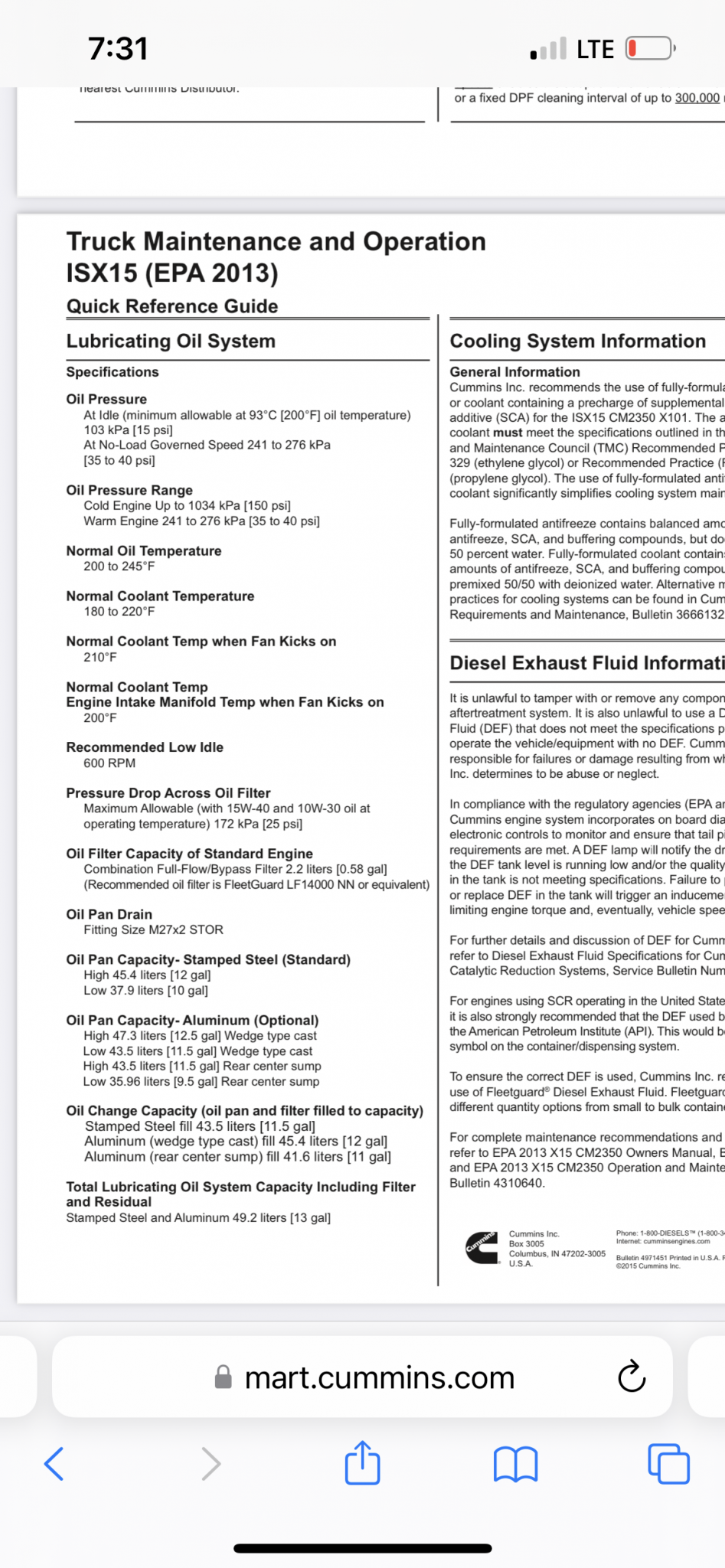

I forgot to mention that has not been deleted yet. I got that information regarding the oil temp from the kenworth booklet that came with the truck as well as online.
Does not matter what the book says.. 245 is the upper extreme and should rarely be seen if at all. Believe me, I see a lot of trucks and know what temps they run.
