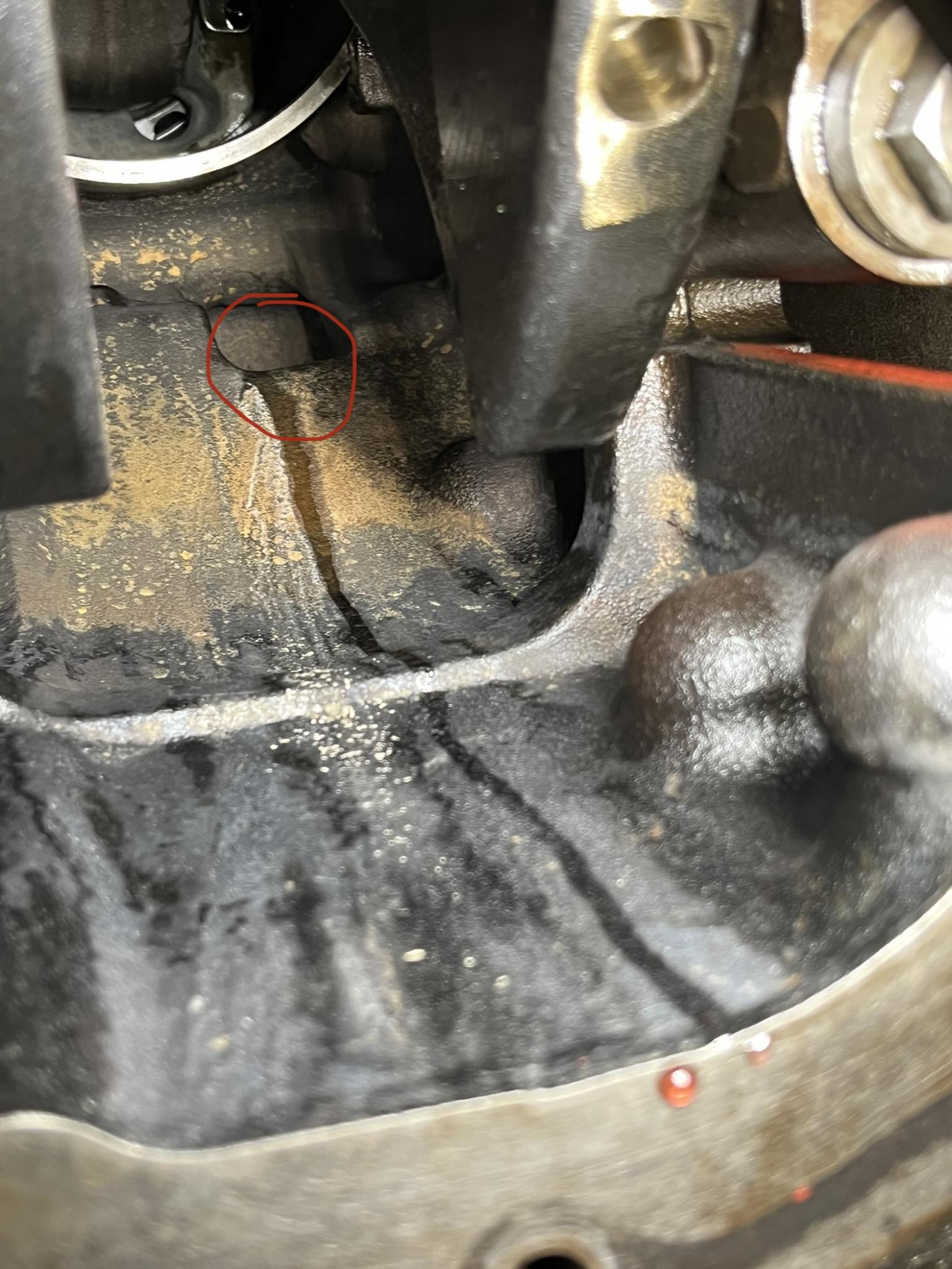

Hi I’ve got 2011 cm871 with about 40k on an out of frame new head and reman block if it matters. I’ve been losing coolant and the the past 2 oil samples show eleveated sodium levels. Been battling this for a while since the out of frame. Oil always looked good no milky or slugging. I dropped oil pan and pressurized the cooling system to 13-14 psi and saw tiny bit of coolant coming out of a galley on the passenger side of the block near the back. I brakeleened and dried out all around cylinder to confirm coolant wasn’t running down the liner and into the galley before it ran down. Couldn’t really see anything with a borescope as far as cracks go. So I drained coolant and pulled the oil cooler off to see if there were any cracks on the block or gaskets for oil cooler. Everything seemed fine. Granted oil cooler was replaced about 10k mi ago. Also truck was de mandated about 3k mi after rebuild. Egr cooler was removed and i replaced it with that water bypass tube to keep coolant flowing to the rear. Vgt is still intact. Any help would be appreciated

Is that the back corner on the LH side of the engine? Looks like the spot where oil drains from the head to the pan. If so, remove the rocker cover and pressurise the coolant. Might have a crack in the top of the head or an issue with a freeze plug.

(06-30-2023 )Signature620 Wrote:  Is that the back corner on the LH side of the engine? Looks like the spot where oil drains from the head to the pan. If so, remove the rocker cover and pressurise the coolant. Might have a crack in the top of the head or an issue with a freeze plug.
I thought the same but according to this print out I got from kw the oil drain back is on the right rear. But I’ll still check to make sure
