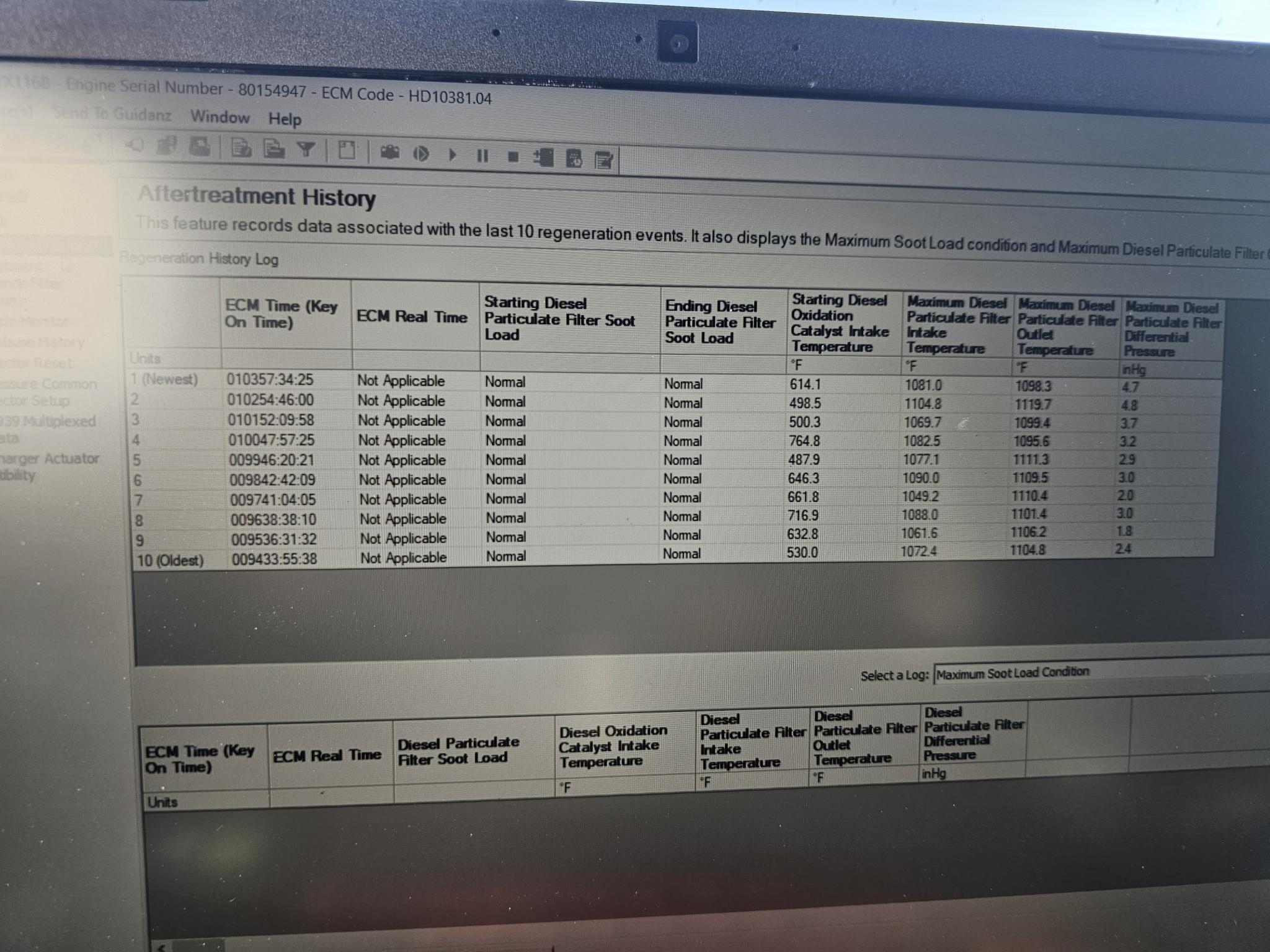

Down 1mpg for the past month, down a gear on hills, coolant temps sitting higher when cruising around 185-190 degrees, hmmm what could this be? Opens up insite this is what I find..
Even with yearly Egr tune-ups and recently removed and cleaned the Egr Valve and new DPF differential pressure sensor. The turbo burn mark has moved closer to center of the housing too.. DPF was baked at 315k miles approximately, now have 520k miles. Definitely got my moneys worth but will update when it gets pulled to determine which route to take...

Yeah, those regen numbers are showing something is definitely wrong. should be averaging below the 3.0 mark.
Make sure that the Doser injector and exhaust piping itself is also in good shape, it often gets overlooked and makes the DPF regen numbers climb like that.

Well, I'm not the expert Rawze is here, but based on the info you presented I'd be less concerned about the DPF/DOC at the moment and more focused on the engine and the exhaust stream. Burning oil, coolant, excess soot or just anything out of the ordinary. Regens seem to be very consistent every 100 hours or so, max temps are all about equal, but max differential pressure has been going up each time. The increased ash load could just be from normal regens, or it could be the result of contaminated exhaust. Baking the DPF should lower the ash level but if there's something in the exhaust causing the problem then you'll just work your way right back to where you are now. I believe Rawze has said that there's only so many times they can be baked before they loose their effectiveness.

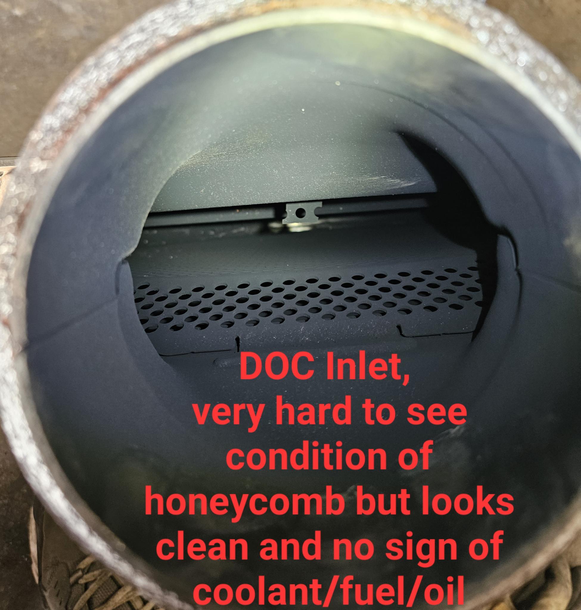

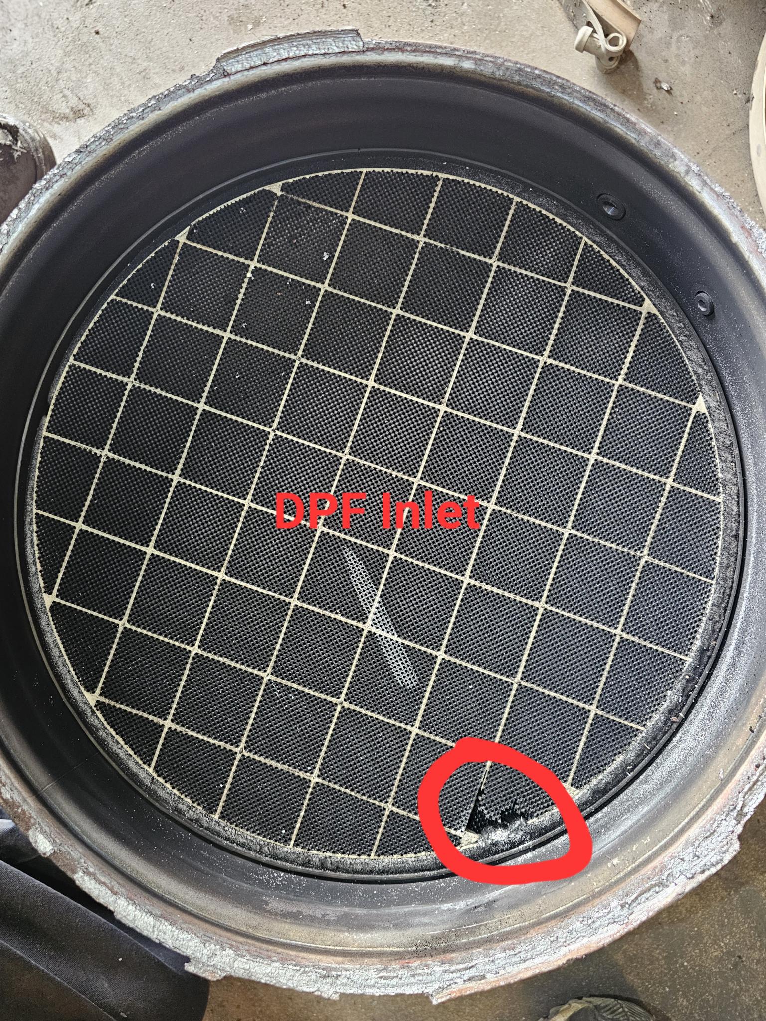

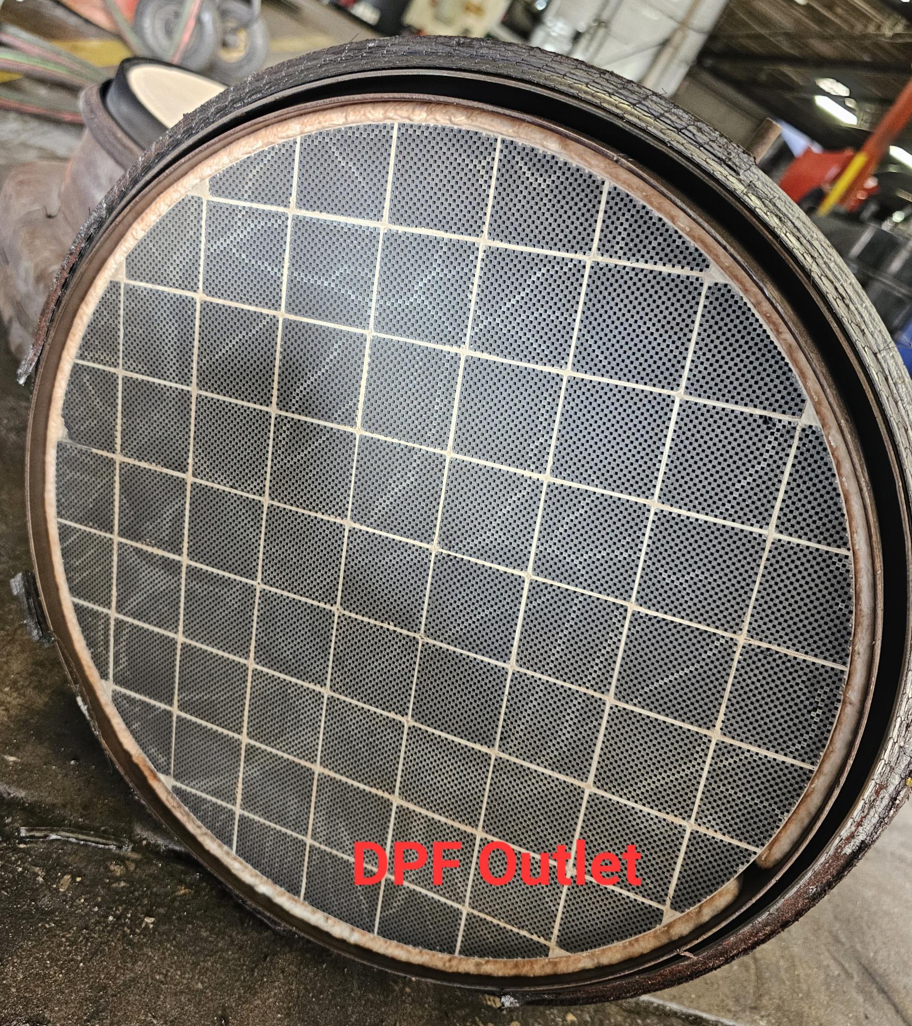

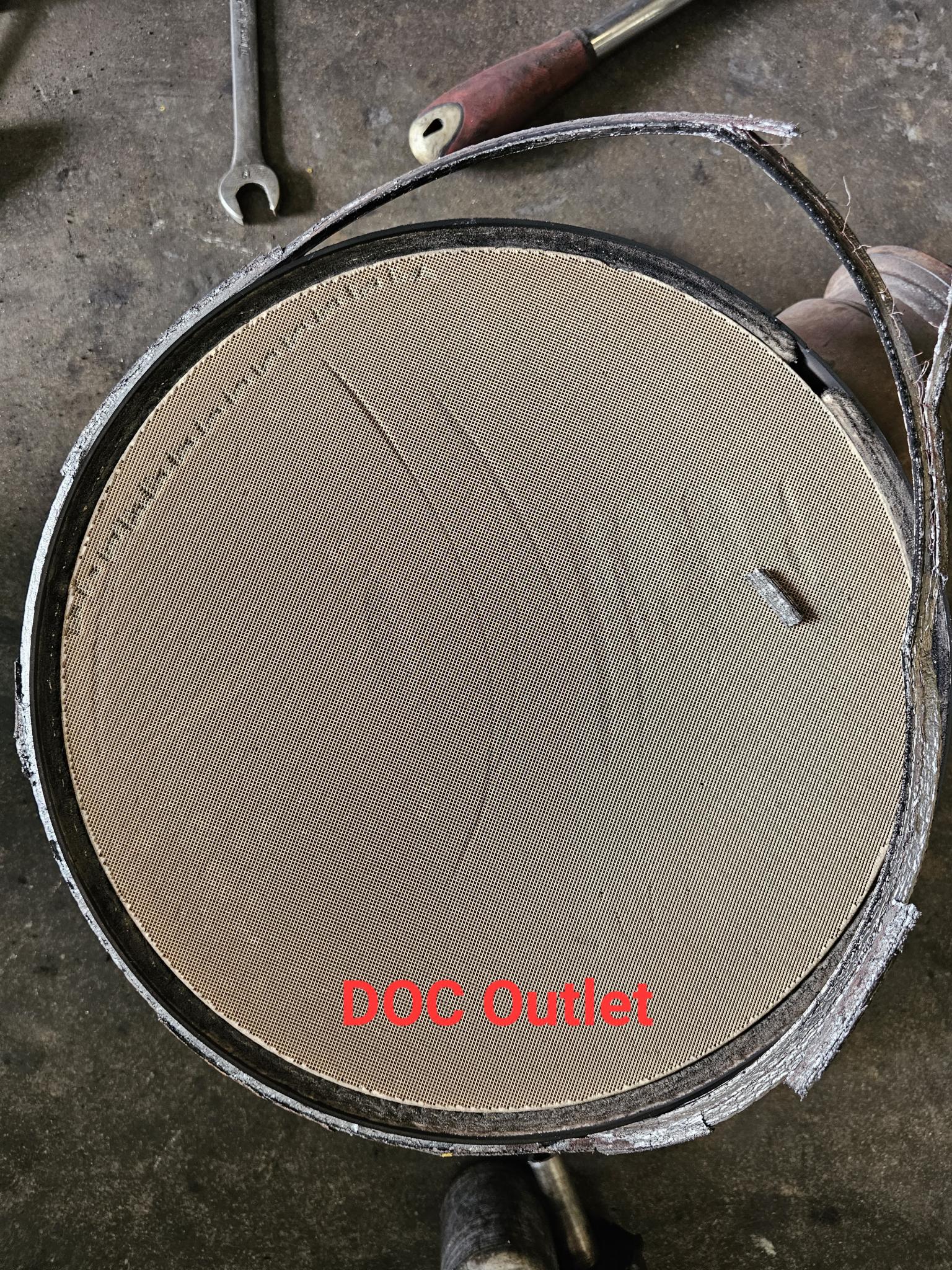

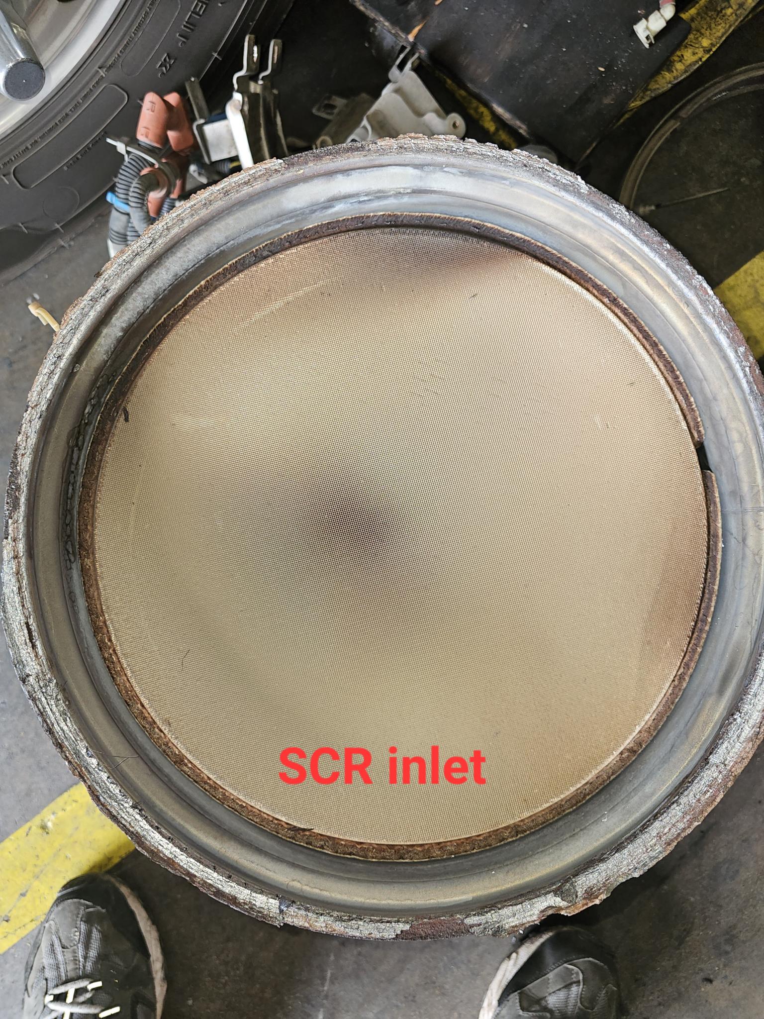

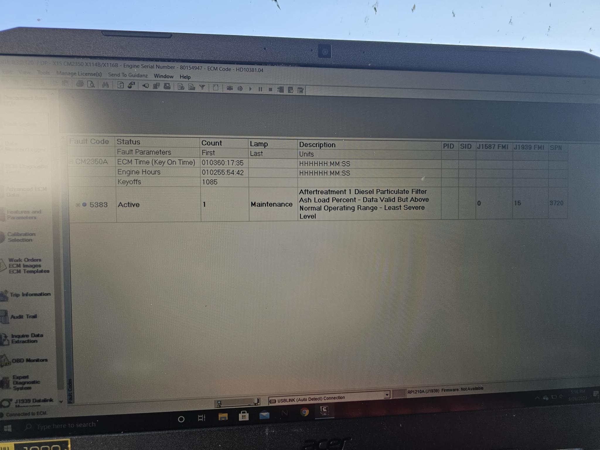

Just an update, so 3500 miles later made it home with the "check" light (Volvo) blinking ever 1-2 hours. Got the cans yanked, DOC cleaned by stealership was an even black across the inlet from what I could see. DPF got cleaned and baked at my local stealership, said it was partially clogged prior to and passes the flow test, also is missing a small piece of honeycomb on the inlet side.
Did a forced regen after maintenance reset and now shows 0.3inhg(Not .03) difference. Also installed a new reman Outlet NOX sensor since the inlet one had failed earlier this year. Along with new cam and crank sensors early on which helped smooth the idle out somewhat prior to the oem damper and pisspoor balancer combo...
This is why having the engine software is so important, stealerships would throw the parts cannon based on assumptions and not look at basic data. This truck threw no fault codes on the dash whatsoever for anything DPF related in the last 200 hours until that maintenance code reared itself despite my symptoms within the last 400 engine hours..

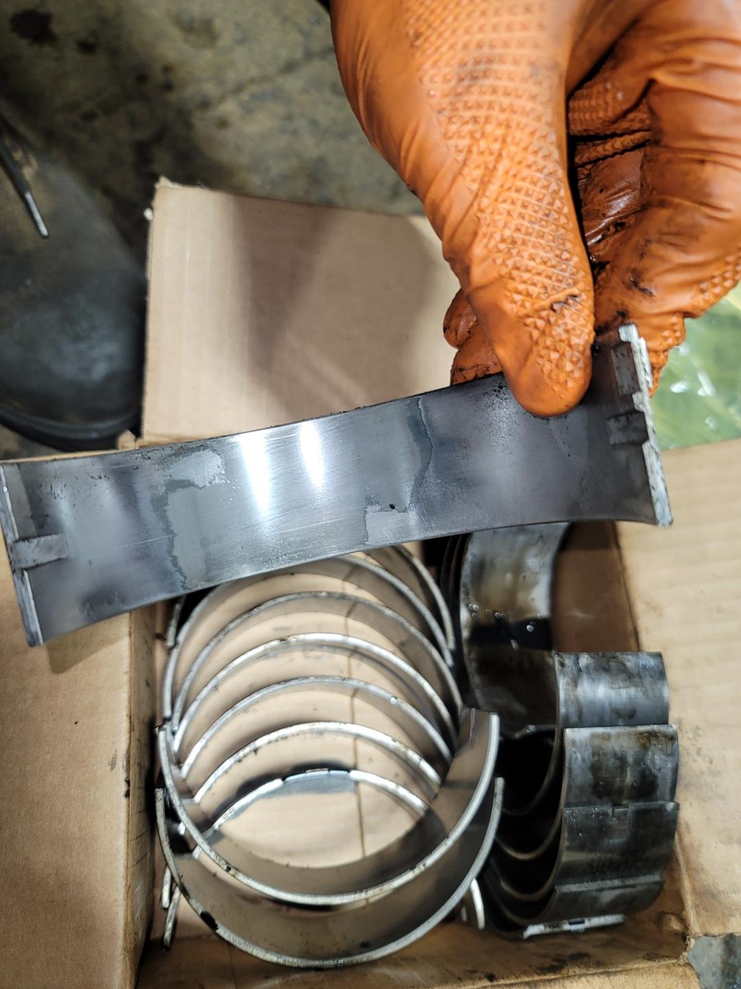

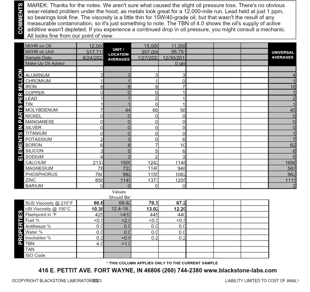

But an issue I didn't mention earlier but I thought I'd pass on, so I had noticed an oil pressure drop-off at lower end of spec at 1500rpm warm. Idle at 700rpm was 26psi warm. Decided to have new rods and mains rolled in and oil pump put in based on a recommendation from a friend with x15 who had done his the previous week at 570k miles mines at 533k miles. Went from low 30's psi at 1500 rpm warm to 40ish psi at 1500rpm warm, big difference! Oil sample pre repair came back clean. Had a picture of the worst main bearing smooth when scraping with fingernail, but rods looked clean all across, but if you're above 500k miles and noticed a pressure drop off that seems to be no apparent reason. Oil pump sounds like a very likely culprit in my situation.
