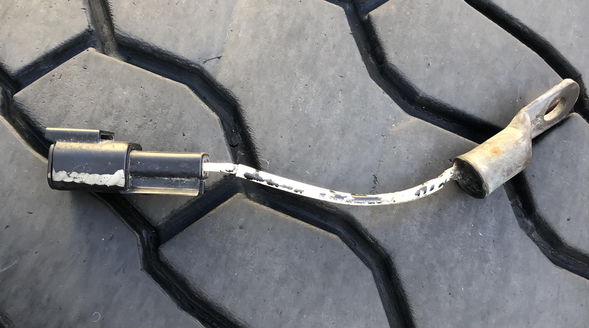

My 2010 386 has two. One in the mirror, and one by the left rear shock along the frame rail. And this is what it looks like.
