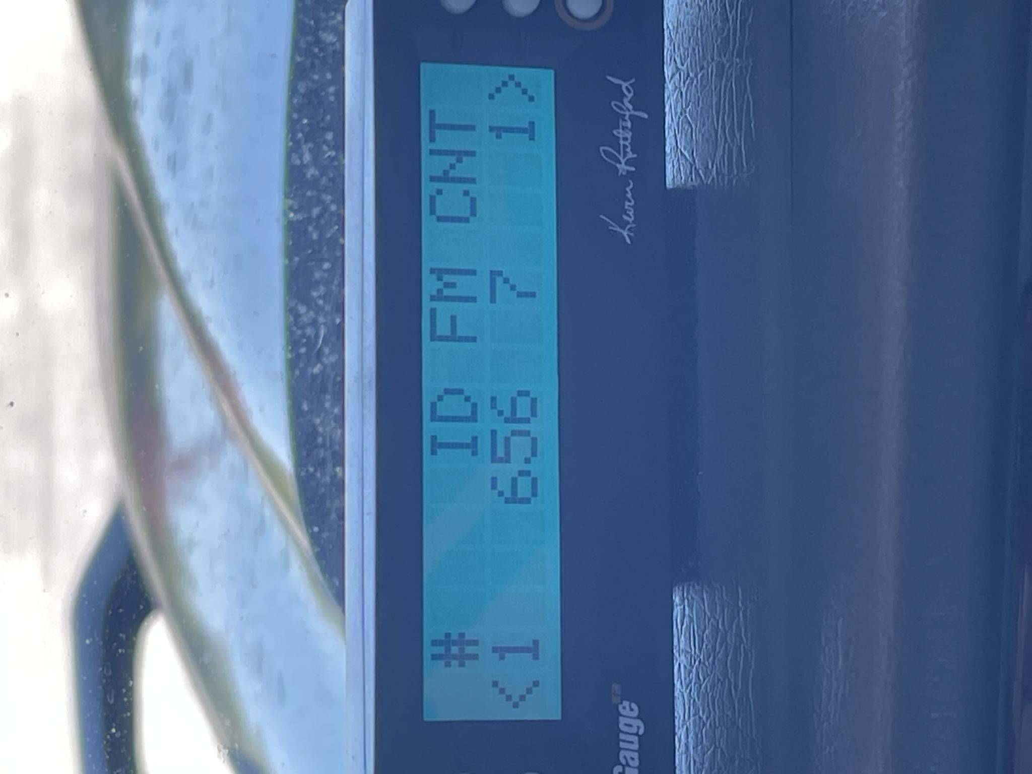

Also come to think of it when I was pulling a hill … lately I do get this code 656 FM-7. I have gotten it 3 times so far and it clears itself but comes back again. Will be preforming a injector test tomorrow at the shop.
10-17-2023, (Subject: Ticking sound from front driver side )
RE: Ticking sound from front driver side
(10-17-2023 )9900Eagle Wrote:  ..… lately I do get this code 656 FM-7. I have gotten it 3 times so far and it clears itself but comes back again. Will be preforming a injector test tomorrow at the shop.
isn't that injector cylinder #6 faults?.
It is. Comes and goes on its own.
