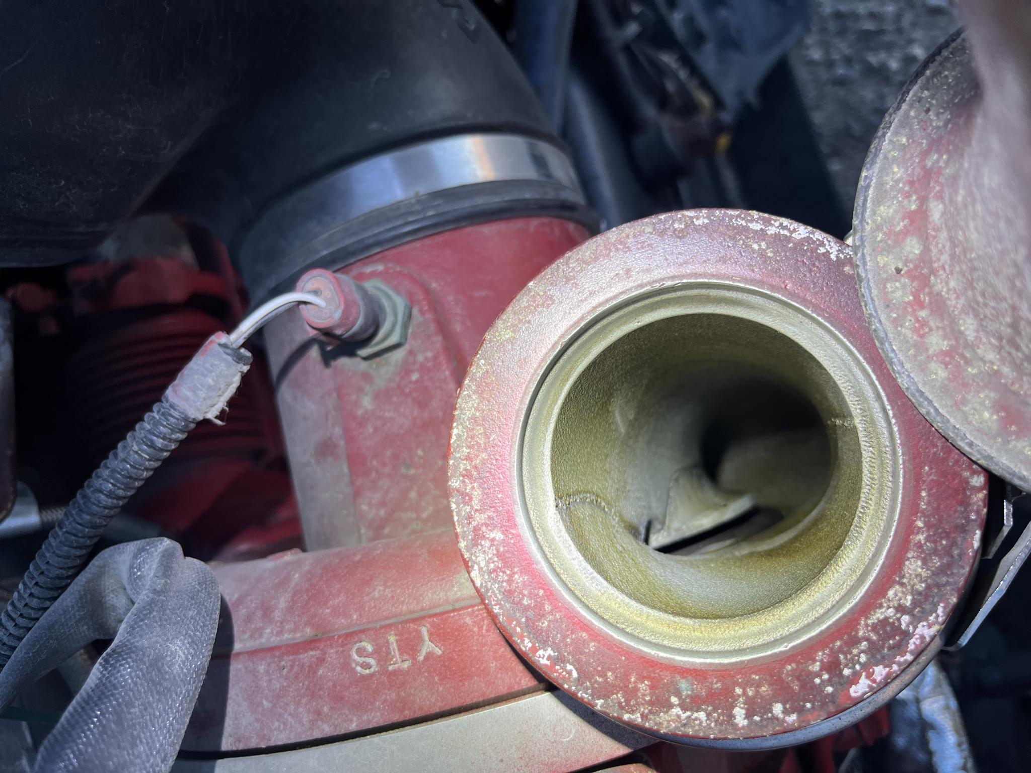

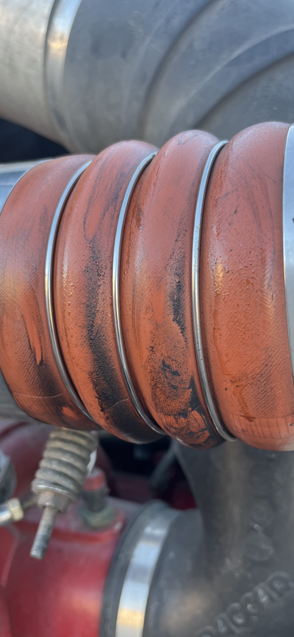

Pulling a lot and windy across NM to Flagstaff and down to Phoenix. Opened the hood and found a little oil seeping through silicone turbo couplers. Opened turbo output and it’s not wet, but you can see a little oil residue. I usually try to keep it around 30 psi, and don’t go below 1500 rpm much.
Turbo is a year old. Checked crankcase filter (lifetime) and it’s fine.
The couplers are not old, but I know silicone can leak. First time I’ve seen this.
Not sure where to go from here.

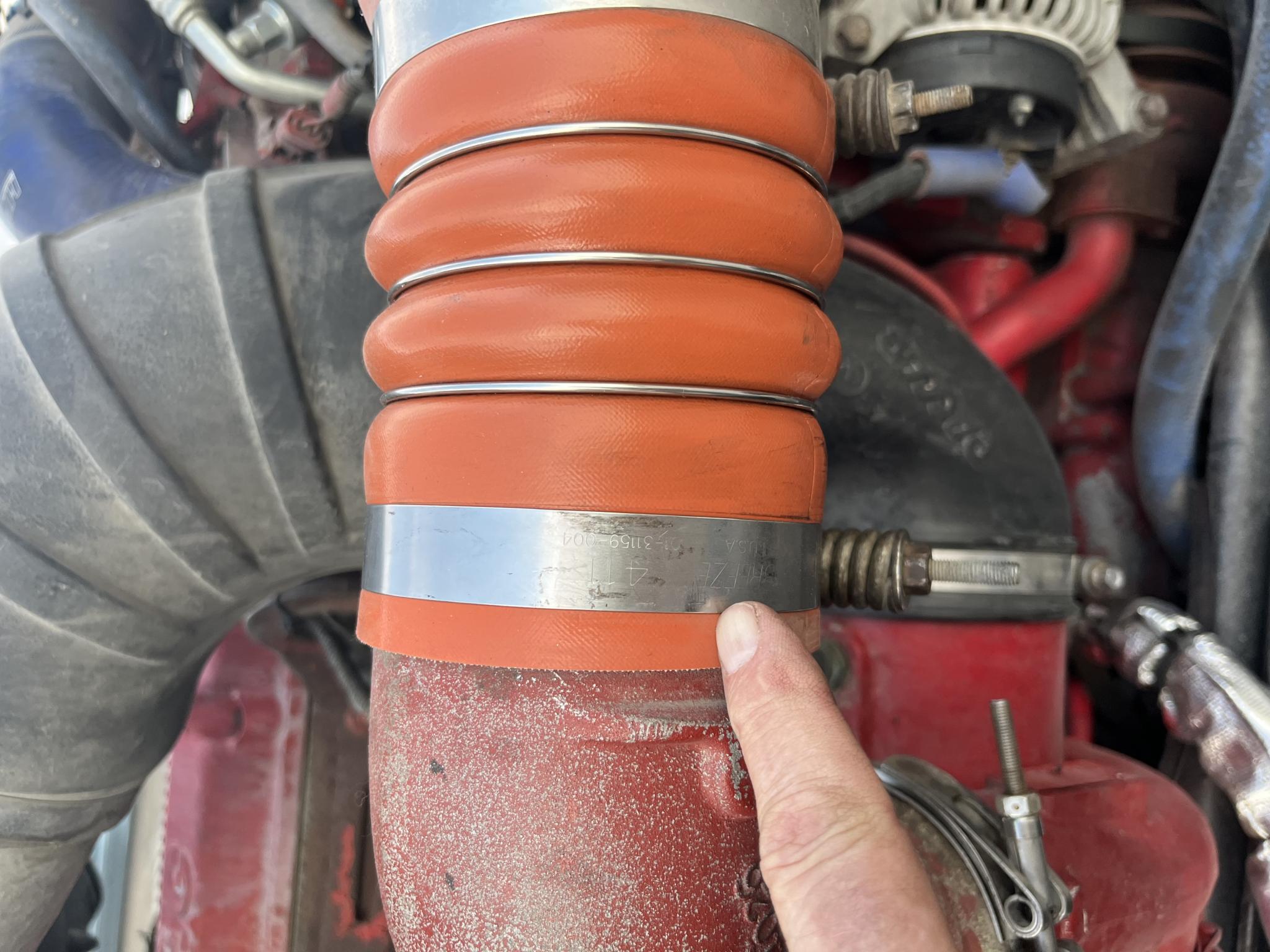

Ok, I drove empty from Phoenix to Kansas City. When I got here the same coupler was moist on the out side. There oily residue in the CAC all the was to the intake.
Could this be from a boost leak I don’t know about. Could it be that coupler, maybe it’s junk and leaking? I sprayed it a coupke days ago, and there were no bubbles. Or is it likely the turbo?
I don’t have a way to test for leaks unless I can find a shop on Saturday.
Opened the oil cap while running and blowby is negligible.
Any ideas??
Also: the first clamp off the turbo may have a tad loose. Would that be enough to cause it to suck oil under a load??

As far as the clamp, I thought it could’ve been momentary under boost, especially at altitude. Doesn’t seem like it’s a constant thing, but it could be a trickle.
