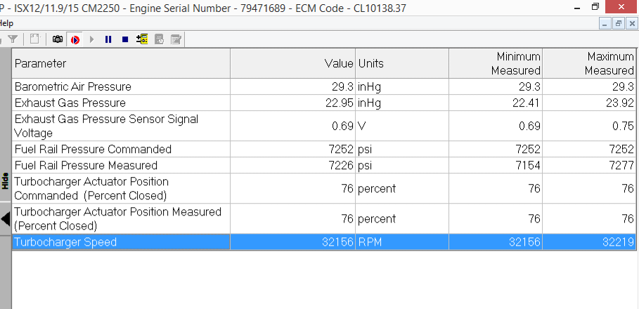

| Isx15 2250 choking  Anyone had this problem? Cranks then slowly dies. Happening 3rd time. After many attempts it fires up, sometimes it takes minutes sometimes it takes hours. Once it gets running no error codes and runs well all day. Don't know from where to start. p.s. CHECK ENGINE - nox sensor is bad. (No other error codes) https://youtu.be/HtSXdWRqU_E?si=0qQEZKG8yqNbwiHC This is data after getting it running   | |||

| RE: Isx15 2250 choking  Your exhaust pressure sensor is reading completely out to lunch, replace it and check tube isn't plugged, should match baro with engine off, where its idling there it should be around 40, unlikely the full story but will have a big impact on how it runs and points towards an unhealthy engine  | |||

| RE: Isx15 2250 choking  Just some speculation... could also be the the turbo locked up at 100% closed, choking the exhaust so badly that it cannot stay running. someone could test this by removing the fitting/pipe clamps and bellows (or at least make a gap) where the manifold makes a u-turn and goes into the egr cooler. Open up the exhaust manifold so that it can breathe ... and see if the relieved pressure from the manifold allows the engine to keep running. User's Signature: ->: What I post is just my own thoughts and Opinions! --- I AM Full Of S__T!. | |||

| RE: Isx15 2250 choking (12-11-2023 )Samvelm83 Wrote:(12-11-2023 )Rawze Wrote: Just some speculation... Not necessarily. I've seen many turbos/VGT Actuators fail in 90+% closed positions before and never trip a light/code. Last one I saw was 100% locked closed and only way we got it to run long enough to get it indoors was to pull the bellows off the manifold to the EGR cooler so it could breathe. Pulled the actuator and the turbo VGT was seized at 93%. If it starts and runs after removing that bellows, pop the VGT actuator off and verify the position of the turbo. Or try to run the VGT Hysterisis test in Instite. | |||

| RE: Isx15 2250 choking (12-11-2023 )NDISX15 Wrote:(12-11-2023 )Samvelm83 Wrote:(12-11-2023 )Rawze Wrote: Just some speculation... Aftert getting it running I did the VGT Hysterisis test and it passed. I believe the primer pump is the problem. When the primer pump fails does it throw any error code? | |||
