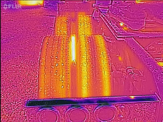

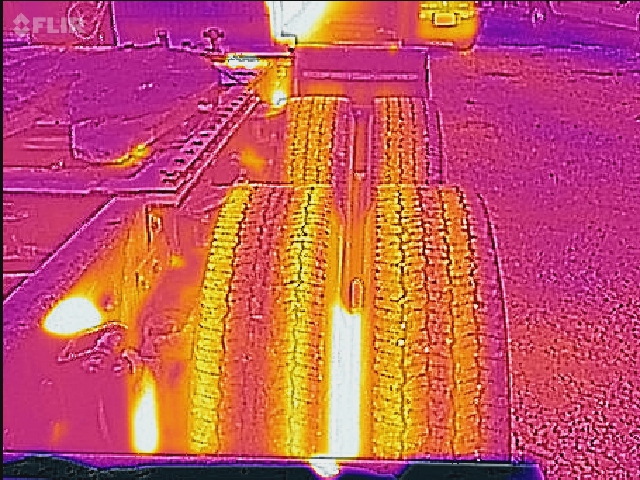

In this Thermal Image after a test drive, you can see the differences in temperature caused by Brakes Out of Adjustment and tire inflation differences.
./uploads/201609/post_2010_1474680446_e653cef78de870673b18695ba4da406f.jpg./uploads/201609/post_2010_1474680622_a52ead5465fe13e00861b9e995a0f6c4.jpg
you can also see the tires are not inflated evenly. Good reason to investin some cat-eye or cross-fires.

Impressive. Some of the D.O.T. scale-houses have the same technology and can see that too.
You can also see his tires are not very well matched, and that they are under and over inflated as well.
