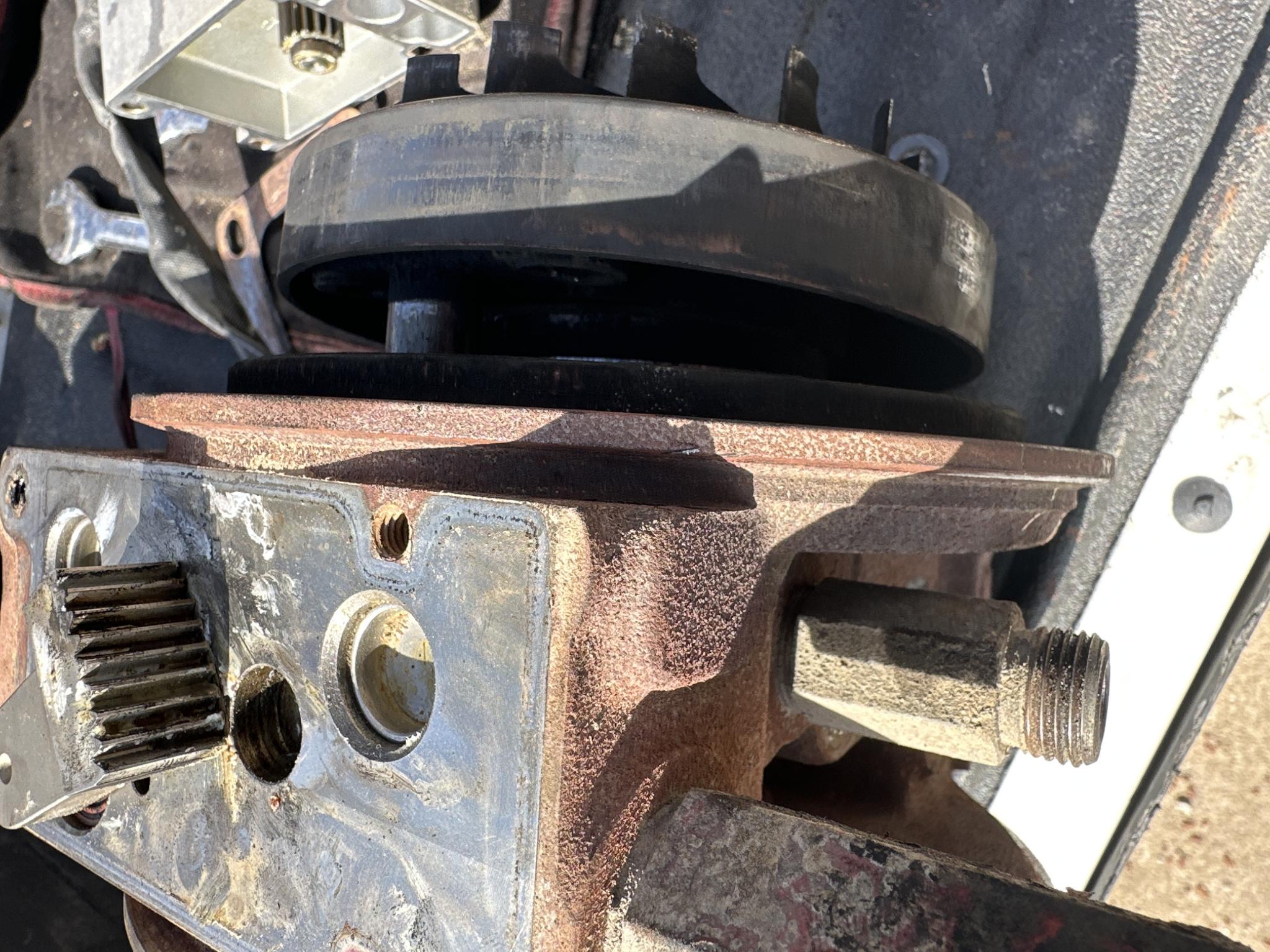

Figured out my bet issue. It broke on one side where it attaches to the arm
02-29-2024, (Subject: 2350 excessive smoke poor mileage and poor performance )
RE: 2350 excessive smoke poor mileage and poor performance
wow that thing looks really worn out and a lot of age on it.
