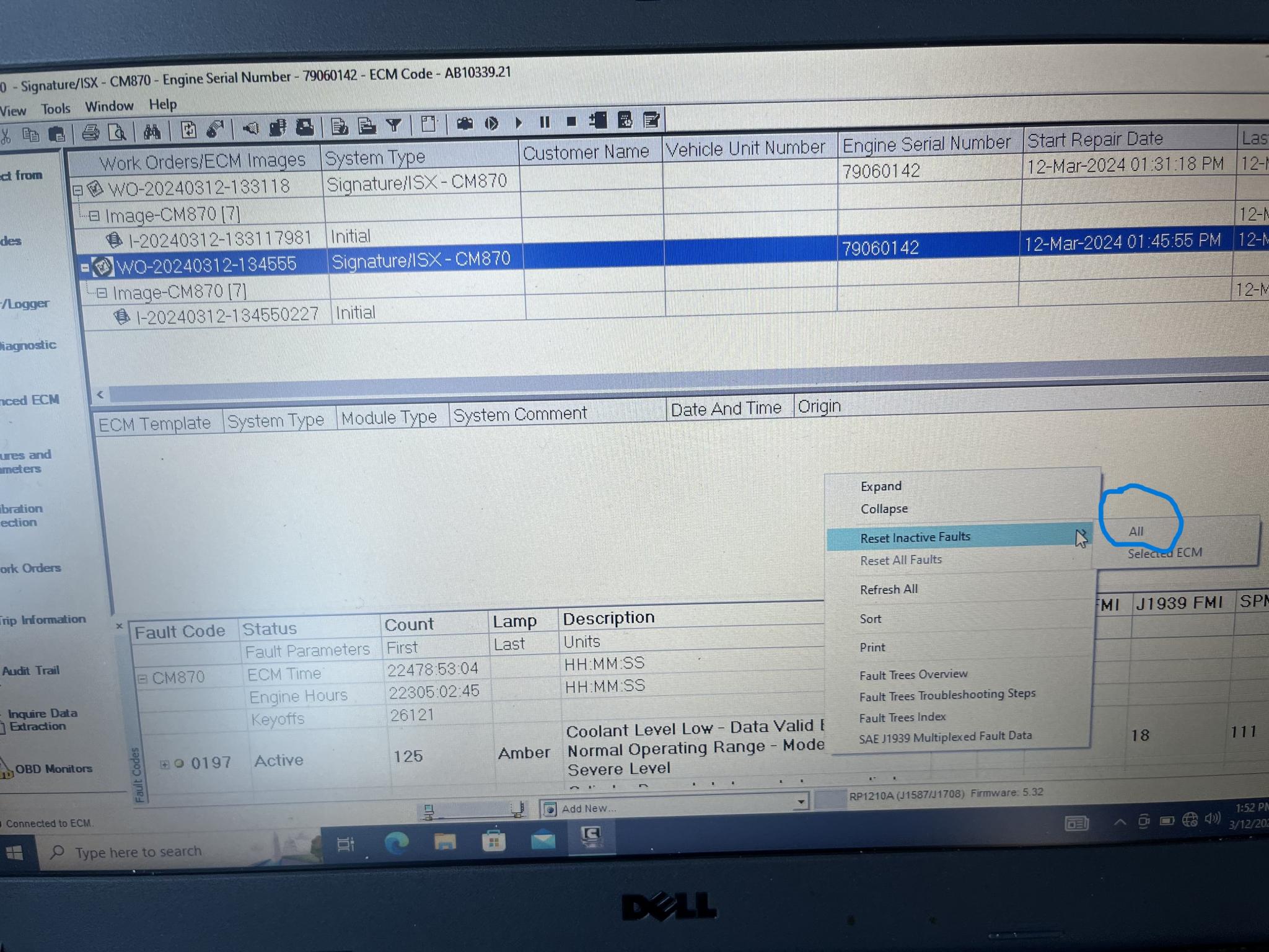

Not getting option to clear code in insite. Part that says select all is blank but should be highlighted. V7.6.2 Thanks. using it with inline 5. engine is 05 CM870

Your trying to reset inactive faults but the fault you have is ACTIVE not INACTIVE.

If the fault is still occurring (it is ACTIVE) .. being low coolant in this case ... it would immediately come back as soon as its cleared.
It would be pointless to try to clear a fault that is still occurring, and the Insite software knows this. Therefore Insite does not allow you to reset it.
