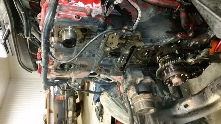

Well today's the day I finally started. I have a bad valve cam and 3 rockers and a real bad front structure leak. While I'm at it, I'm doing rod and mains, shim my oil pump, tranny cooler and lines, put on my am soil bypass and replace my accessory harness for my headlights and washer fluid etc.
here is the gears and structure removed
./uploads/201610/post_1367_1475549746_92285cfa796e02a72e7f9f3c0b5cddb9.jpg

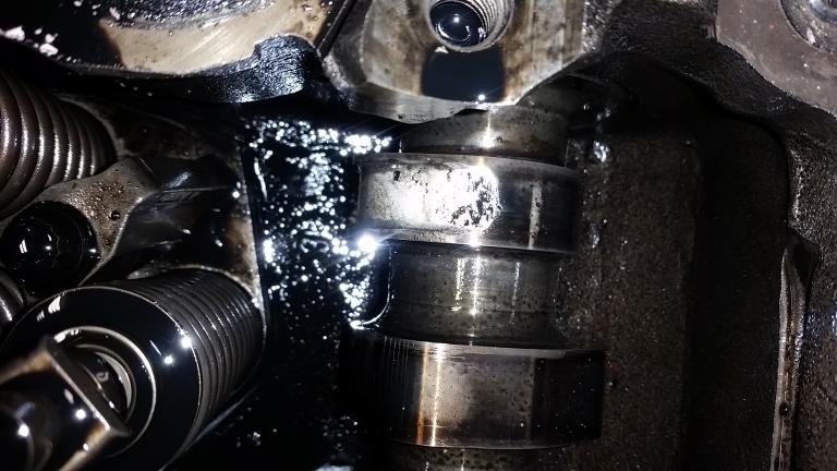

heres my beautiful cam
./uploads/201610/post_1367_1475549814_79c2a355bc4237fb524f0044ff499f7c.jpg

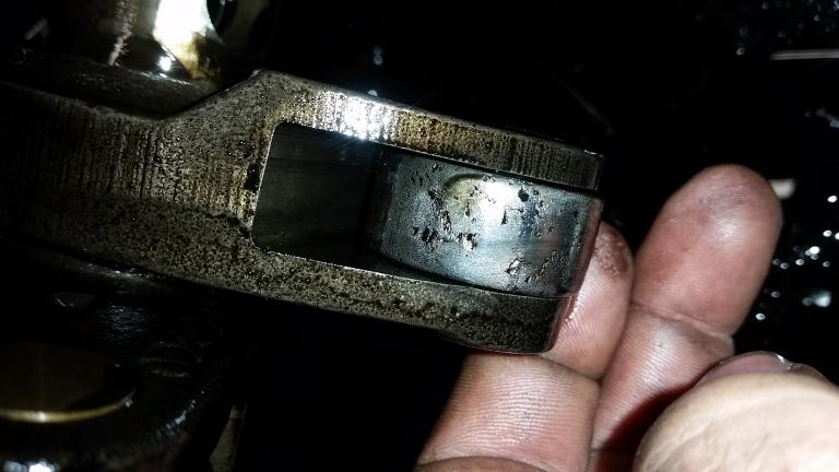

and roller
./uploads/201610/post_1367_1475549983_f4a886b5a258c240dd7261a53d97bdc9.jpg

Mine looked just like that one too.

I hope you covered up the oil rifle and galleries in the front of the block there.

Doe's your injector cam gear still have the old style retainer?
If so, i suggest you replace it with the new upgrade. The old one's are very prone to fail , which can cause catastrophic damage .

Actually, cam damage occur's when the tiny oil galley in the rocker arm shaft, become plugged with soot.
Don't feel bad , my camshaft, and rocker arm roller bearing, looked just like your's

I will not let my oil become black, can't stand to see it.
Looking at those photos, I can tell that thing is soot-packed really badly. You need to clean out all that damn soot from all the passageways and block too. -- It is soot packing and clogged oil passaged in the rollers and cams that did that engine in. What a shame.
Those engines should have come from the factory with a second bypass system on them to remove all the soot,... If everyone did that to their engine when brand new, they would 2x the life out if them.
