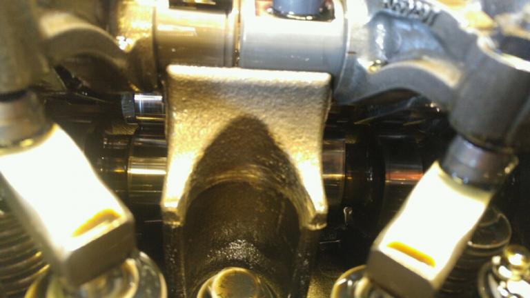

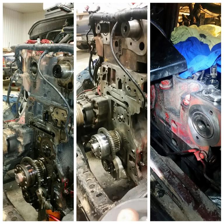

(10-04-2016 )hhow55 Wrote:
(10-04-2016 )Brock Wrote:  For having 1.6 million km, the bottom looks great. Mains are solid and rods aren't showing near the wear I'd expect, even the cam bearings are better than expected considering this things bearings are all original!
Absolutely no sign of coolant down the cylinders.
Only thing that I see... liners are at the end of their life. looking pretty polished up.
I'm suprised at the shape of this thing considering the mandate was just removed. This truck dI'd a lot of idling at 650 with a 5w30 oil this winter. 3 hours minimum a day so I'm wondering if that may have been where my cam damage came from......
Actually, cam damage occur's when the tiny oil galley in the rocker arm shaft, become plugged with soot.
Don't feel bad , my camshaft, and rocker arm roller bearing, looked just like your's
I don't know if it's as simple as that. This 2017 550/1850 engine getting de-mandated - had 50k miles and 1200 hours and was beginning to show cam and roller wear already!

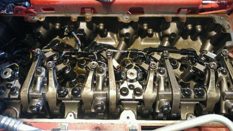

./uploads/201610/post_1367_1475726269_fcd89cf370763a8c1510ac0d246237f6.jpg
getting it all cleaned up. injector cam was good so I just grabbed a used valve cam and 4 used rockers from a cummins cert mechanic shop. Rear cam seals were leaking bad so off came the doghouse... What a pain that was!
This is gonna feel like a brand new truck to me. Vibratech dampner, new motor mounts, good cams with a proper valve set. Now I'll be able to see exactly what @m*m^2 feels like.

(10-06-2016 )Brock Wrote:  getting it all cleaned up. injector cam was good so I just grabbed a used valve cam and 4 used rockers from a cummins cert mechanic shop. Rear cam seals were leaking bad so off came the doghouse... What a pain that was!
Well, while your doing the front end of your engine, I'm planning the back end of mine. My rear structure leak is starting to leave drop marks on the ground now. Think it's gonna be a Christmas/New Years week job...

My hand was forced. unloading down at hardisty and they didn't like the oil leaks on my truck so they booted me off site till I got them fixed.
