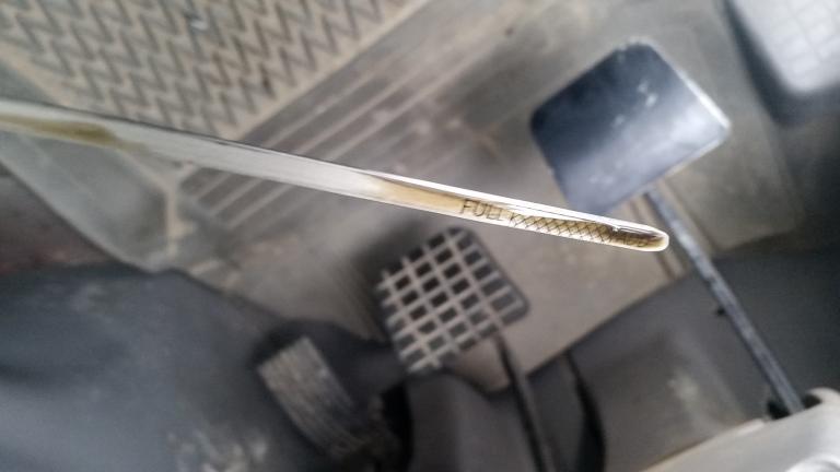

Well I'll be damned.... I've never seen this before! I didn't think it was possible with the weight I haul and the idle time I have but here it is, a few thousand km and still looks pretty good!
./uploads/201610/post_1367_1476556702_d3bdef14836a69cb3c4dbae394a39a5b.jpg
Still need to get my amsoil filter on, ran out of time. Now let's see if I can keep the oil clean???

(10-15-2016 )Brock Wrote:  Well I'll be damned.... I've never seen this before! I didn't think it was possible with the weight I haul and the idle time I have but here it is, a few thousand km and still looks pretty good!
It still looks a tiny bit dark-ish (still a bit of soot in it), but you are finally on the right road towards getting that engine to run good. Now it is just a matter of fine tuning and doing oil changes at proper intervals.
It is likely the extra idle time that is getting it. Bump your turbo up to about 35% in your idle region only (50 mg/stroke and less) if you have to idle a lot, or use a lot of PTO. See if that helps it a bit next go around. I would not go much higher than that though.
