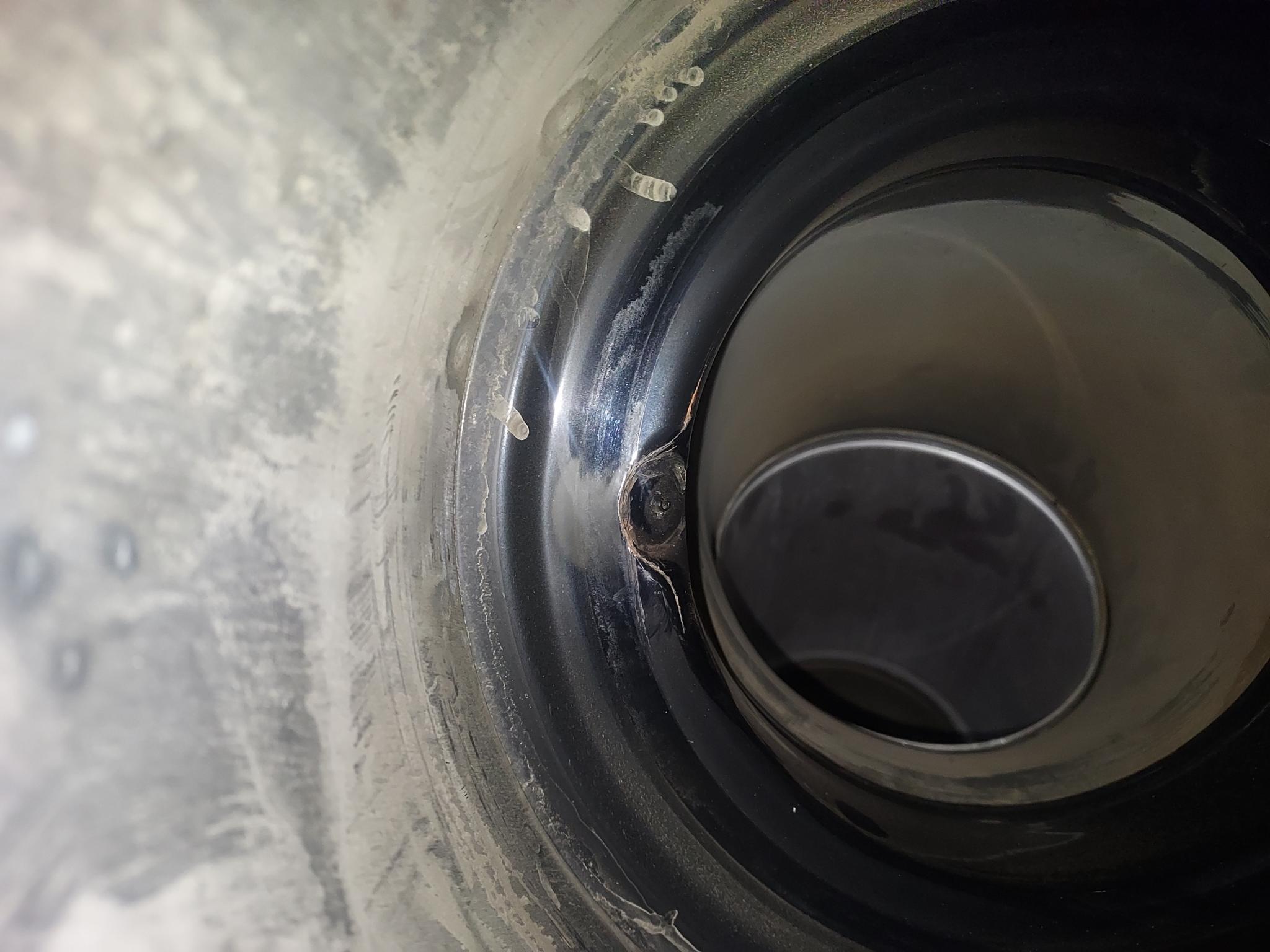

Hello, first post here and I thought it would be good to post something useful.
I was helping a guy service his Western Star with a DD13. This truck has a metal air filter housing mounted under the hood and when I pulled out the air filter, I noticed an odd pattern in the housing. Closer inspection found that the housing was cracked around where the air filter restriction indicator was mounted. What's more is that when I was welding it back up, I went to remove the adapter and the spot weld broke off. Close inspection there showed that the spot weld wasn't even 100% of the way around. So, crack welded, hole filled, inside smoothed out, part removed and life is good.
One other thing that I noticed was that the boot was pushed up pretty tight against the adapters there and I think the clamp was even pushing against it. The whole assembly even with the adapters is still pretty light so I kinda doubt the weight of it caused it to crack, but maybe the boot pushing on it did the job.

Photos

(05-31-2024 )Whitedog Wrote:  Photos
wow, that's a pretty good sized crack.
