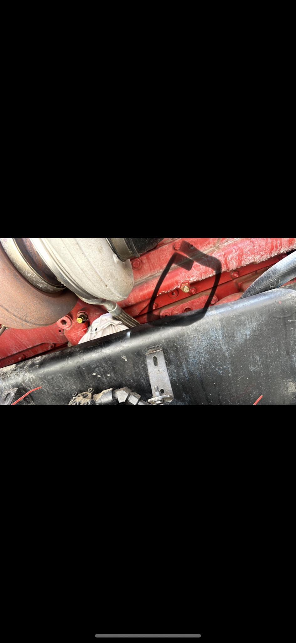

| ISX Oil Pressure Problem Good morning everyone , I have a Cummins 870 I rebuild . I’m a former freightliner tech with Cummins certifications from 2010. I just did a 870 rebuild About 6 months ago… using {non-oem} parts. I torque everything to spec n replace everything from rockers , cams , lower bearing , oil pump , cooler n etc. Customer complain the unit oil pressure would Drop sometimes from 45-47 to about 25-22 while driving for about 3-4 secs n spike back up.. I personally drive it n it does that . and sometimes does it when u release the throttle pedal .. I match this issue with a mechanical gauge as well I had plum in by the Oil Presssure inlet at the oil cooler , the fitting before the Oil filter … it did the same … Would suspect it to be a oil Pump problem? I drain the oil and drip the pan and inspected the pick up tube and the o ring and it was good.. Didt had no metal or heat marks at any of the mains or rods | |||

RE: ISX Oil Pressure Problem (07-15-2024 )marek4792 Wrote: Aftermarket parts to rebuild an engine is strongly discouraged just for this reason.. Definitely would suspect the oil pump especially if it's aftermarket too, check the lash and shim the new one.. Also put OEM rods and mains in it so atleast the guy can make enough to rebuild it again with OEM parts when it eventually fails.. Thank you.. I really don’t like using it but that’s what they provided. I check oil pressure at the oil cooler before the oil filter and after n still the same .. I went on a road test with the gauge at the fitting before the oil filter n it still had the pressure drop some times . So I suspected a oil pump due to where I check the pressure at | |||

| RE: ISX Oil Pressure Problem I check the pressure here road test… when I start the unit cold on the gauge I would read 45 psi at e and about 50-54 when I rev it .. when it gets hot it’s goes down to 20-25 at idle and 40-45 while full rev.. | |||
