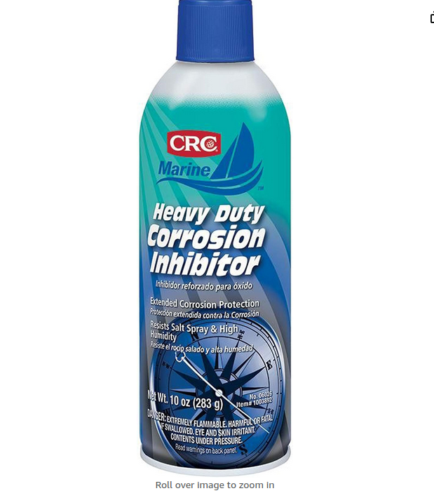

What is the sealant you used on the bottom end of your upper gear cover?
12-04-2024, (Subject: Oil and Excess Pressure in fuel )
Post: #23
RE: Oil and Excess Pressure in fuel
(12-04-2024 )HAULNTX Wrote:  What is the sealant you used on the bottom end of your upper gear cover?
In my CM871 video #50 of the rebuild series? ... It was just a bit of thick anti-seize paste.
I however prefer some marine spray (dries like wax) on the fittings and hoses, and places like that to keep things from getting leaky in the future.
CRC 06026 Heavy Duty Corrosion Inhibitor
https://amzn.to/3CWkQMN
./uploads/202412/post_2_1733333718_98a4857bdb48dbf1cf134444be157ff7.png
