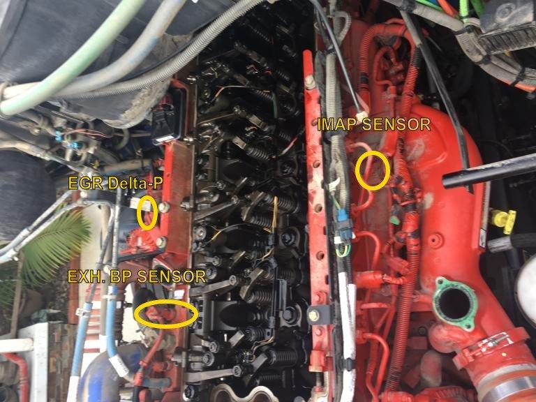

 RE: 2012 Isx 15 rattle noise top driver side  (02-29-2016 )Broncof15079 Wrote: I have a 2012 T700 with cummins Isx15 450hp 488,000miles, 1 month ago it started to rattle. No engine codes When the truck starts to pull a grade it will start a rattle really loud it sounds like its on top of engine, and only around 1400 to 1600rpm , if I let off on pedal it goes away, when I get back on the pedal rattle comes back ( sound is like bearings or valves coming apart). So far mechanic done dpf and doc filter clean and burn, overhead adjustment and has not been able to solve problem.. Dude! - You are in some serious need of AN EGR TUNE-UP! -- How did you even make it this far? I bet your IMAP sensor looks like a burnt piece of charcoal by now! - You need to replace IMAP, Delta-P, Exhaust BP sensor, DPF Delte-P, and a few others!. - And if it has been more than 150k miles since these, you neet to... --- Clean the passages under the EGR Delta-P sensior (while your replacing the sensor). --- Clean or replace your Doser Injectior. --- Clean out the sensor tubes at the DPF can. --- Clean and verify the SCR Doser is working properly --- Replace the SCR Doser Filter. --- Replace the Coolant Filter for the engine. I can keep going. Do you see my point here? - If you are neglecting your engine, how can you expect it not to eventually come apart. ![]() - - - You should hope that the rattle is not your high pressure fuel pump! - It will take out the whole engine with it when it goes! Do an Injector leakdown test and see what the pump sounds like as it builds pressure... http://rawze.com/forums/showthread.php?t...3#pid75483 FOr those who read this and think to themselves: "It can't be that bad" -- Denial and neglect is a powerful thing. You shake your head, and say it, -- That is, until your on the side of the road yet again, or in that shop for repeating emissions system failures yet again, while they hose you. That shwwoshing sound is your money going out the window. -- Don't run around blind because your subconscious it telling you to be lazy. If your someone who has that many miles on your CM2250 or CM2350 engine and you haven't been doing those things regularity, I feel bad for your engine. You are also making OEM repair shops very happy to collect your paycheck.  |  |||

|  RE: 2012 Isx 15 rattle noise top driver side    Thanks, I will check sensors, scr doser....     |  |||
