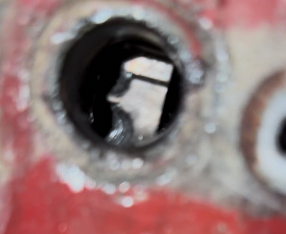

2009 prostar isx crankshaft sensor issue 2009 prostar isx 450hp Thanks for letting me join first of all.. I was having issues with my truck losing power randomly. Had a code for cam sensor so swapped it out. Truck ran smooth for half the day. Then had bad random loss of power with the rpm’s fluctuating from normal to dropping really low. Had a crankshaft sensor code. I tried to remove the sensor but it broke trying to take it off. I took it to a mechanic and they drilled the sensor out and replaced it. I’m just finding out they drilled thru some of the teeth on the tone ring. Now I’m having the same issue. I swapped out ecm and engine harness not knowing that they had drilled thru the tone ring. They state it isn’t an issue, but I’m thinking this is the problem on why the truck continues to read that error and act the same. Does that sound right? I apologize if I sound foolish, just need to get this truck running it’s been down a month. | |||

RE: 2009 prostar isx crankshaft sensor issue (01-01-2025 )DVT873 Wrote: Not an issue!?!! If the tone ring is missing teeth it will sure as hell cause problems. If there was rust or corrosion under the sensor tab and they didn't clean it up that will cause problems also. Like rust-jacking on brake shoes it pushes up on the sensor forcing the tip of the sensor away from the tone ring. On mid-range Nav engines, the maximum clearance is .070. Beyond that, the signal starts going to hell, to the point it won't start. I don't know what it is for Cummins but I would expect it to be a similar clearance. It’s definitely drilled thru, looks like teeth were drilled thru on the corners and the edges were chipped off. Gonna have to look into swapping the tone ring. | |||

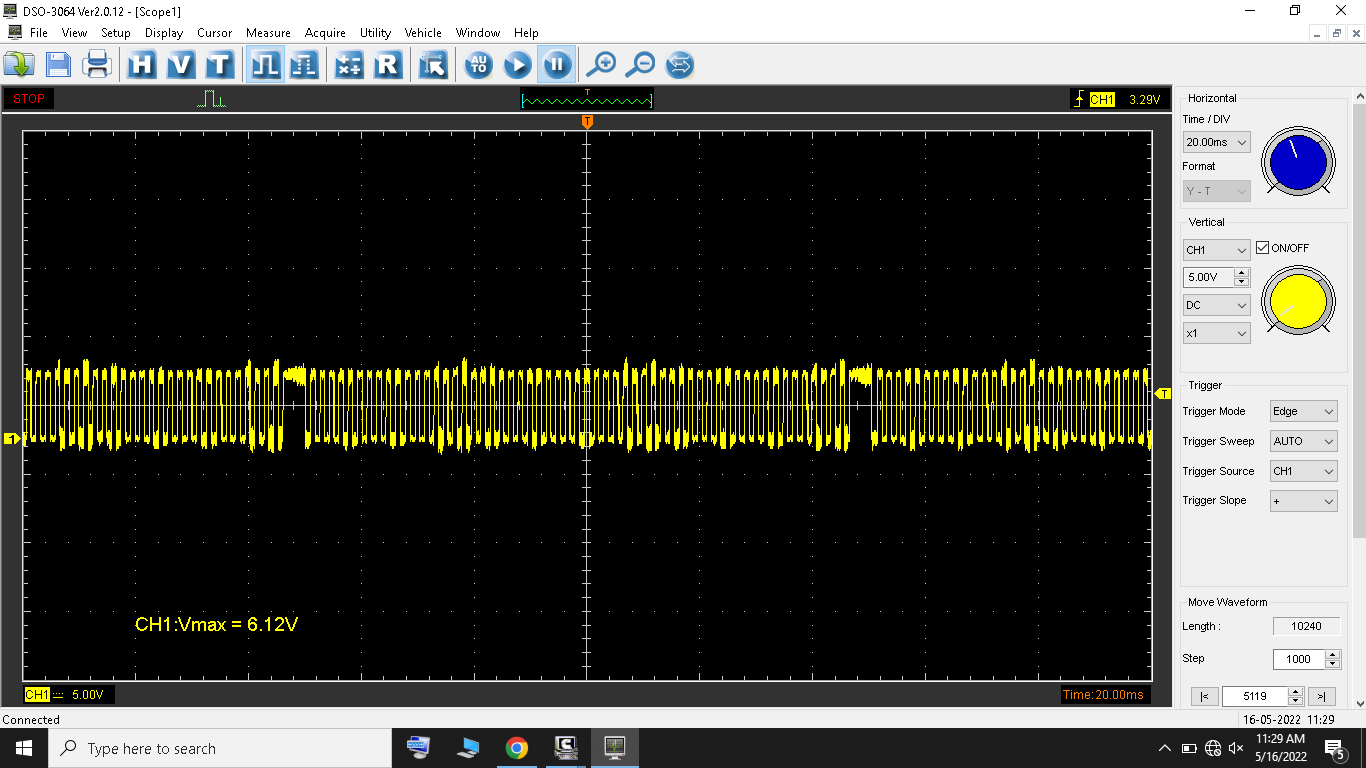

RE: 2009 prostar isx crankshaft sensor issue Until you replace the damaged tone ring you won't be able to troubleshoot this properly, even though the issue is **almost** guaranteed to stem from the crankshaft tone wheel at this point. The reason being, the ECM references crankshaft position (aka where #1 piston top dead center is/was/going to be) based on a number of teeth on the tone ring as it passes the sensor. If you just have a bunch of teeth on the wheel then you will never know if the piston is up or down, just that it's moving. So to reference position of the crankshaft/piston, the engine makers leave a tooth off the wheel and the computer is able to count the teeth in between this "blank space". So if someone gives the tone wheel a new "blank" space then the ECM has no way to know if this space is supposed to be there or not, or if the piston is actually up, down, or where it is for calculation of engine speed, cylinder identification, etc. Looking through my waveform library I found an old reference pattern screenshot from a CM871 BAC that I screenshot and saved for a know good reference. This is just a line pattern of voltage of a crankshaft position sensor output with an engine running at idle. There are 2 wider spaces in this waveform indicating the "missing tooth" space on the tone wheel. If you were to count the "mountain peaks" between the 2 wide spaces they would equal the number of teeth that are on a crankshaft tone wheel. If you were to knock another tooth off, the ECM wouldn't know any different and would think that the blank space was the factory reference missing tooth and not the one drilled off, throwing off all sorts of injection timing events. Replace the tone wheel and report back. | |||

RE: 2009 prostar isx crankshaft sensor issue My truck has been at a shop for 5 weeks now. A different shop, not the one that drilled the crank sensor out. After replacing the ecm, and engine harness the issue is gone. The truck runs normal as far as the motor goes. It runs smooth without erratic rpm changes. I’m now having a different issue I will make another post for. I know for a fact the tone ring is damaged, I saw where it got drilled thru. Teeth are still there, just damaged or chipped at one corner. But truck seems to be running good now. | |||
