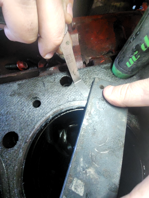

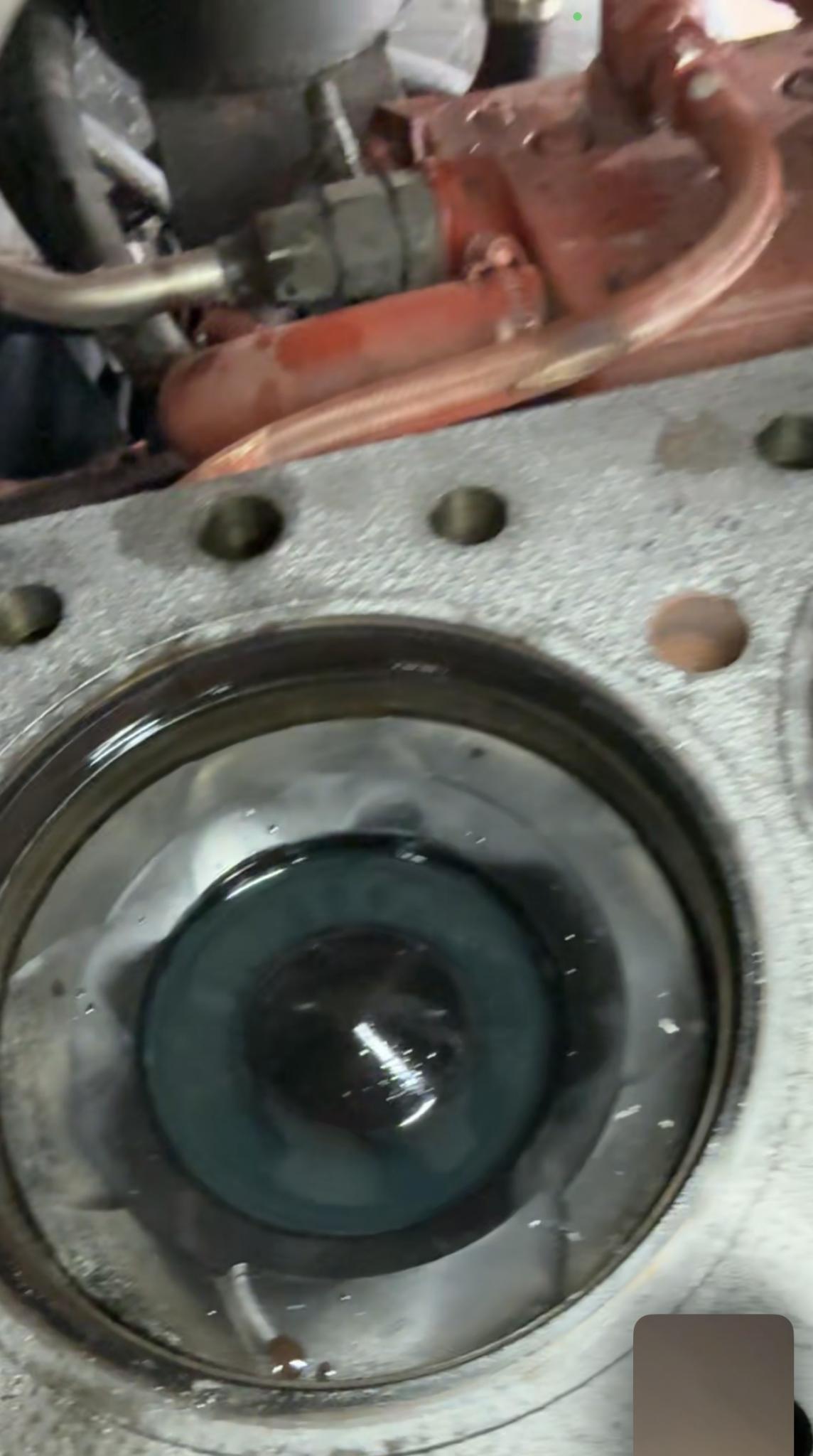

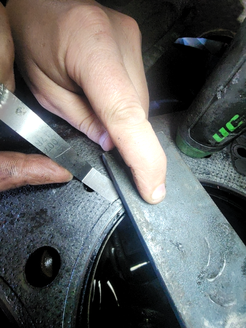

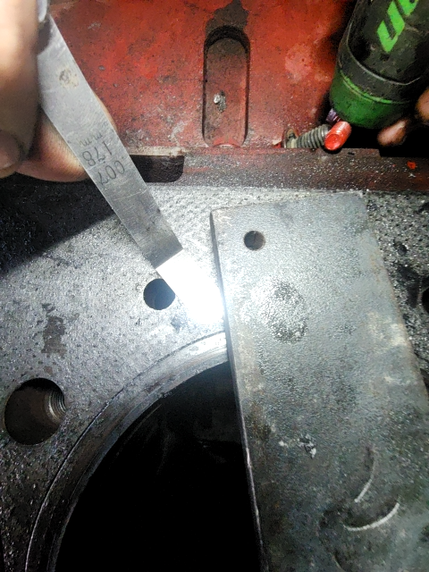

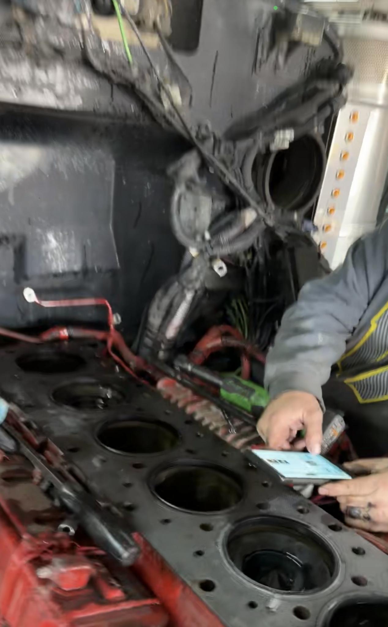

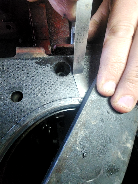

| Hey guys looking for some insite here. Have a 600/2050 cm2350 reman that was dropped in 440k miles ago. I recently demandated the truck bout 6 months ago. Last week it started pushing coolant out the reservoir. Combustion was found in the reservoir. Up until today I suspected I possibly had one of those bad tunes. Head came off today and there’s really no signs of it running hot. It appears cylinders 3-6 may have sunk the liners I’m still waiting to hear back on the measurements but he said his nail won’t even catch on those as opposed to cylinders 1-2. Curious what you guys think bout how the pistons/cylinders look. I’m in the process of getting the tune pulled off the truck so it can be analyzed. Also would like to hear your thoughts on possibly going to ss shims vs brass. I’ve heard mixed reviews and would like to get y’all’s opinion. | |||

| RE: 2350 Pushing Coolant bad programming will certainly make the liners distort and dance in the block.. taking out the head gasket. This before adding any power at all. copy the program from the ecm and e-mail it over to me for a proper review of what someone did in there. as far as the inframe goes.. if you want to do it 100% right.. this is what needs to happen... ref: http://rawze.com/forums/showthread.php?t...6#pid70606 ... anything less and it will not stay together. User's Signature: ->: What I post is just my own thoughts and Opinions! --- I AM Full Of S__T!. | |||

RE: 2350 Pushing Coolant (01-08-2025 )Rawze Wrote:(01-08-2025 )Bigballercarhauler Wrote:(01-08-2025 )Rawze Wrote: bad programming will certainly make the liners distort and dance in the block.. taking out the head gasket. This before adding any power at all. Exactly what I told them when I dropped it off. I’ll have measurements before the head goes on to verify. Be curious to see if the brass shims are actually crushed when the liners come out or if Cummins built it this way. I know I’ve a read posts on here where Mr Hag pulled a new long block apart prior to install and it was no where near right | |||
| 01-09-2025, (Subject: 2350 Pushing Coolant ) Post: #8 | |||
RE: 2350 Pushing Coolant (01-09-2025 )Bigballercarhauler Wrote: ... brass shims have about 0.001" crush after head install ... pretty consistently. User's Signature: ->: What I post is just my own thoughts and Opinions! --- I AM Full Of S__T!. | |||
| 01-09-2025, (Subject: 2350 Pushing Coolant ) Post: #9 | |||
RE: 2350 Pushing Coolant (01-09-2025 )Rawze Wrote:(01-09-2025 )Bigballercarhauler Wrote: ... They checked heights with .007 on 3-6 all of which barely or wouldn’t get under with the feeler gauge. They def sunk on all those cylinders | |||
