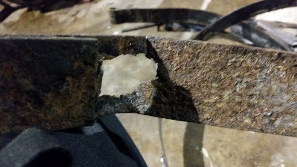

I caught mine just in time while replacing my clutch recently. Here is what my fuel tank straps looked like at the very bottom near the joints. All of them were like this, right at the very bottom only. The rest of the strap on each looked deceivingly good and were not rusty.
[attachment=2652]
Same here, I've replaced all my straps because I had 2 snap on me.
