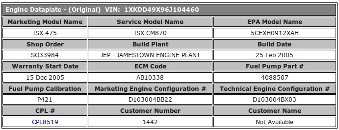

(02-15-2018 )808allstarr Wrote: [ -> ]79095065/cpl 8519 is original data plate info. Have to chk on new info. Can u tell me based on orignal info what cal# should be for hp if it was tuned to its highest. Cummins said it was turnt up to 550hp. If thats wrong what should it be at?
You should register the engine on quickserv.com so that you can get the info yourself. It is free...
[attachment=3585]
It is supposed to have the program (calibration) AB10338.xx in it according to the data-plate. The #4 and #6 wedge should have been used to time the engine when the cams were installed.
The AB10338 program is 475HP/1650trq. No Smart-torque.
there are several 550HP programs for the CPL8519 spec engine. HOWEVER!!! -- At 550HP, YOURS IN PARTICULAR is only 100% compatible to THESE 2 factory program(s)...
